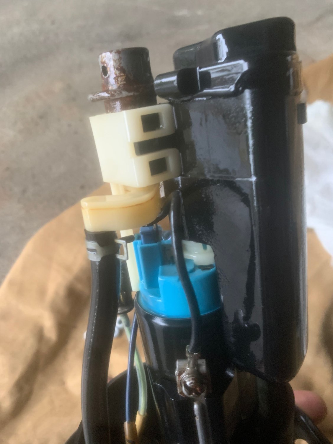

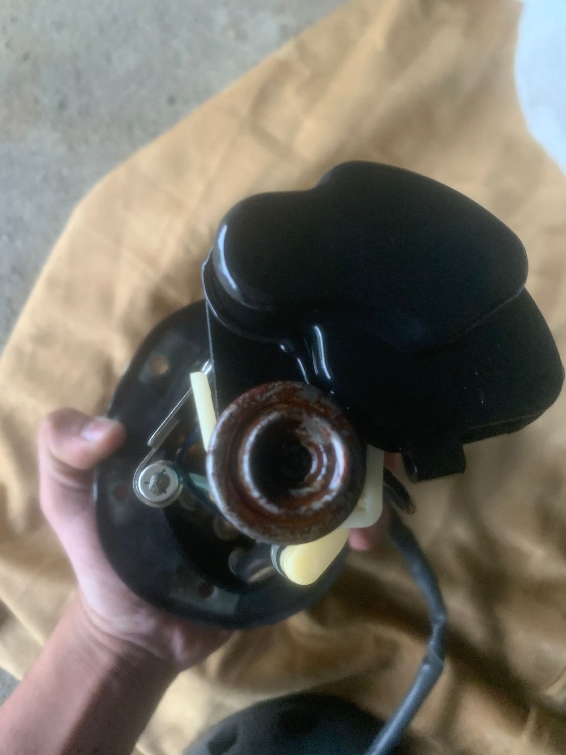

post photo of your pump assembly
https://imgur.com/a/SJQ04pr
this is how it looks when I pull the assembly out of the tank when the bike doesn’t start.If you see the regulator it’s coming outwards.This is how it looks when I push it back in then it starts right up.https://imgur.com/a/BT5fhVd

Post photo of this side after you've pushed it back in. Other photo seems to show FPR spaced too far away from filtre body. Doesn't appear to have clip fully pushed over barbs on this side. I would just put hose-clamp around entire thing.

Originally Posted by Hariscbr1000rr
This is how it looks pushed in.The plastic piece does look like it is in the right place.I ordered a new fuel regulator It is coming Saturday.Tomorrow I will put a hose clamp tomorrow on the old one and see what happens.
Ok, these photos show clip isn't fitting as tight as it should. In first photo, see how left edge of clip isn't flush with black line of housing? There's angled gap. On 2nd photo, you don't see black barbs filling 2 holes in clip like in this photo.
It's possible someone used thicker SAE-sized O-ring on that FPR instead of proper metric one. That would prevent FPR from seating fully and allowing clip to engage. See how new FPR compares to current one. In any case, I'd wrap stainless hose-clamp around entire thing.
Also install strainer sock at bottom. It'll protect your pump from larger particles that can damage and wear it out prematurely. Honda # 16700-MEL-013. ebay - CBR fuel strainer

that pump is held to gether with less than a prayer - if you can't get the parts to engage properly, replace the whole thing.
Are the black clips snapped off by any chance?
so It was the clip all along I clipped it in and took it for about a 15 mile ride it rode great.I can’t believe I didn’t clip in the plastic piece.Great eye.I’m still a little hesitant on taking it for a long ride of the worry it will break down.I installed the new fuel regulator it was around 60 dollars should I keep it or return it and put that money into a new pump.If you think this assembly is fine I would really like to keep it.I have spent a lot of money on this due to towing and parts.

yeah, frustrating tossing parts & money at problem. Your flow-test shows pump flowing plenty and filtre's not clogged so I'd keep them. Test with old FPR with properly installed clip. AND wrap stainless hose-clamp around whole thing just to be sure. If testing successful return new FPR.
