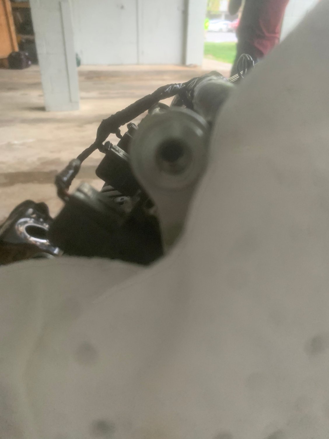

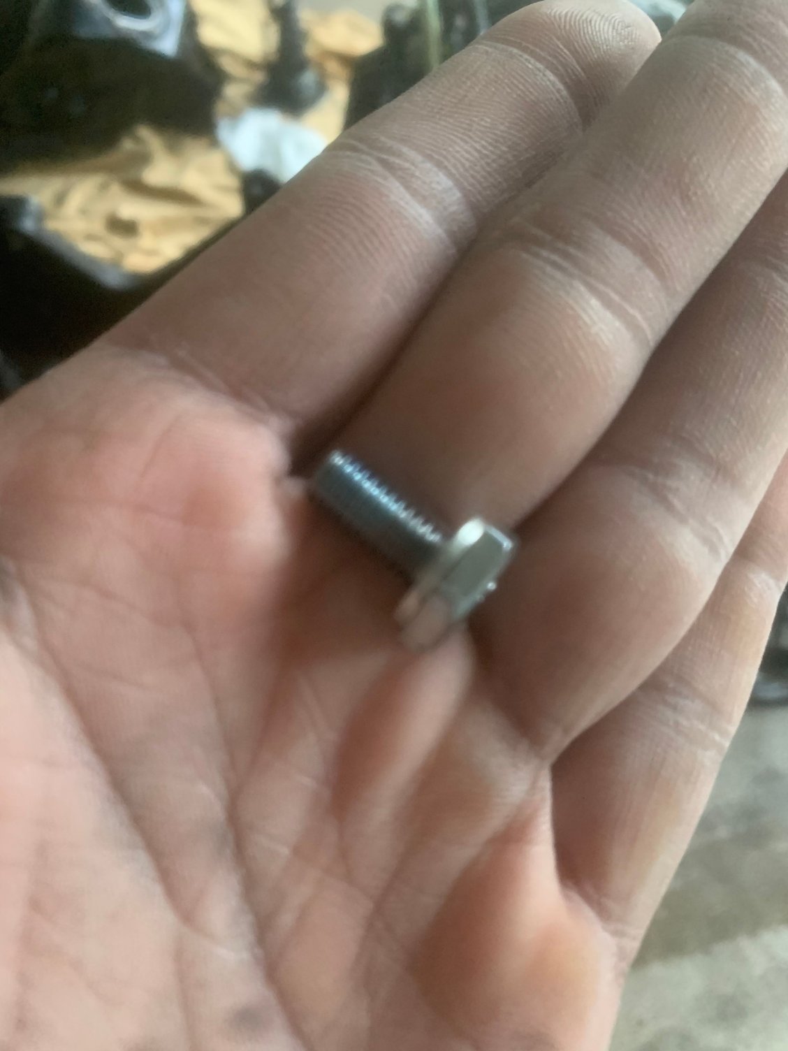

I tried to do a flow test but the fuel pressure kit didn’t have the right size.
Here’s a picture of the bolt where the fuel pressure kit connect to.
