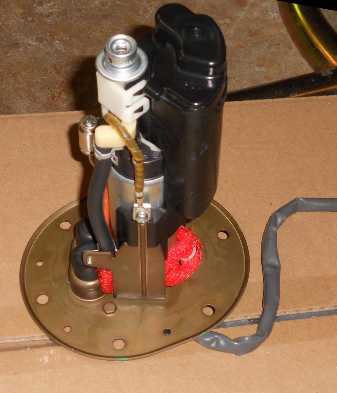

O-rings are never used to hold a part in place - the regulator must be physically secured somehow to stop it popping off.
Yup, that hefty plastic clip at top holds it onto filter.

No, that's only for pressure-testing (can use OEM bolt for that).
Does your pump have white clip to hold FPR in place?
Flow test just requires unbolting fuel-hose from rail and sticking it into measuring cup. Crank engine for 10s and see how much petrol you've collected.
Considering how much rust you had in tank, wouldn't be surprised if filter's completely clogged and you're getting less than required flow. Numbers should be about twice what's listed here (error, they used # from 600).

Flow in the diagram is a minimum, you’re good. Fix the problem with the regulator falling off - that’s why you are getting no fuel.
why would the regulator keep falling off?I thought maybe too much pressure due to the new fuel pump was causing it to fall off.
post photo of your pump assembly and compare to this photo
Is clip firmly attached and held in place by barbs on filtre assembly?
I guess you can put giant hose-clamp around whole thing.

my assembly doesn’t have the red packing at the bottom.
