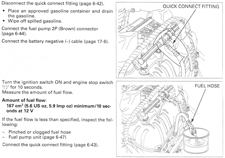

UPDATE-I was able to get a thread Chaser kit with the right size it worked great.The new spark plug went in like butter.I put everything together.After I was done it started right up.I rode to the gas station filled up and put b15 fuel injection cleaner.I rode about 10 miles and the bike shut off on me.Once again I had to rent a truck.and haul it home.I can’t really win with this bike.now it kinda doing the same thing it did when I bike first broke down.It sometimes starts for a few seconds as soon as I give gas it cuts off.The first time the bike broke down and I took out the fuel pump I found a small piece with a rubber line inside the tank.It come off the fuel pump after I put it back on it started not sure if that was the cause.I will tank the pump off and see if the piece came off.any advice?

lol Mine is much the same. Does sound like fuel starvation - I think you can test that by disconnecting the fuel line from the injector rail and turning the ignition on? You should get a robust flow of fuel for a second or two as it primes.

Do actual flow-test and pressure test of pump to get some numbers.
