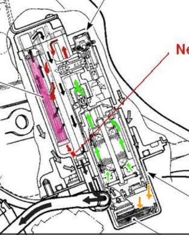

hey I just ended up replacing the fuel pump it ran great after.I should’ve diagnosed it but I just had that feeling it was the pump.I need to get a new assembly sooner or later I think.What do you think I replaced the wires inside,fuel regulator,fuel filter and new pump.

That sock on bottom is not filtre. It's just strainer that filters out big stuff that'll damage pump. Real filtre that removes particles that can clog injectors is built into pump housing after pump (pink below).
New pump may be pushing petrol into clogged filtre. Only way to know for sure is to actually measure flow-rate coming from pump-assembly. This tests entire assembly: filtre sock, pump, FPR and fuel filtre itself.
