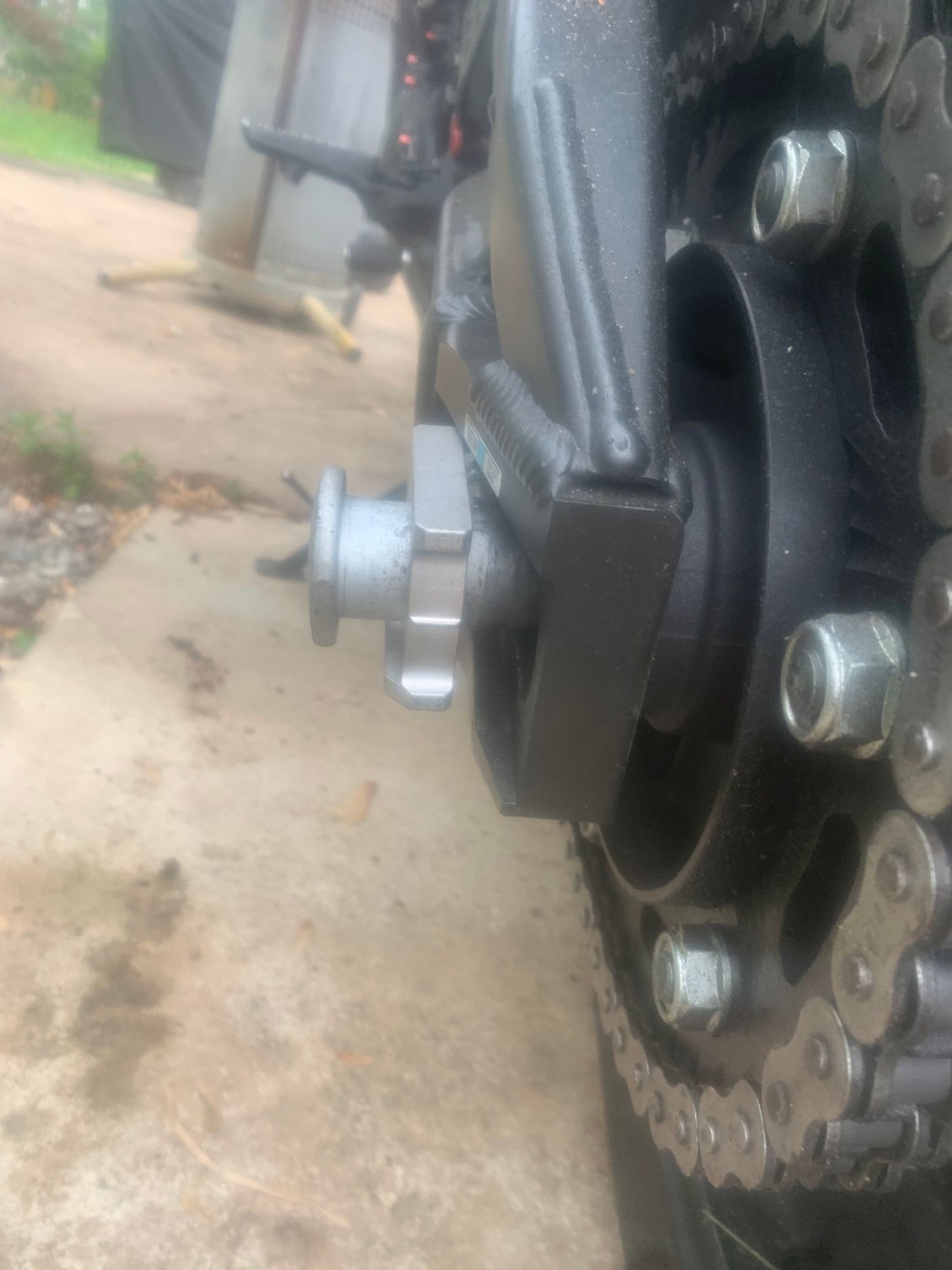

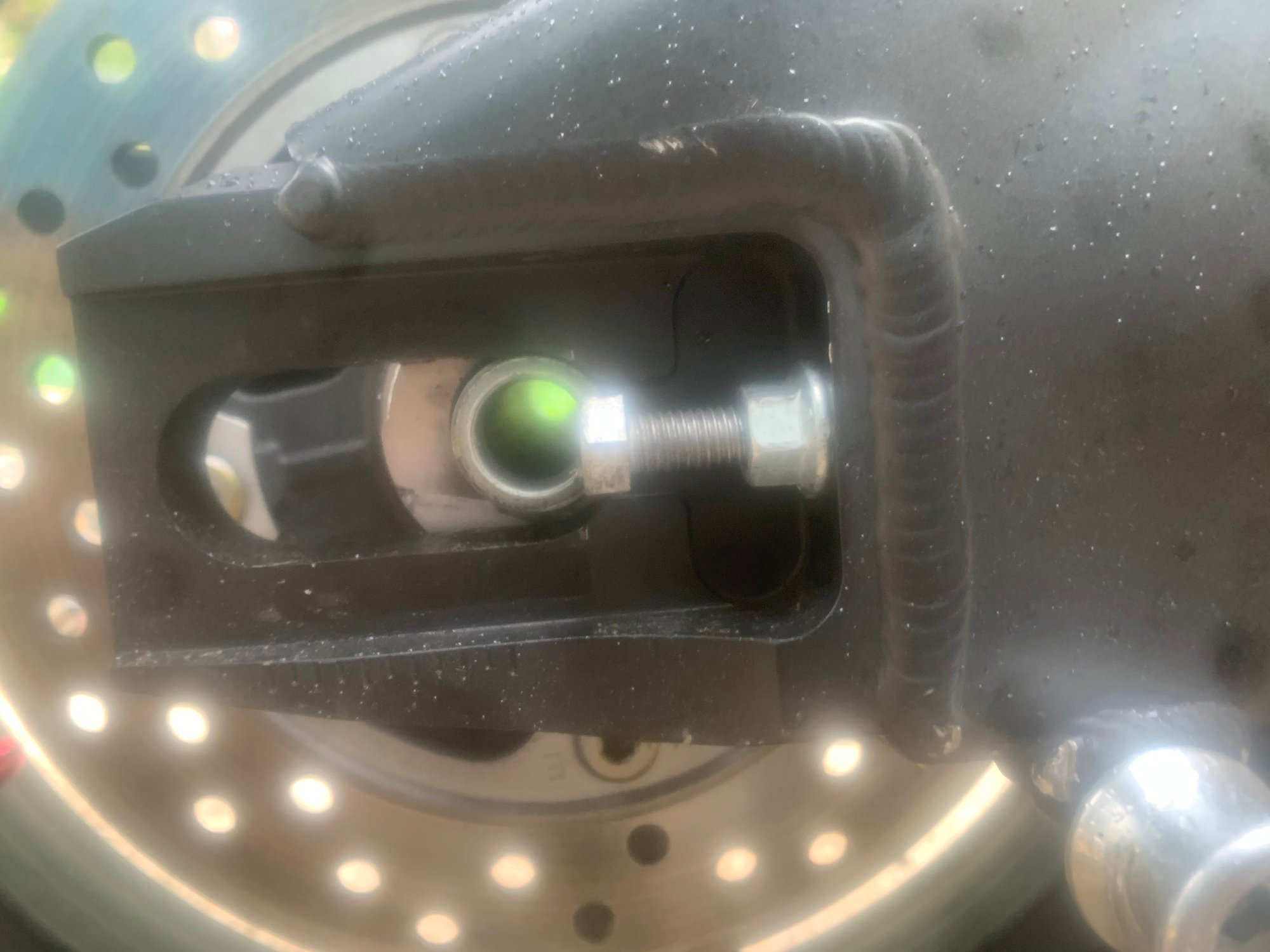

i completely didn’t understand what you meant.Are led not safe?When I crank the bike the headlight turn off until I let go of the starter bottom.Also something crazy happen this week.I had the tire replaced.After riding about 3 miles I felt the backend move side to side I thought maybe it was a pothole I kept going.I felt it again and knew something wasn’t right I was on a road where there was no place to pull over.I took it easy until I could.As soon I got off I saw the Axel nut and chain tensioner where not there and the Axel had moved.This could have been bad.I got really lucky.Before riding off there was a Axel nut and tensioner.I think they didn’t torque it down or even tighten it.I will never go back there again.I ended up pushing it 2 miles to my uncles house.looks like I need a Axel nut and chain tensioner is it fine to get these parts used?
