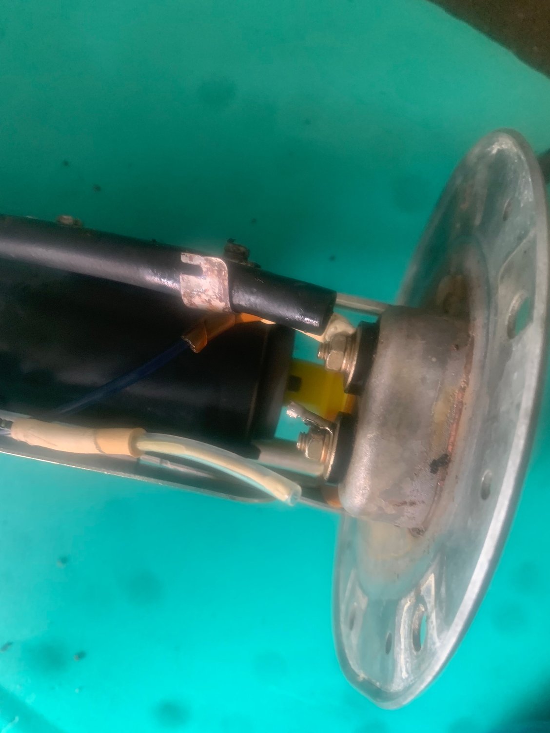

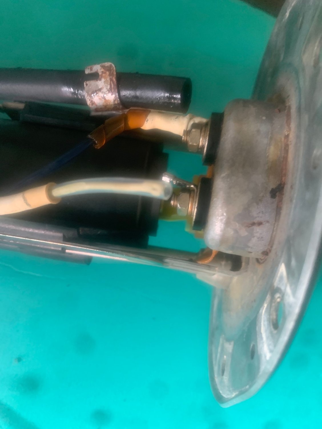

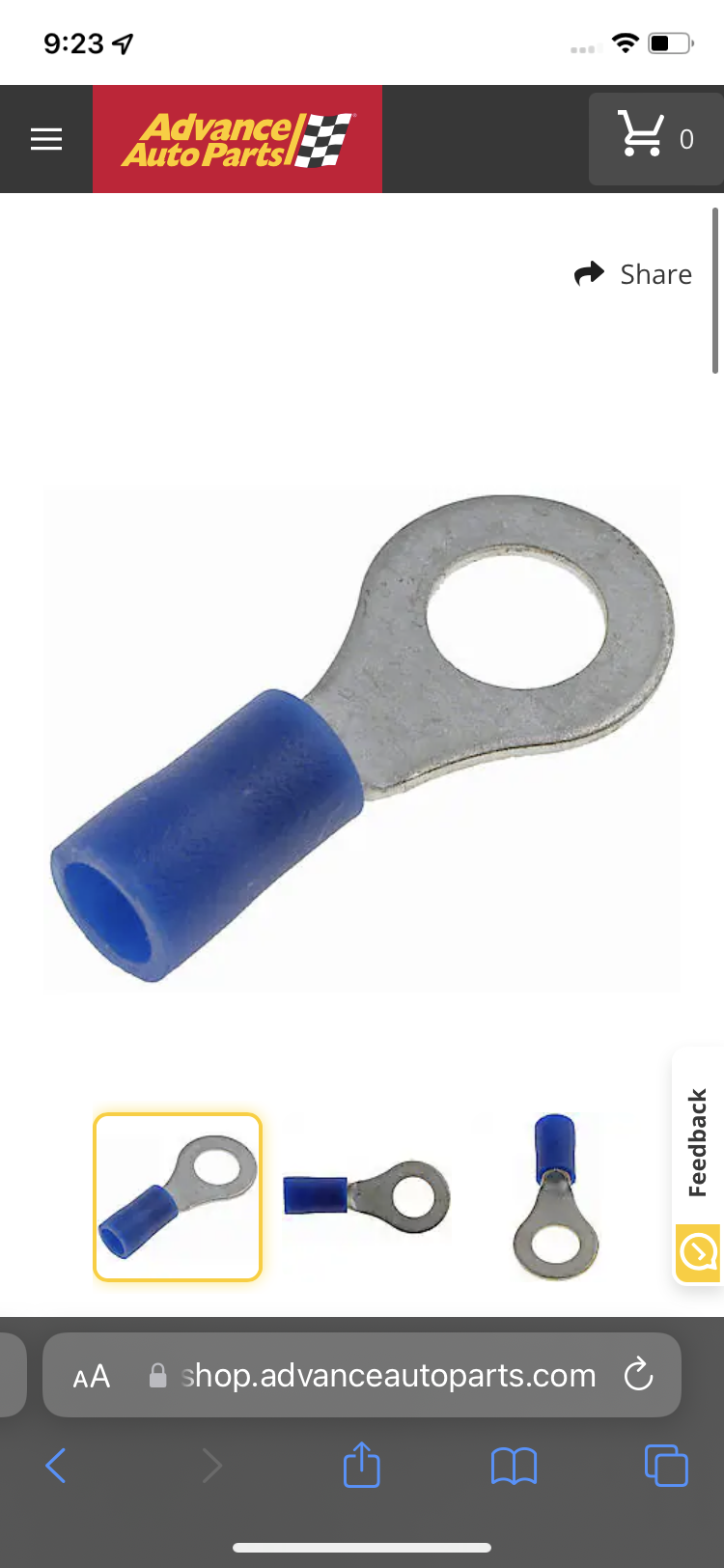

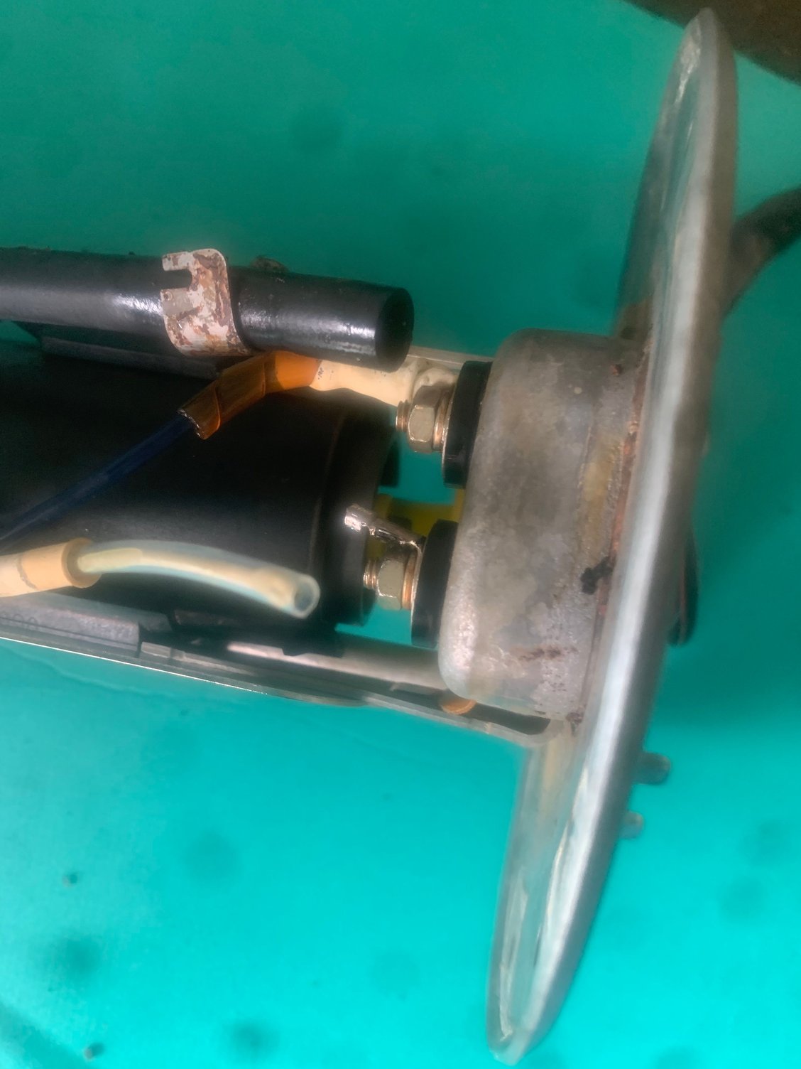

I can proudly say I have put 1000 miles since it last broke down.Really want to thank all you guys for the help really couldn’t do it without you guys.Currently fixing the small issues the bike has.I also found out why the low fuel light wasn’t working.a cable thermal connector came off.I couldn’t get it back on there so I put a new one there after I installed it I realized that there is a plastic sleeve around it.Will it deteriorate in the gas.

Hopefully you soldered terminal onto wire. Better to use adhesive heat-shrink tubing for insulation, but those blue things should be OK.

I don't have any experience with adhesive heat shrink, but with it immersed in fuel all the time, I'd be concerned with it (the adhesive) dissolving in the fuel. Might not be a lot, but do you want to risk it in your injectors?
Thoughts?
Thoughts?
I haven't had any issues. But suppose it may vary by brand. I suppose there could be different scenarios depending upon how much it dissolves:
1. it dissolves completely. In which case, it won't clog injectors
2. it dissolves partially and comes out in chunks. In which case, it should be large enough to be trapped by filtre. If finer than that, it should pass through injectors without causing clogs.
Ok, no adhesive heat-shrink just to be safe!
