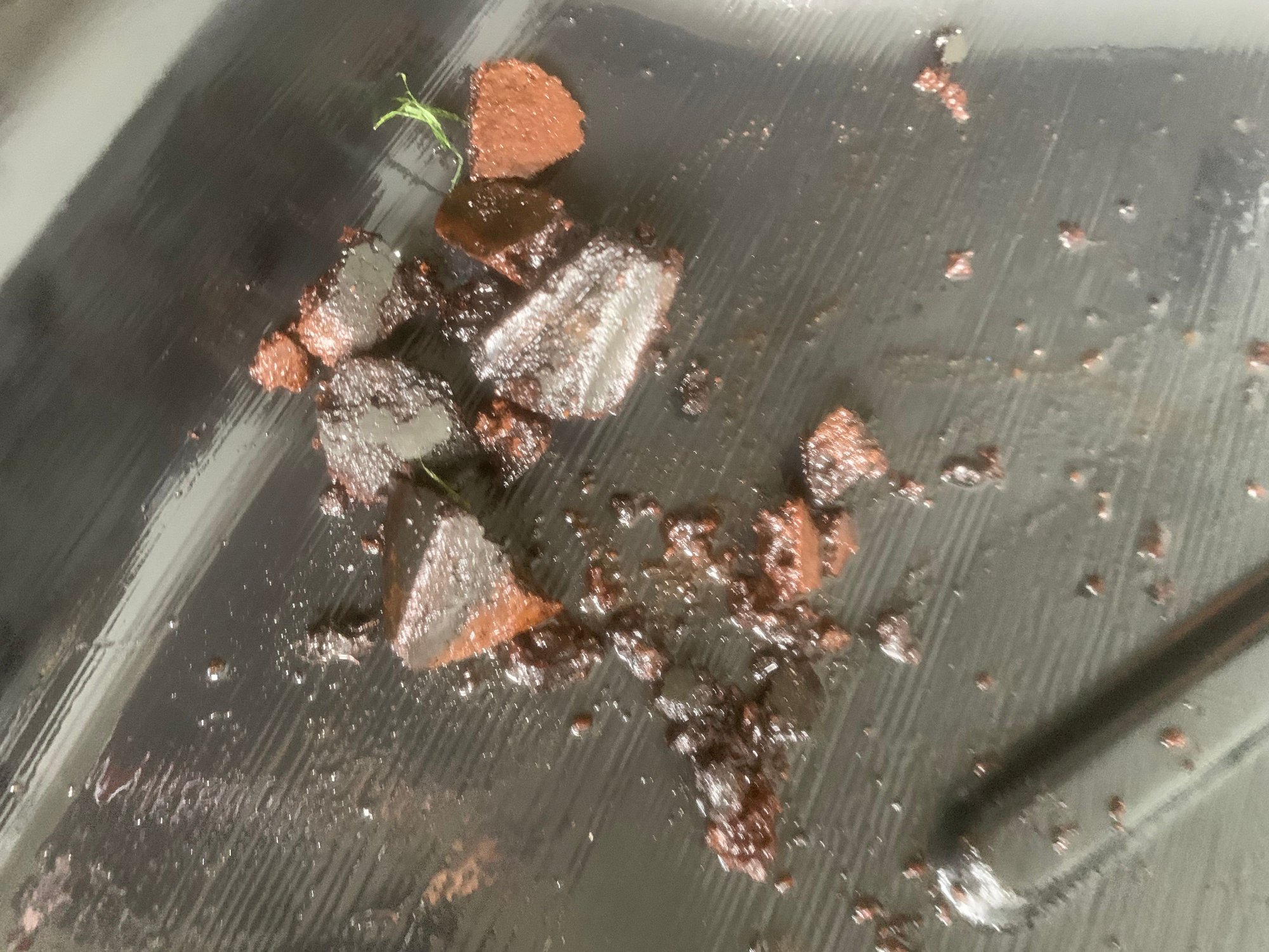

hey after removing the fuel pump I found chunks of rust in the tank.I removed them and cleaned the gas tank.Added fresh gas and it started right up.I also one of the spark plug wouldn’t thread in all the way.Causing the coil not to go in all the way.My guess is the threads were damaged previously when spark plugs were replaced.Should I leave it like that or retread it?

Wow, lots of crap in that tank! Good job on cleaning it out and getting bike running again!

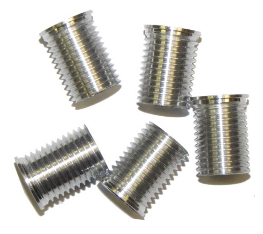

If spark-plug is holding OK, I wouldn't worry about it. But plan on removing head and getting proper thread-repair done next time. When plug is removed and torqued back down, it'll most likely strip. Many people use Helicoils, which work fine for one-time permanent repair. But for parts that will be removed and re-installed many times, coils will unravel and cause future headaches. Best to use solid metal inserts, Time-Serts being one of the best.
