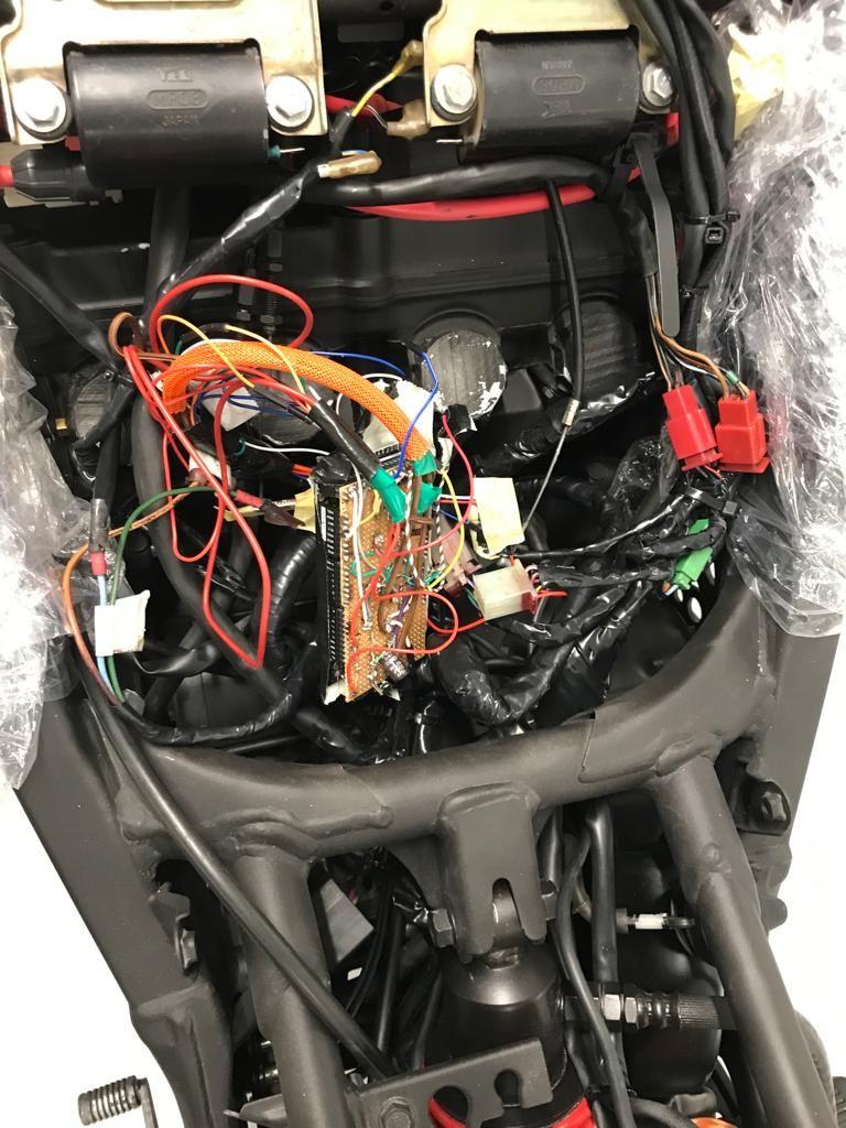

sorted my temporary indicator resistor setup and made space for a wee tool kit.

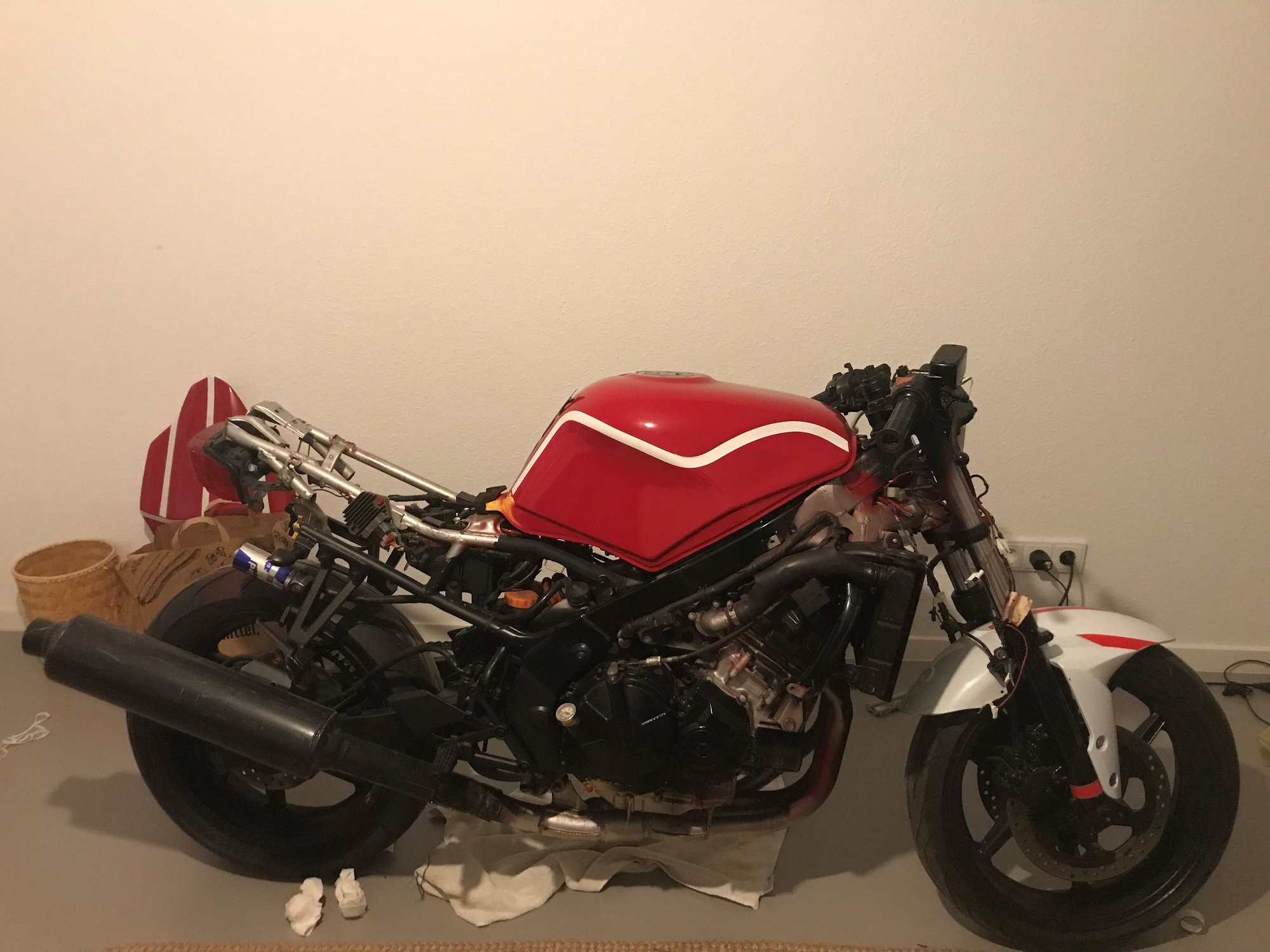

hi every one, i'm new here, i bought cbr600 1995 couple days ago so now i'm starting my little project too
i have new battery, fuel pipes is disconnected and broken, target is to start it
