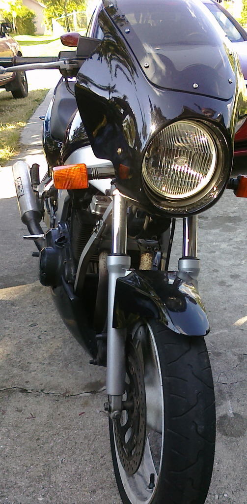

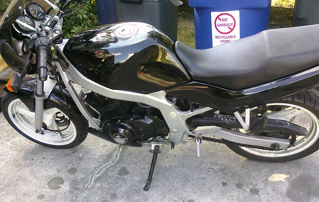

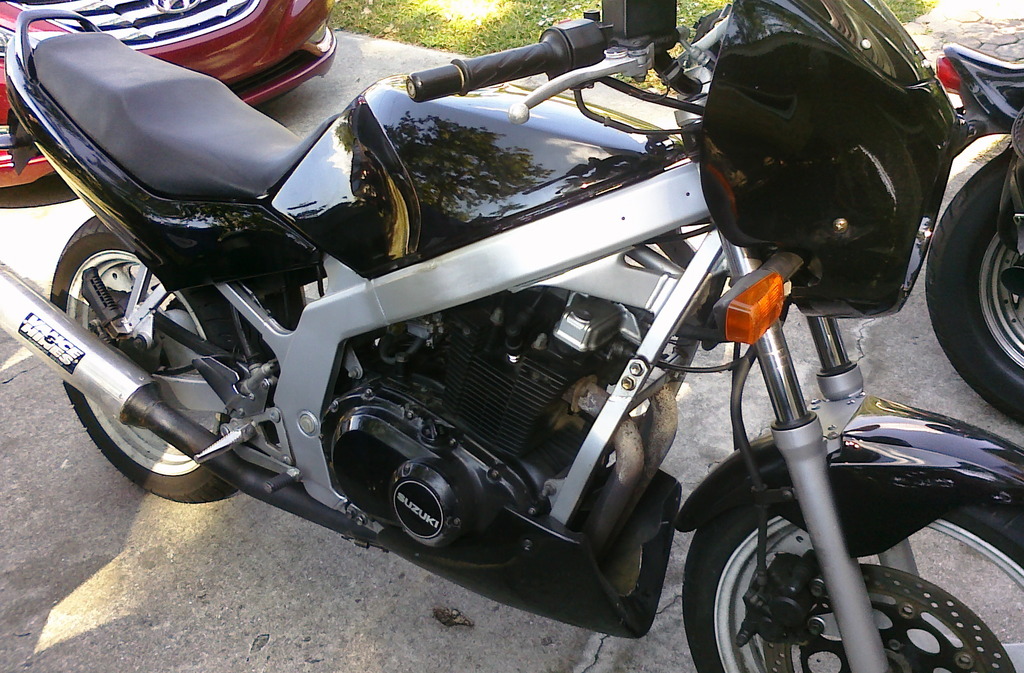

Mine had the V&H pipe, a K&N filter, and it was jetted appropriately. It sounded great, and the PO from me said he dynoed about 50rwhp. It was quite a fun bike.
I bought my wife an xs650. Well, the first time she got on it, she dropped it and said it was too heavy for her to control. So, then we went and found the GS, it worked great for her, light and cheap (as she did tip it over on occasion). But I loved riding it. You could bang through 3 or 4 gears at WOT and not be in too much trouble with the law.
50rwhp is a tad optimistic on the po's part haha stock is 45-52 ish on a new and healthy stocker at the crank dependant on years / sources. think wheel horse power is more like mid 30s realistically + a few for getting it fuelled and breathing right, saying that I'm making presumptions as I've never seen any dyno prints.
