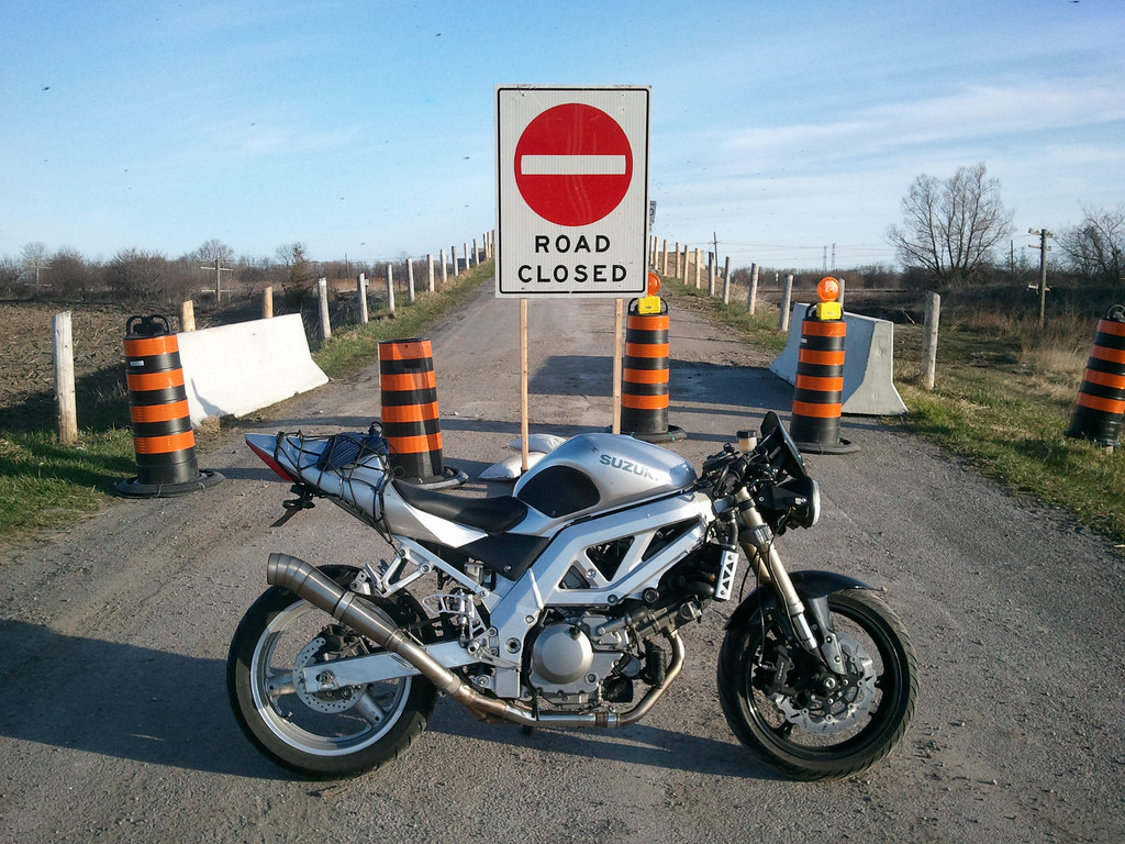

kinda loving the extreme gp can after seeing it on this sv and on a rc51... nom!
