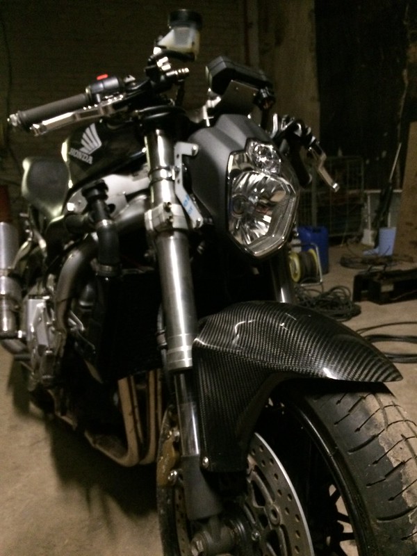

now for the highlight, mounted headlight and carbon mudguard. not keen on how the speedo sits in relation to the headlight but i'll talk about that in a second.
just for the record its a carbon king mudguard and the holes don't line up 100% perfect although it is very very close.
haven't yet sorted the height/angle but on the whole I'm really quite impressed with the kit, i was a bit uncertain about the clamps and brackets but they are decent enough and sit super close to the forks. I've left the protective covering on the brackets as well for the time being, quite like the print on this side, may do something interesting paintwise with them, we shall see. i'll see if they stick because i much prefer making things up where i can.
