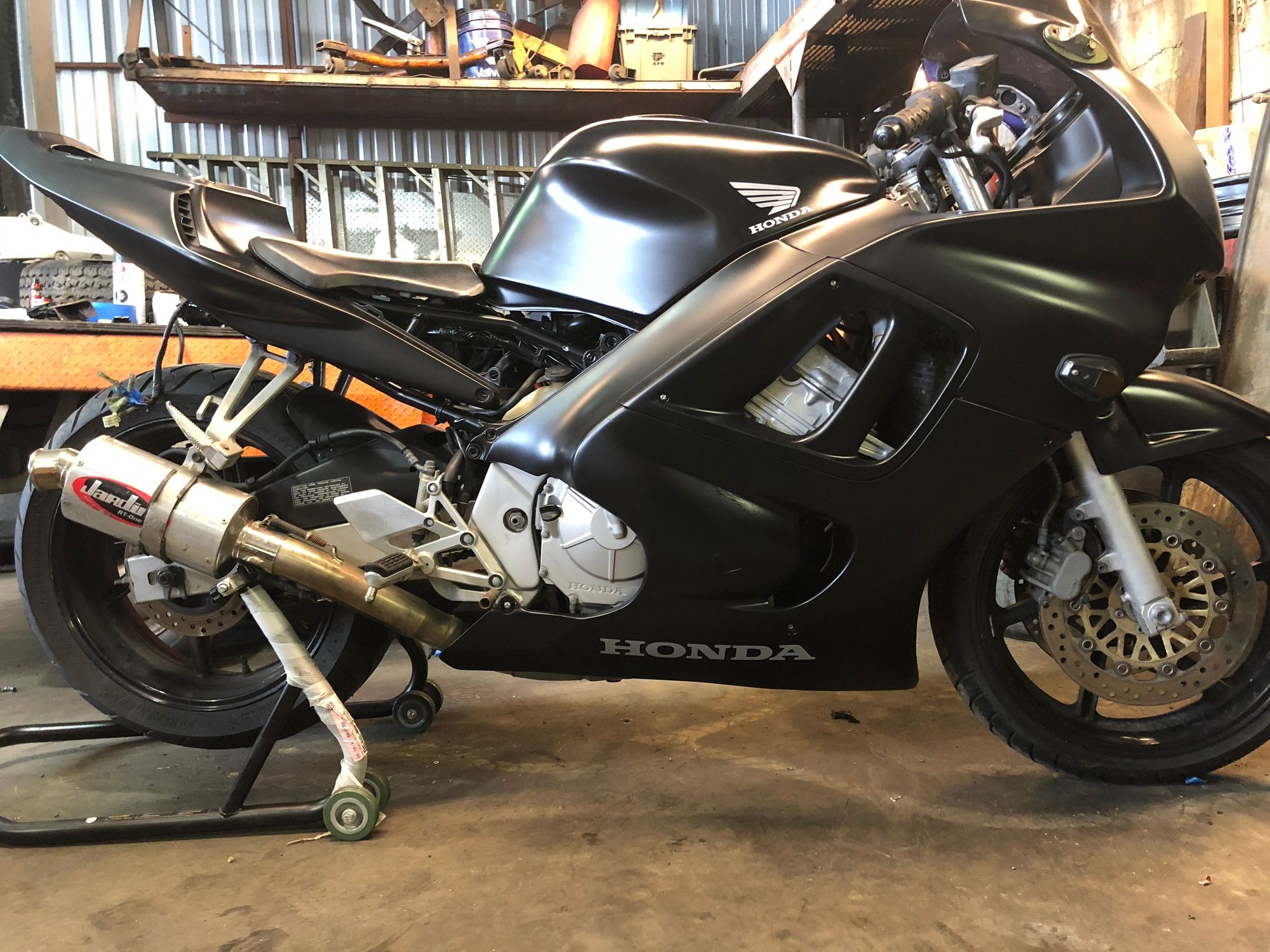

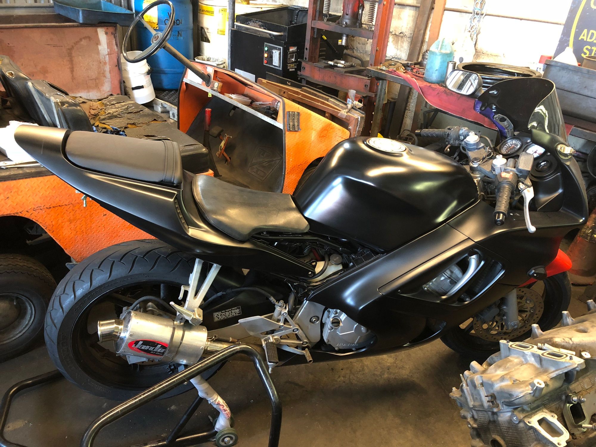

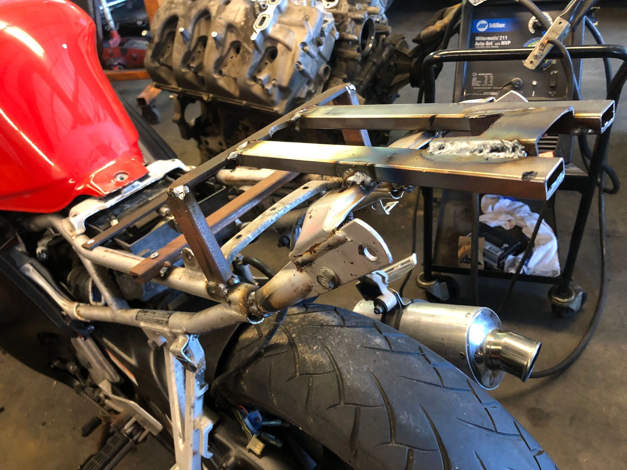

Notched the rear end of subframe and bent it up, filled it in, mocked up the support and slide bracket for passenger seat...
Most fab work done for now, time for some tattle canning 😜
Painted subframe as well...and the tank!
Tadah! Finished product... still waiting on tail light to arrive so I’ll post pics of the bracket I’m building for it once it gets here...
Added some quick decals
Out of order but here’s how the undertail looks before the painting

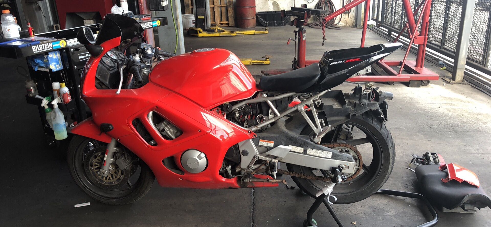

When I first brought her home

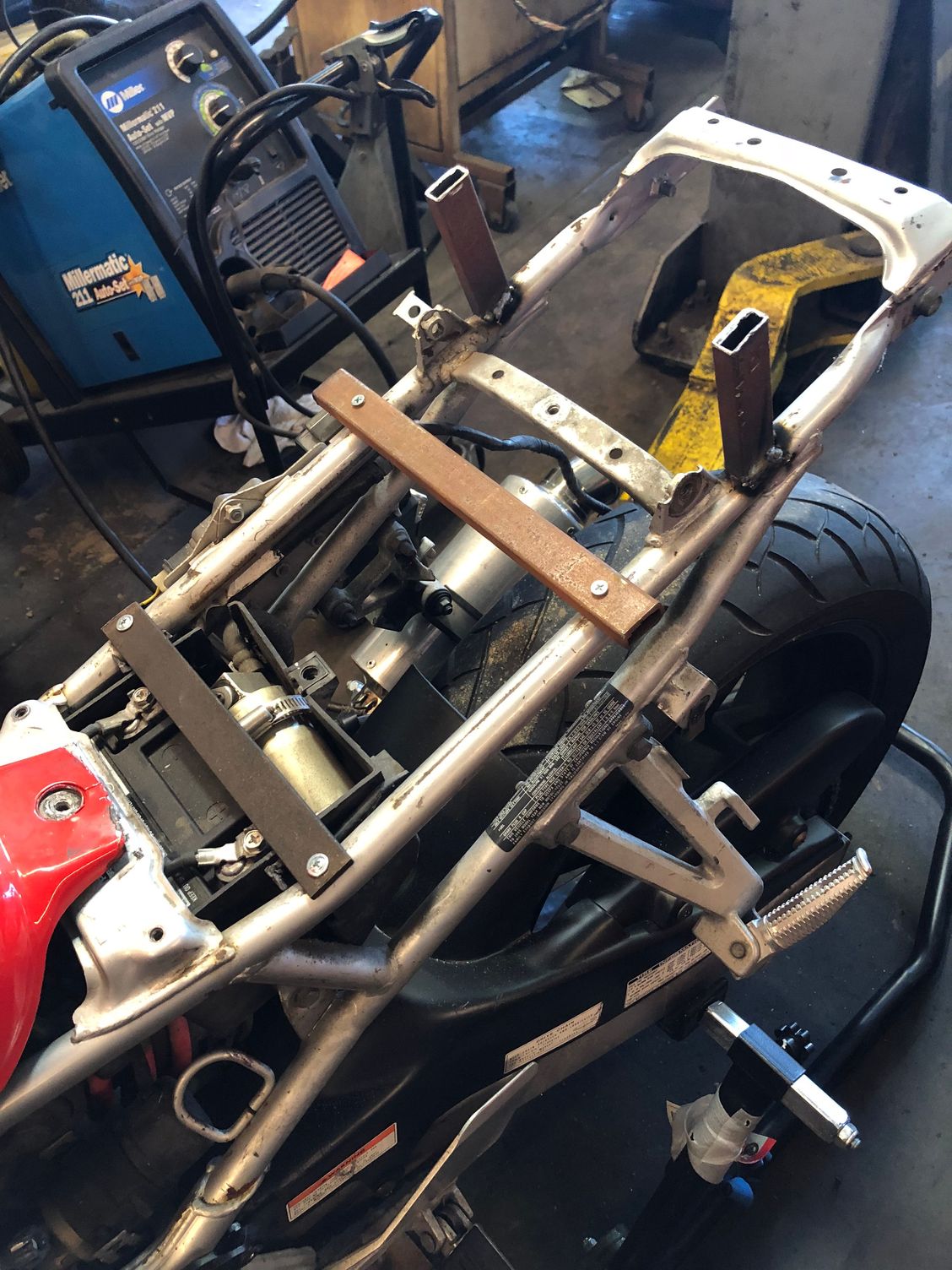

So this is where the fun starts... pieces of flat straps pre drilled and used self tap screws to lign them up and hold them in place to make sure front seat slides in.
Lots of tack welding parts in and just eyeballing as you go...
