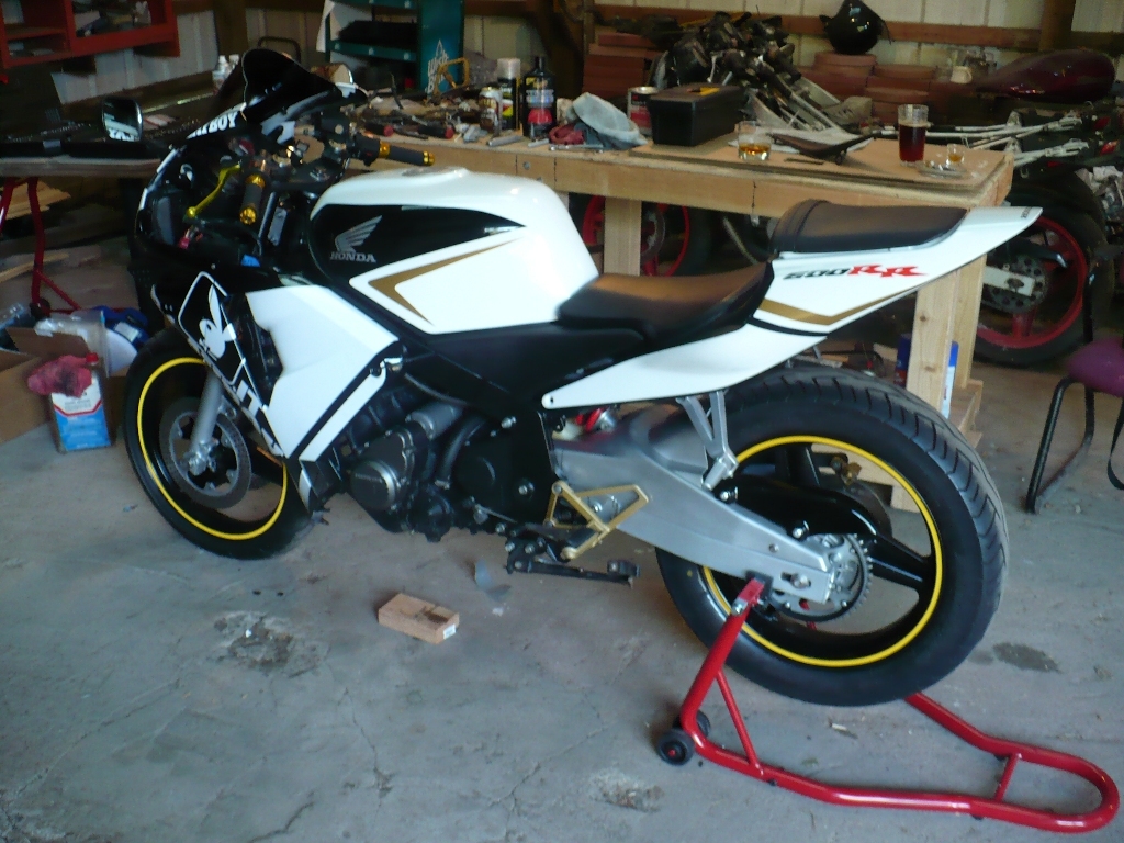

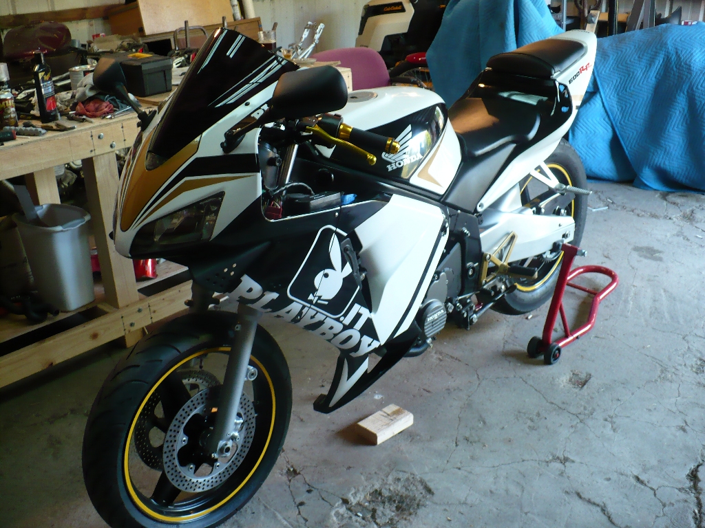

Some more teaser shots...can't wait to get it all together. In that tough spot with all the little detail work...on the home stretch though.

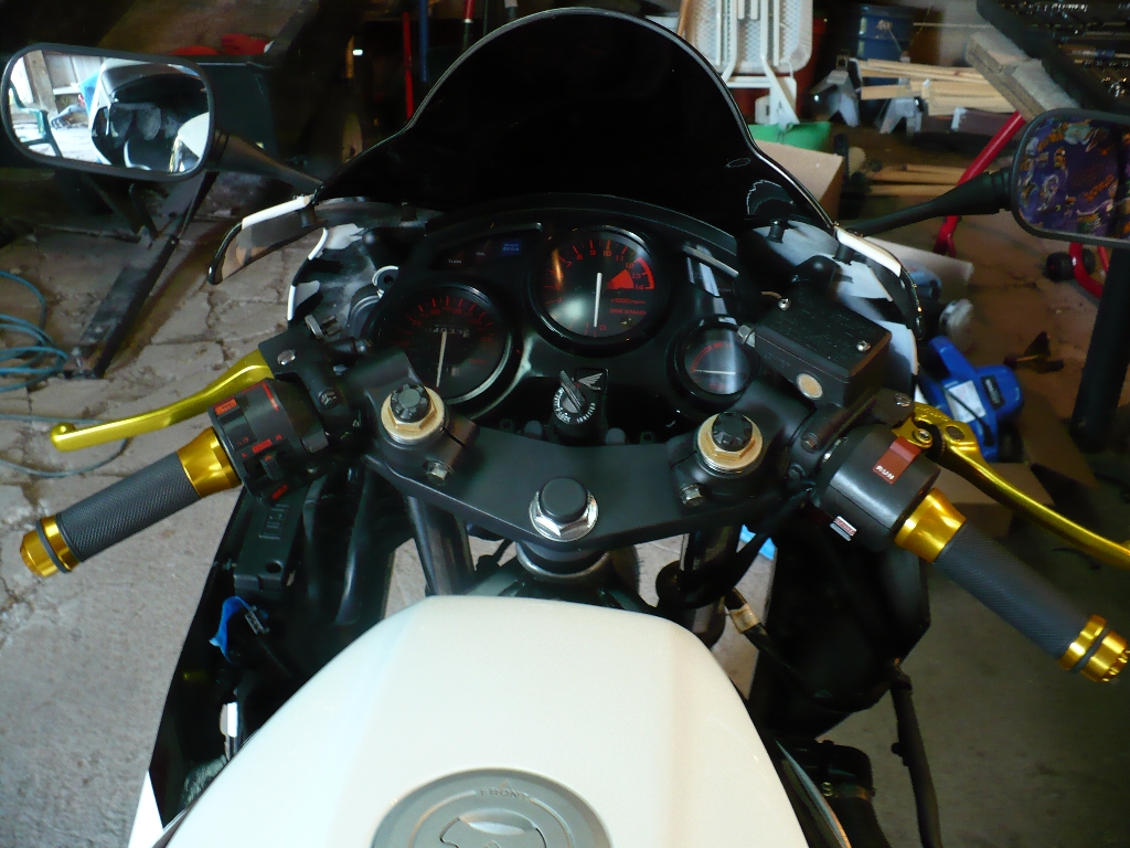

Okay, I know there are no followers to this thread anymore, I guess people just don't much care, but I worked very hard on the RR conversion today and feel very good about how it is turning out.
I cut the Hurricane fairing stay like Doc did, and I see a few problems. It forced me to put the front fairing together and see what was going on.
In the process I got a chance to put some of the parts together and this bike is going to be special. It takes a lot to impress me but holy cow!
I really don't care what anyone else thinks, I have impressed myself and that takes a lot. This is going to be a very special bike.

I'm still following. Was hoping we would get to see a fairing shot. Looks awesome. I like the little details like the refinish on the master cylinder reservoir. That is the kind of thing that takes lots of extra time, but it really makes the bike. It's cool to see your vision come together.
After watching ebay for months I finally scored a used Corbin RR seat this morning. I had bought a knockoff seat and was unhappy with the crappy fit and finish. I was feeling like I needed the seat to be just a bit thicker than stock to work with the footpeg position and the Corbin looks like it might do the trick. Plus I hear they are very comfy.
Oh yeah, I wanted to ask- did you find that the forks hit the upper fairing trim panels before full lock? I just discovered that mine do that yesterday. Dunno if I can move the panels out a bit or if I might need to trim them somehow.

Ah yes...upper fairing trim panels. I couldn't put them on after mounting the Hurricane fairing stay because the fuse block sticks up...that is why I put the front fairing on to see how everything fit...but I tested the fit originally and there wasn't any interference. You may have your fairing higher than mine. Those pics don't show the actual position because I just hung the parts to see what it will look like.
