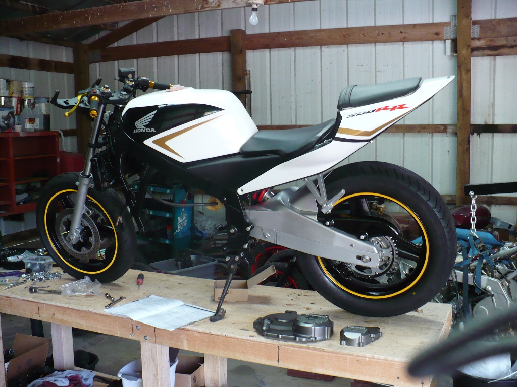

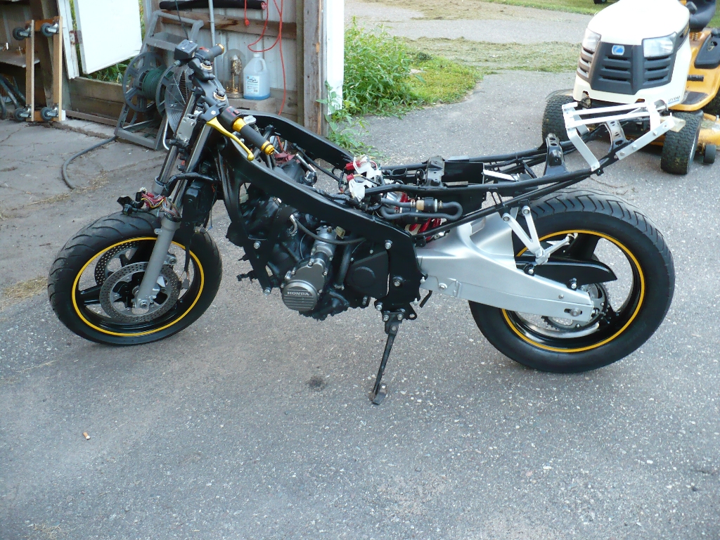

Making progress on the build. I did a mock up before I took the bike down off the platform to install the engine.

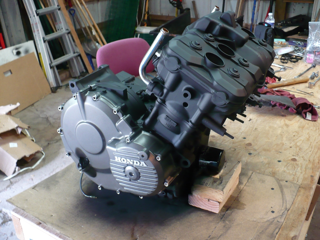

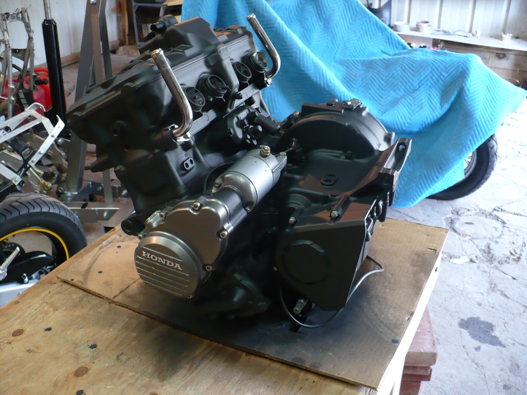

Then I worked on prepping the engine for installation. The engine is flat black which is keeping with the RR colors. It looks a little boring, but that is because you won't see much of it once all the fairings are on the bike.

It all looks amazing. Good call on those side cover screws, they look really nice. And I continue to marvel at your painting skills.

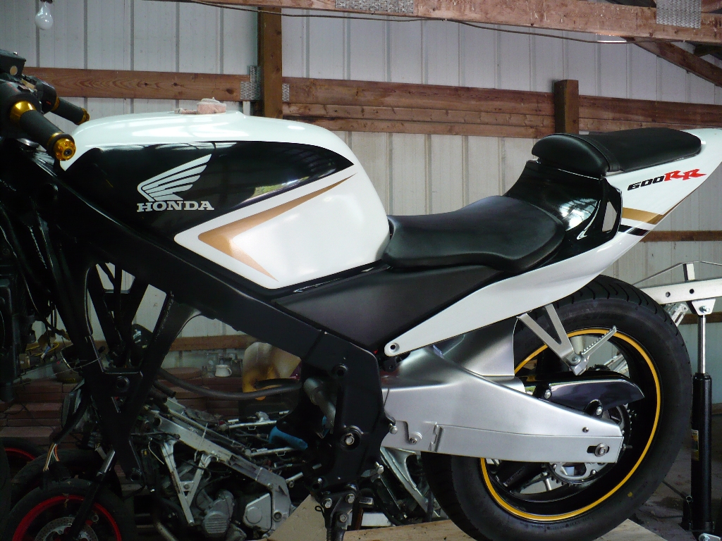

On the paint, I really like how clean it looks with the black edging. That was a good call on my part.

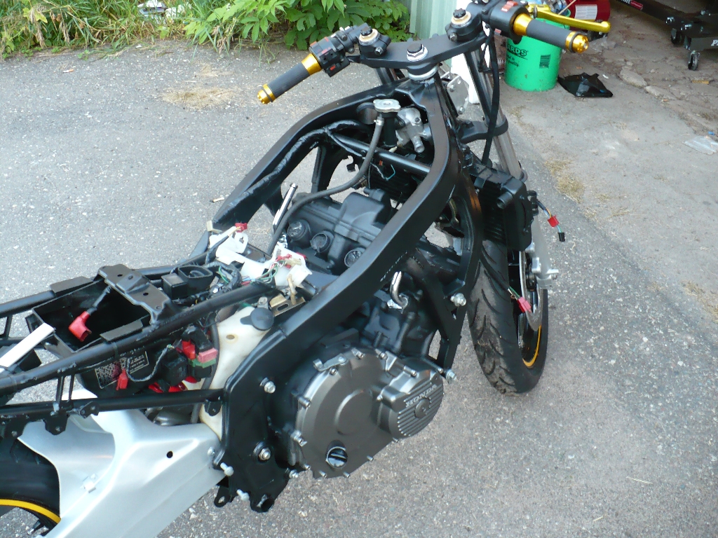

Woo Hoo! That's a big step. Looks really good. A little unsolicited advice a little too late - I ended up hanging the chassis sans front fork from the rafters with two motorcyle straps and putting the engine on a furniture dolly. Lowered the chassis over the engine, then started the swearing and wiggling of both the chassis and the dolly.

I have jacks and dollies and an engine hoist. I lifted the bike over the engine and then could not figure out a way to lift it up there. I finally strapped around the cylinder head and under the transmission so I could get a straight lift with the engine hoist and lifted it straight up. There are no real lift points on these engines. I thought about buying a hog ring and using the starter bolts but was afraid that wouldn't be strong enough...but I got it in. My biggest problem is I have a bad back and can't really lift much...I need to use mechanical means more than most people.
