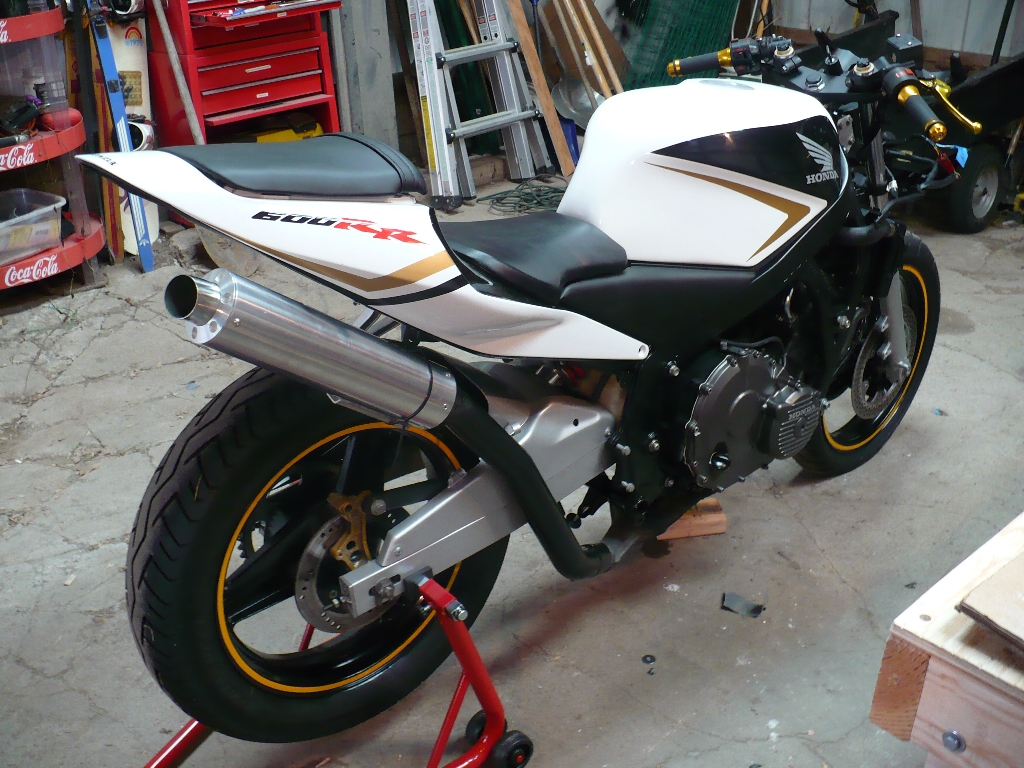

Here's the end result of my day of head scratching and test fitting stuff. Not much obvious progress since my last shot, but you inspired me to haul the bike out of the garage so I can stand back and look at it, and I was able to get a little better shot.
Checked off kick stand, radiator, exhaust, oil cooler installation and I think I sorted out how and where the steering damper might fit.

Played around a bit with fitting the pipe. This is a Vance & Hines NOS pipe I got off of Ebay for $50 because it looked like it would fit. It was for a different 600cc bike I think a Kawi or Yamaha. It fits right where I hoped it would but I have to drill out the rivets and rotate the can. It also will be up a little tighter to the bottom of the tail once mounted.

Very nice fit, looks like it was made for the bike.

Yeah I hit the jackpot on this. Guy had it advertised in ATV parts...I bought the pipe and he sent me a message to call him. He said he screwed up and that it wasn't an ATV pipe...I said yeah I know it's going on a CBR...he said he was relieved because its a sport bike pipe. Then he tells me he has another one if I wanted it...so I bought both. Will use the other one on the next bike. I love those kind of deals.

Very nice fitment, I agree! I was wondering what a high-mount style pipe would look like on the bike the other day since my stocker and the Yoshi both sit very low and off to the side.

Thanks Tahoe. I thought the high-mount was more in keeping with the "RR" theme since the real pipe is under the seat. I was lucky to find these new old stock pipes that fit.
