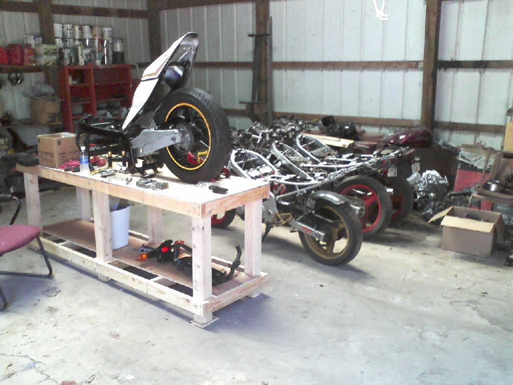

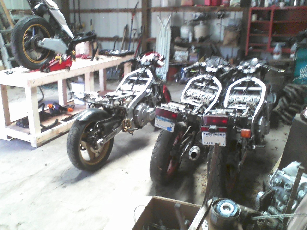

Took some pictures in the barn over the weekend. This is just some of the CBR's and parts. I have 4 full sets of Hurricane plastics now and parts to build 5 bikes. My list is actually not up to date...there are 9 bikes now.

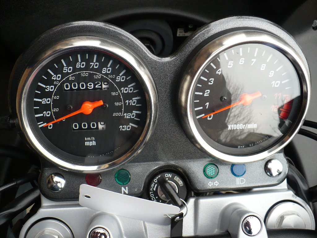

This is bike number 9. It's a 2009 GS500 that I bought so I could have a smaller lighter bike to practice on. It had 92 miles on it. The guy rode it once and decided he didn't want to ride. He gave me 2 brand new Bell helmets and a nice jacket too! $2500...a steal. The bike is in showroom condition and I love it for riding around town. I put risers and pull backs on it to get the riding position up to where I wanted it.
http://s1033.photobucket.com/user/dennisgb1/media/Bike_zps96f33a8f.jpg.html][/URL]

Yes it does seem like that...but...I have a strategy. This is my plan for retirement. I'm done working in 3 weeks and want to work on bikes as a hobby...maybe make a little money on the side.
The CBR was the first one after years away from motorcycles. I kept buying parts on Ebay, and figured out that I could buy used bikes that needed work cheaper...and there are a lot of them out there. All three of the bikes in the picture run. One has very low miles on it. They need to be gone through, and put back together, but I have all the stuff I need to do that...the second one will go together as a Hurricane.

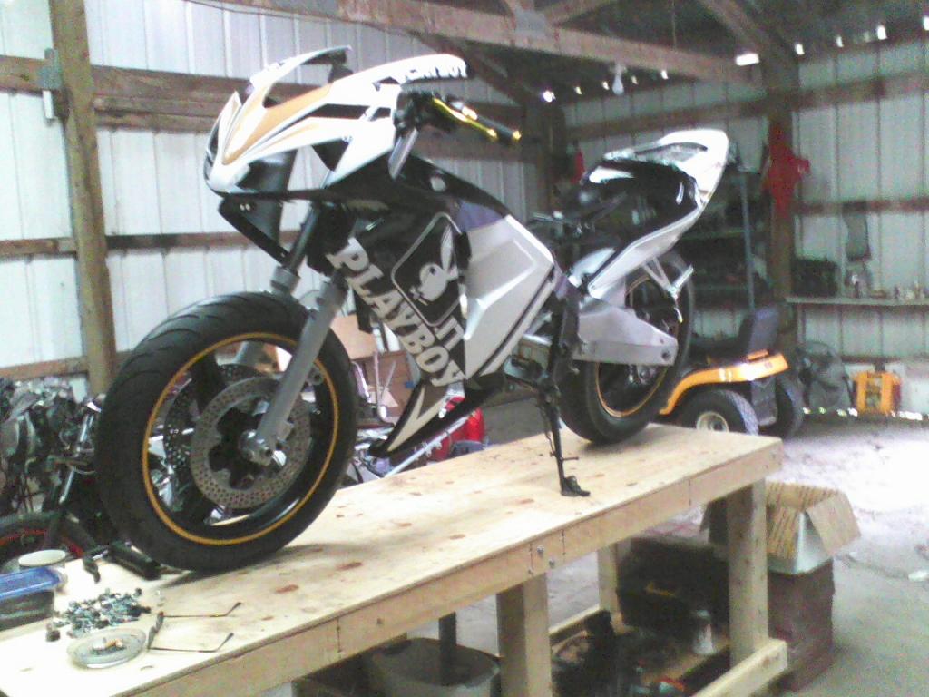

Had some time to work on the RR over the weekend.
I have a rolling chassis!!!!
So much fun finally putting it together and seeing what it will be. So far I am very happy with how it is turning out. This is going to be a nice one.

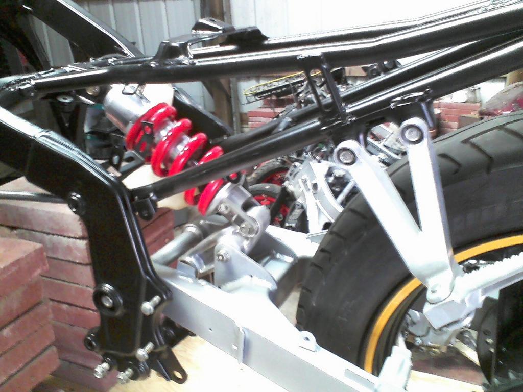

Here is a picture of the Progressive Shock.

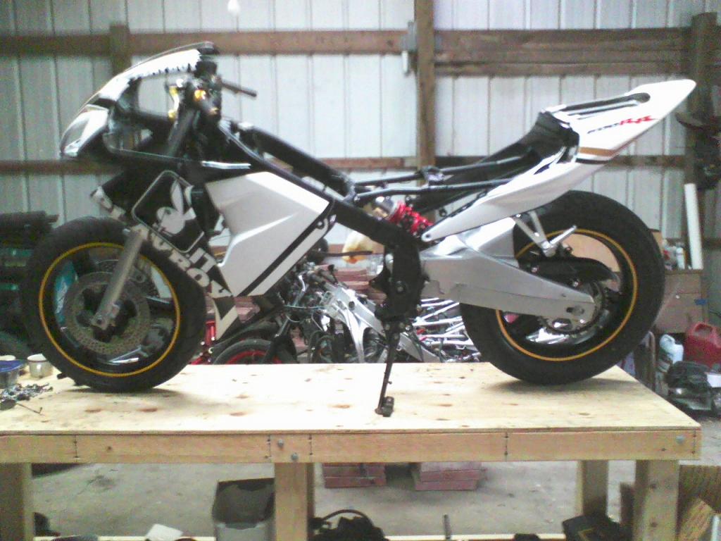

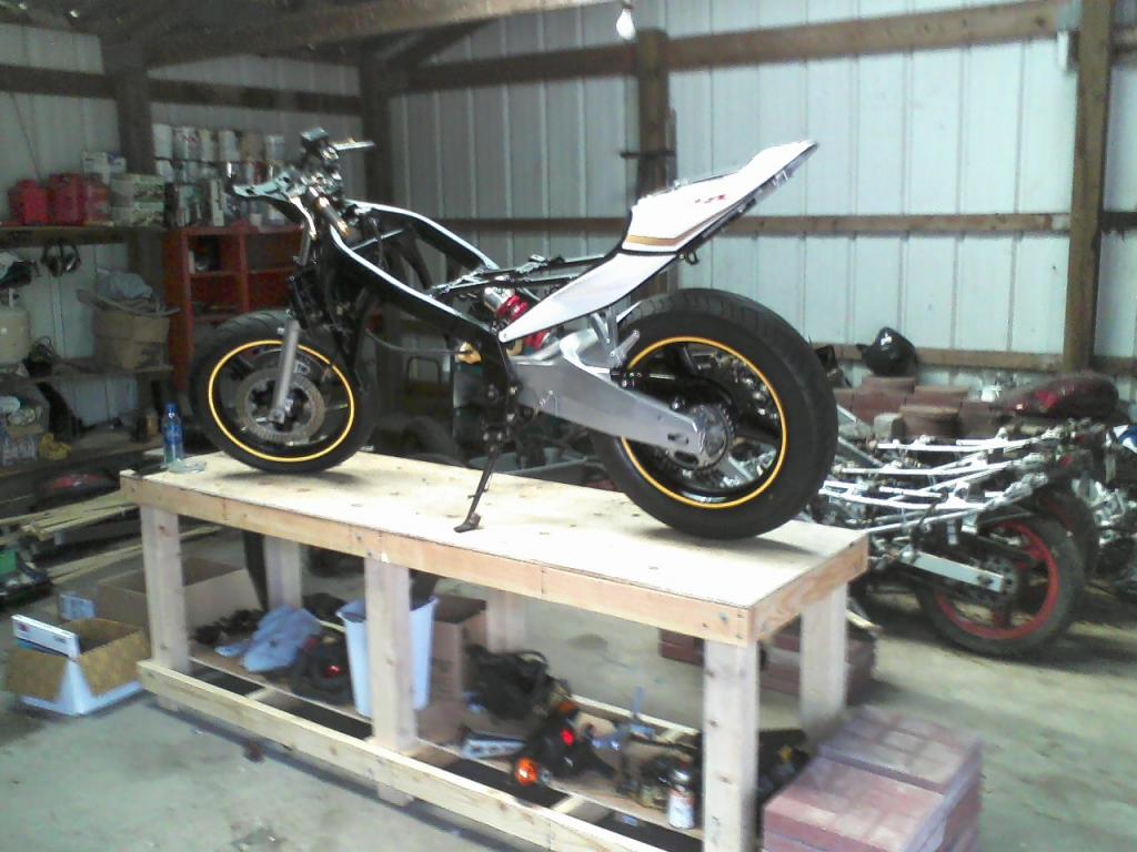

Here are a couple of pictures right after I got the front wheel mounted and the bike down on the side stand.
Then I thought I would hang the front fairing and one of the side fairings just to get a feel for how it will look. I'm prepping the engine so that will be going in soon.
I'm really pumped to get this baby together. It feels like it's taking forever, but it is turning out so nice I want to finish.
Hope you guys like it.

Looking great! I'm headed home from a trip and you make me want to go straight to the garage and get to work the minute I get back. Maybe we will be able to inspire each other to get these babies on the road before summer's over. That shock looks minty. What did you end up shooting on the frame?

This shock is a Progressive one that is like new. I decided to save the Fox Shock for the next one.
I used the VHT frame paint in satin black to try and emulate the RR frame color. I baked it at 200 degrees for 30 minutes. It is very durable. I went that route rather than powder coat for a number of reasons. All of the paint colors are trying to copy the RR. The silver on the swing arm and forks. The engine will be black with the same paint you used on the side covers.
I plan to put rubber edging on the fairings and the tank where they meet the frame to keep it from getting scratched even tho it's pretty tough paint.
