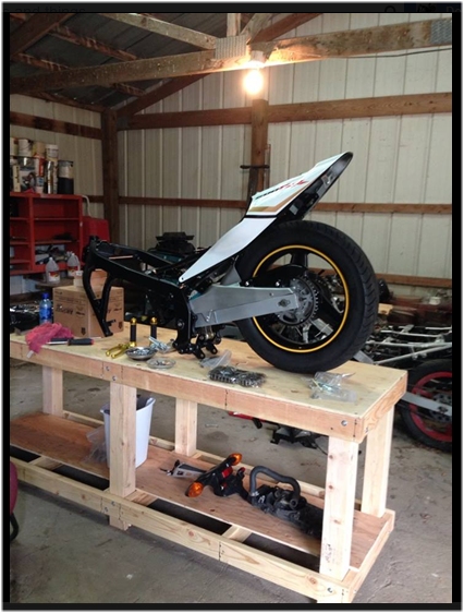

FINALLY!

Woo hoo! Looks great! That paint job is gonna look killer. I envy your ergonomic work bench. I spend a fair amount of time sitting on this silly little rolling garden stool thing to save my knees.

Your bike is looking awesome!
Yes I built the bench over the weekend. I want to have 2 of them in the shop. I am in my pole barn right now, but that is not the final shop. I have a bad back so need to have a bench that gets me at the same level as the bike.
