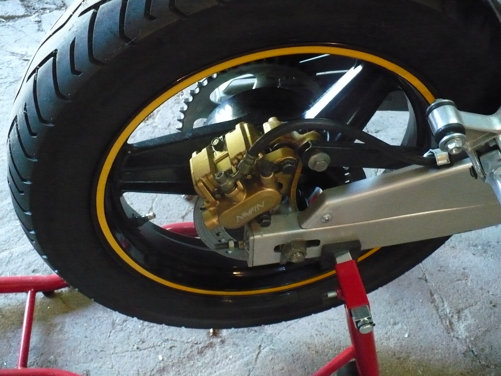

I got a cortisone shot to get me through until my surgery and was able to move well enough to do a little work on the bike. I got the rear brakes completely done, bled and working great. Rebuilt everything, new pads and I painted the caliper gold to get a nice contrast with the gold highlights on the bike. Turned out pretty good.

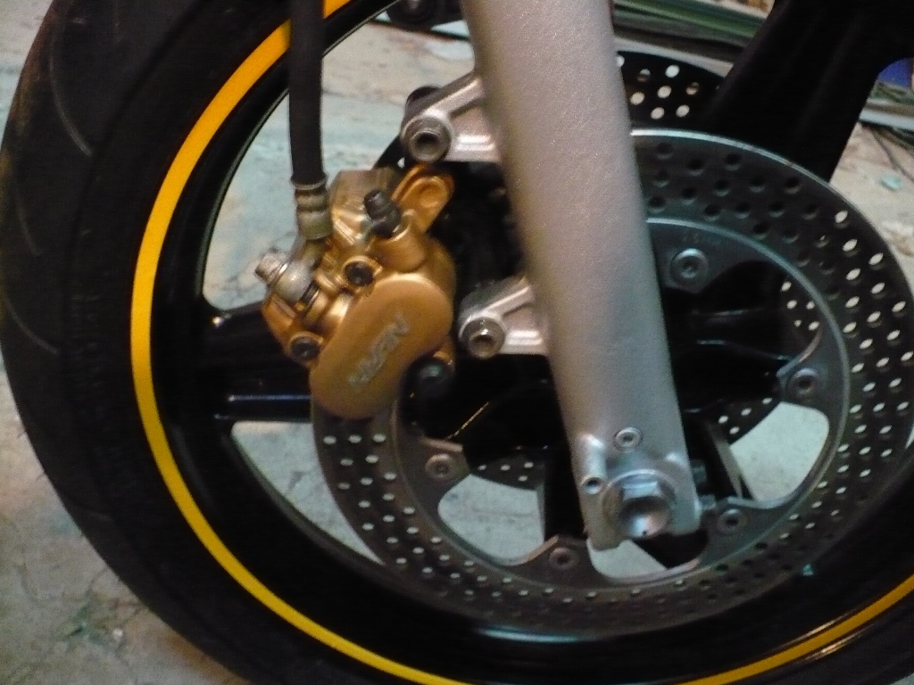

I also got one front side done, but still need to bleed the brakes once I get the other caliper on.
It was a lot of fun finding all the parts because the bike didn't have any brakes on it when I got it.
I'm going to add stainless lines at some point but wanted to try and get the bike together first.
Pretty happy with how the build is turning out and finally getting closer to getting it all together.
I'm also glad I put all new bearings, cushions and sprocket on the rear. Wheel turns and feels tight like new. Brakes grab awesome.

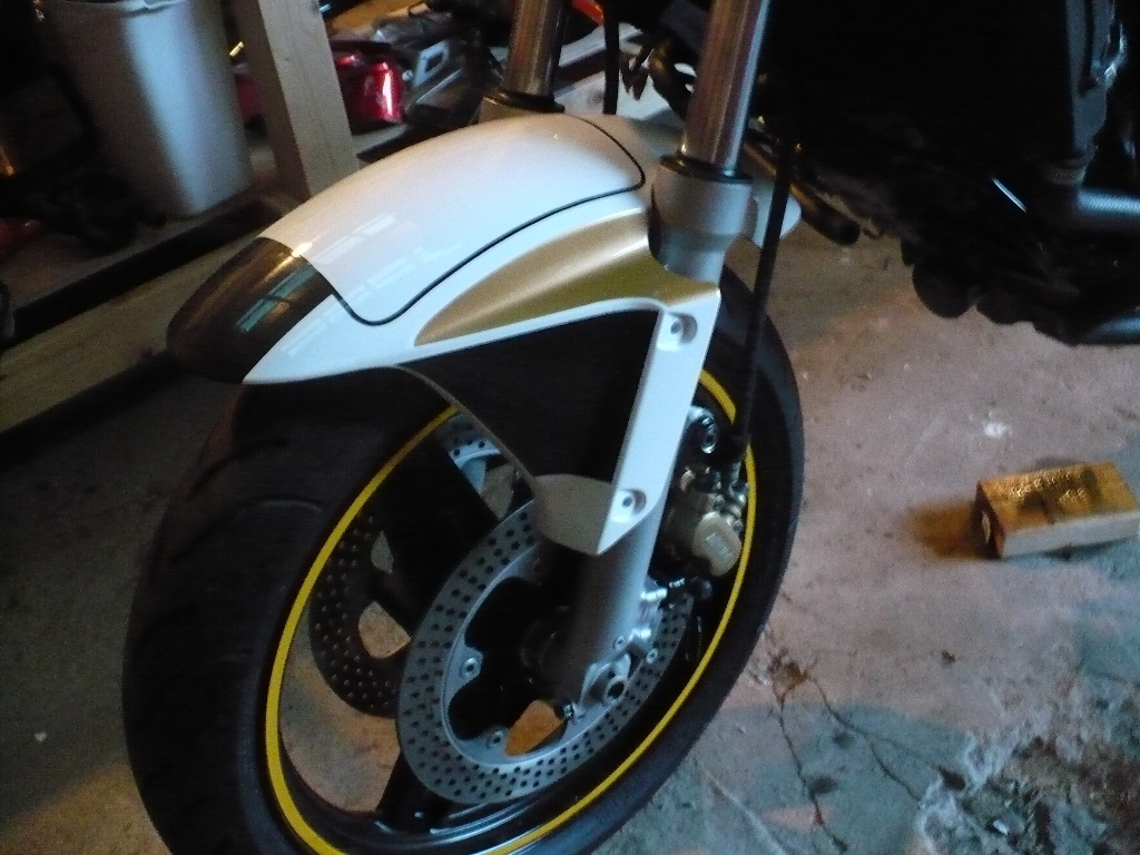

A little more work today. I got both front calipers mounted and plumbed, still need to bleed them but waiting because I need to pull the one fork tube due to a leak. I'm rebuilding another set of forks for the bike so these will go on the next build anyway.
I started working on mounting the "RR" front fender. I did some fits originally when I was fitting the fairings and thought the RR fender wouldn't work, but then decided there was a way to cut it down so it would fit. Very difficult to get this together because the RR forks are much wider.
My plan was really close but needs more work. I also need to figure out some brackets. The top can mount were the brake hose guide clamps are, but need to fabricate some brackets for down below.
This is the fit so far. Not too bad.
I think it will look more like an RR with the actual fender on it.

The gold calipers look great and take the look to that of later models. The fender looks good too. Can you squeeze in a bracket from the front mounting boss for the original fender, that runs down to holes in the RR fender?
