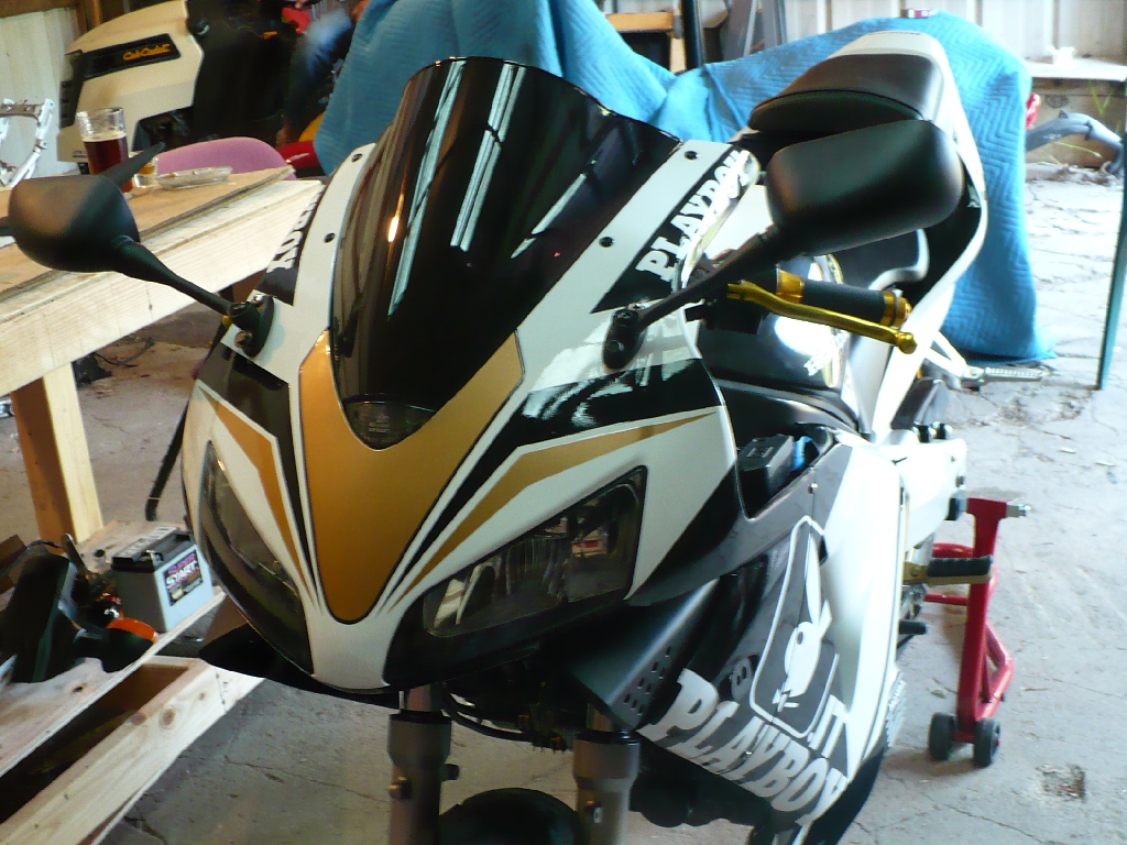

Front fairing close-up

Looks great! Not much to report CBR-wise here, except that I got my used Corbin seat. It looks great but rather surprised that it's more firm than the stock one even though it seems thicker. Does seem pretty comfortable in spite of being pretty hard.
