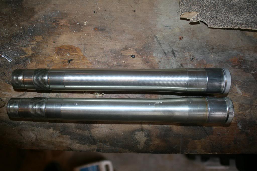

Anyways, here are the stems sitting side by side

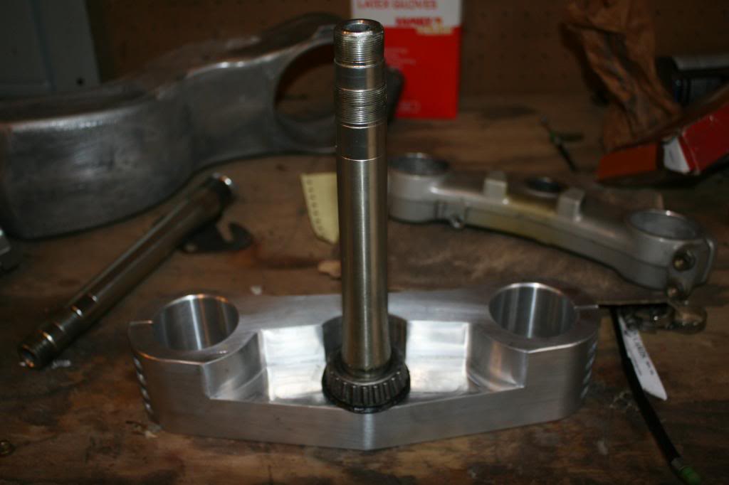

Here's everything pressed into my my bottom tree

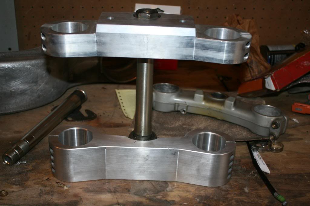

Here's everything all together. It looks EXACTLY how I wanted it to. Big and beefy!

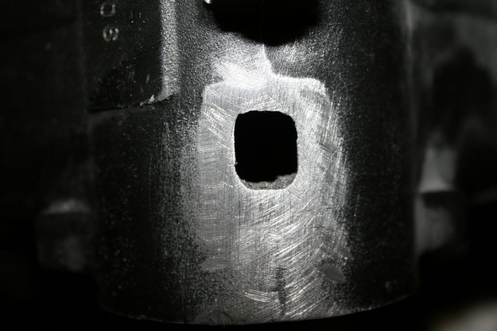

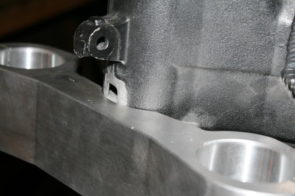

Here's what the frame looks like after I grinded off the tab. (Don't worry, it will be patched before the bike is on the road)

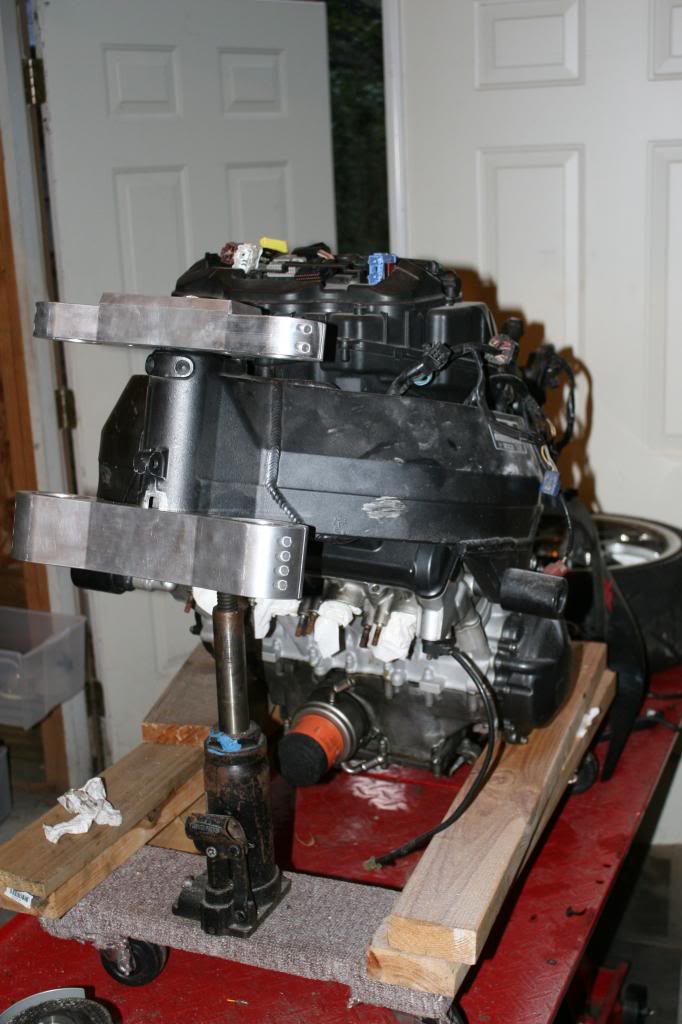

Here's the triple tree installed on the bike.

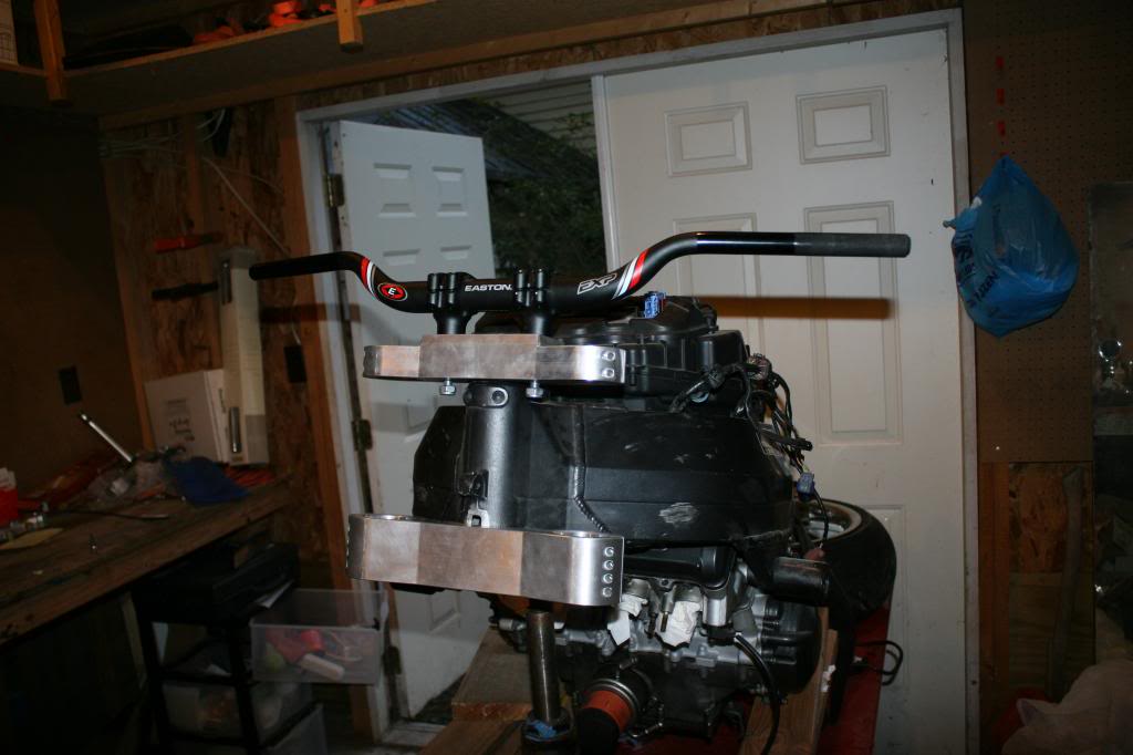

Here's what it could look like with the bars (although I AM switching to drag bars - so these bars are for sale - ask me if you're interested)
