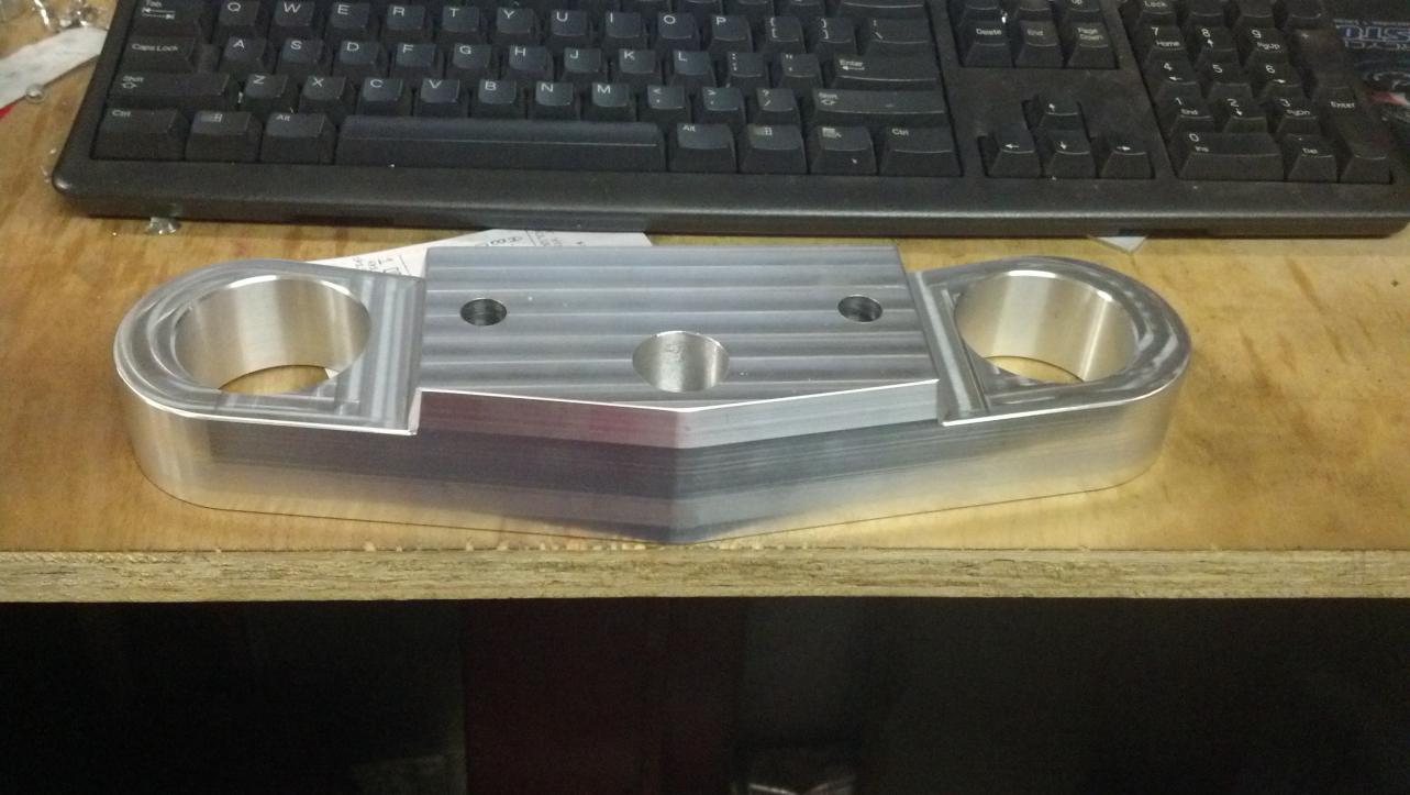

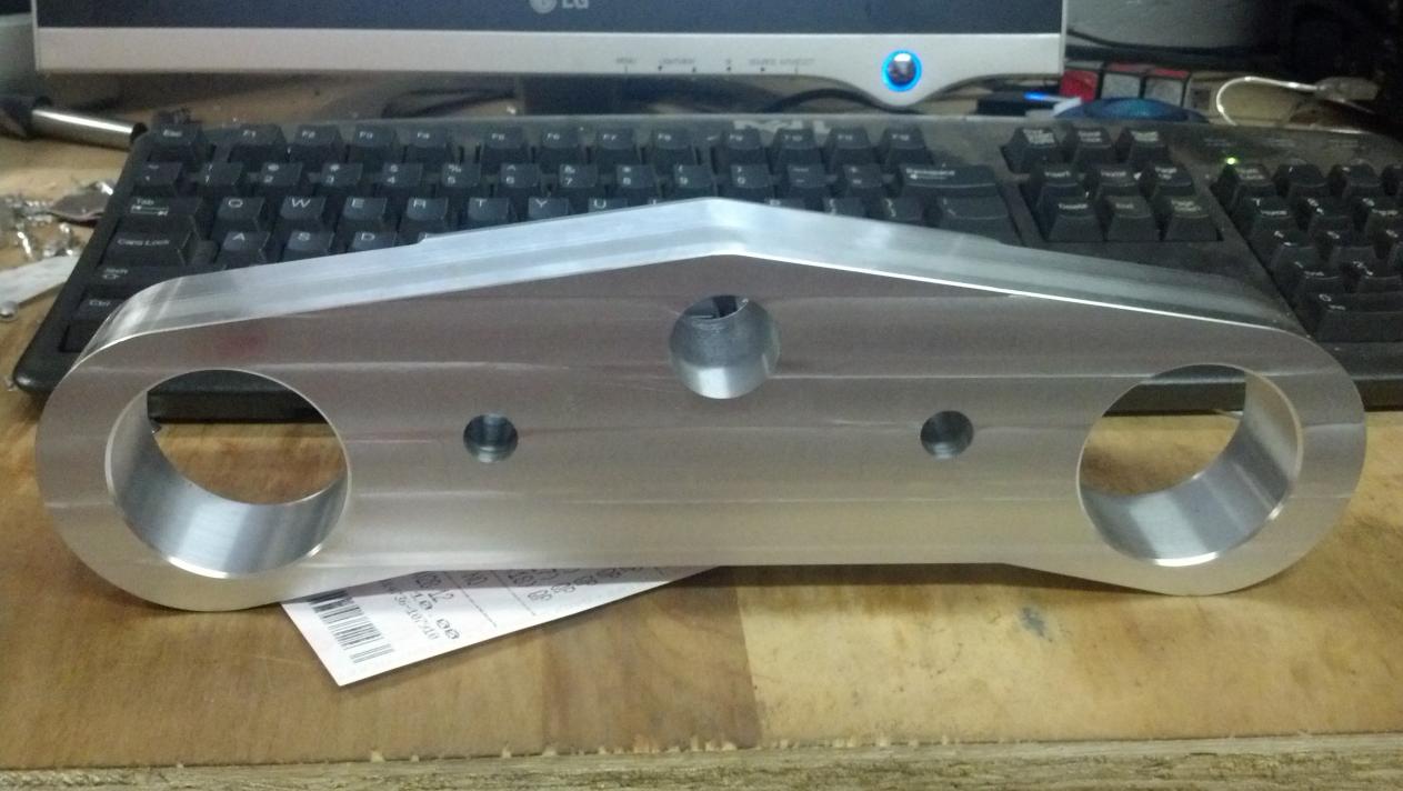

damn, sorry about that. i'll attach them. it's better this way so they don't make the entire thread hard to read. thanks for letting me know. these are some teaser pics of my top tree that diamondback designs is machining for me. it still needs a little work, before it's ready to go on the bike. pinch bolts still need to be added and a lil material needs to come off the bottom underneath by the stem, but other than that, it's BEAUTIFUL. i tell you, i have the motor sitting in the garage and all the other parts *almost* ready - but mike (from dbackdesigns.com) sending me those pictures really got me excited about my bike again!
