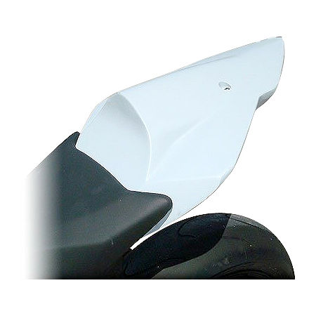

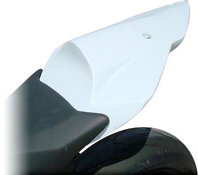

So about the tail, I'm leaning towards an S1000r race tail from hotbodies, and using a denniskirk integrated tail above the license plate as a brake light/turn signals...
That'll be the cheapest option the tail done. And I think I'm going to make the actual subframe out of steel. Later on I may change it to some sort of hybrid steel CF thing when I have the money - but with the tank being on there, I'm starting to really get the itch to ride it.
