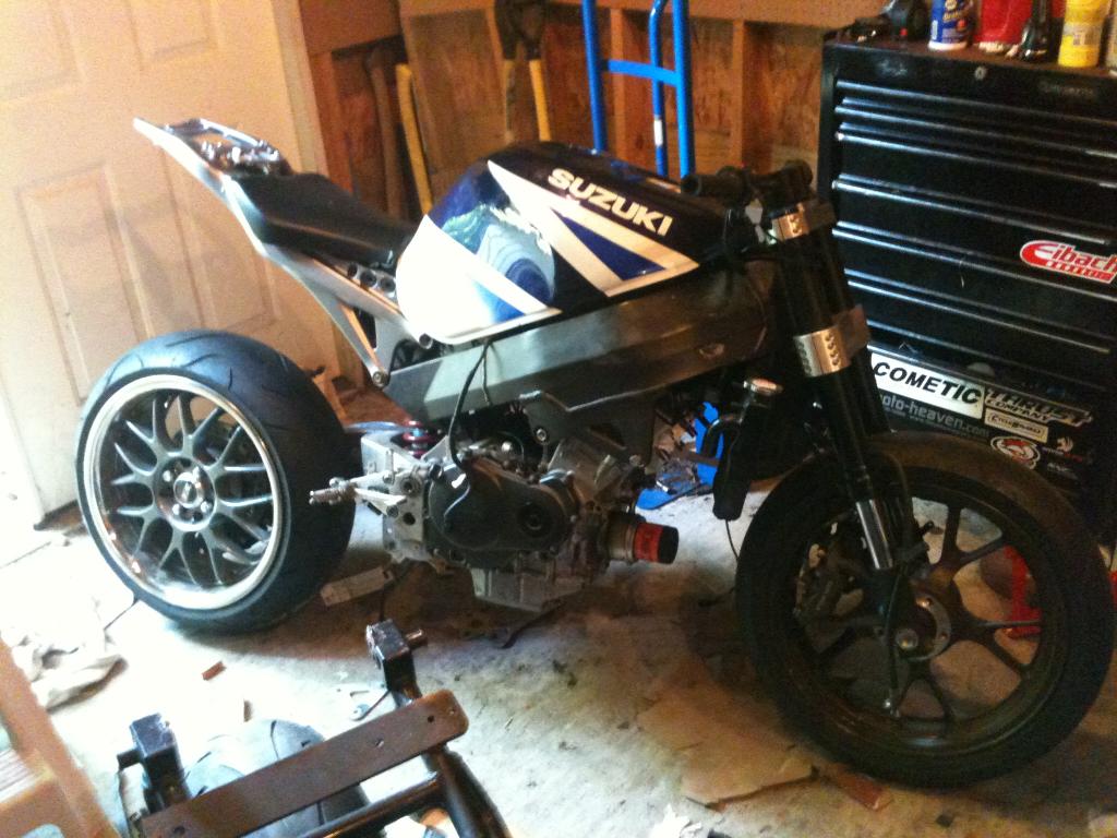

New stance.
Excuse the mess!
I drilled some holes in the 929 triangles to play around with the geometry a bit. I raised it back up to where I'm on the ***** of my feet (I'm 6'). I have the adjustable dog-bone on finally, and now I have absolutely full range of motion for the shock.
I have a 1/4in thick, 12x12 inch sheet of 6075 on the way to cut the new triangles out of. Also, I have a 2x2.5x12 inch block of billet 6075 coming for the front/top mount of the subframe. Basically, I'm going to cut into 2 pieces 6inches long. From there I'll build my mount for the subframe out of a 2x4 piece of wood. Once I have it built and ground down, I'm going to take the wood model and the billet to a friend that does metal work and has a lathe. Then I'll have the subframe completely mounted.
That's probably all I will accomplish before the move at the end of July (back to FL). I tried to braze the 954 gas tank mount onto the gixxer tank, but I was unsuccessful. I sold my O/A rig a few months ago. So my father-in-law sent me this "turbo" MAPP gas tip. We thought it'd be able to get enough heat to do it up, but I never was able to get a good braze, so it'll have to wait until I have access to an O/A set up in FL. It sucks when you spend a whole day doing work only to have it be a total waste.
