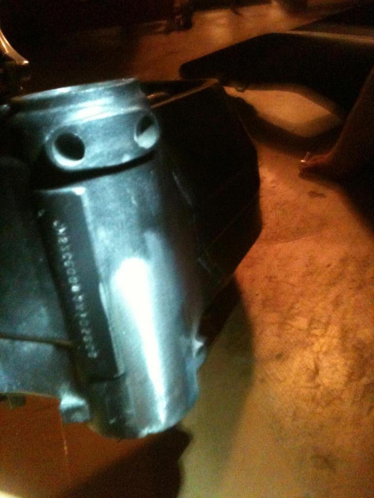

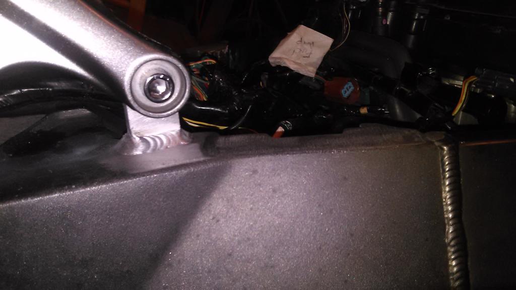

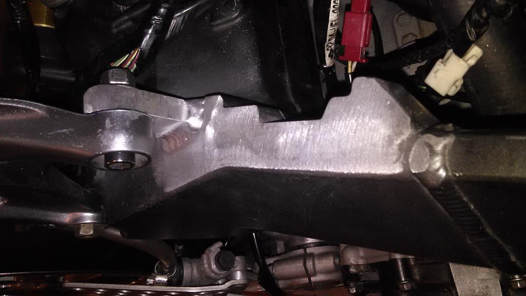

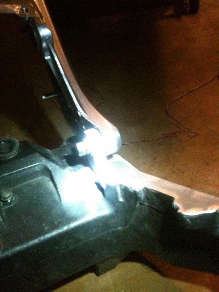

The frame is welded! (See? Wishes do come true at Christmas.)
1/2 inch solid aluminum tab welded for 1000rr subframe. And, 954 subframe mounts ground off and filled in.
Holes from front fairing stay filled in.
I shaved off the rear brake reservoir tab (which also left a hole) and the welder filled it in as well.
All in all, it seems like top notch work. I can take better pictures in the daylight, but I couldn't wait. The main thing is that for the first time - my bike's will be structurally built and ready to go. Thats big progress!

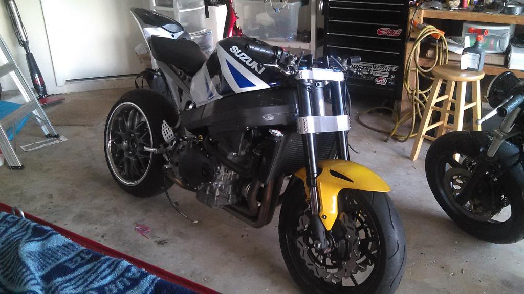

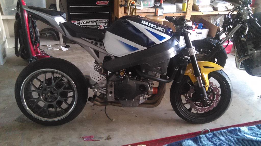

Hi Marco. The only updates are that I have the bike together again and am getting ready to order spacers for the front rim and spacers for the rotors. Im also going to be cutting the spacer for the rear rim to finally bring it inline with the bike.
I had that welder grind off the 954 subframe mounts. As a result, the gixxer tank actually sits flush with the frame.

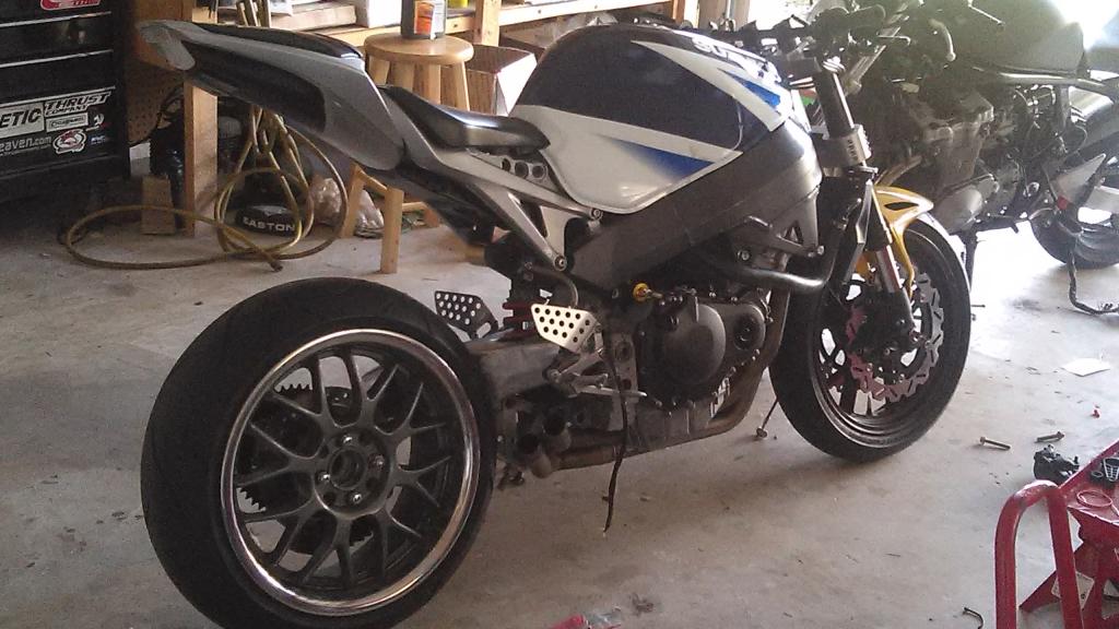

So now, the tank sits on like so
Much better. Also, I've retapped my clevis and reconfigured the slave cylinder to sit under the tank correctly. I have to order the bolt and bushing that I need because no one locally stocks an m8 bolt thats 160mm long. Then the hydraulic clutch conversion will be sorted.
As far as the questions:
I used 08+ 1000rr everything ( TBs, airbox, harness, ECU, etc). You have to modify the head to accept a hall cam sensor. The airbox is too tall for the 954 gas tank to work, so I used a gixxer tank, and its fuel pump because it is configured similarly to the 1000rr as opposed to the 954 pump.
If you wanted to do it relatively easy, use 04 07 1000rr ECU, airbox, TBs. The 954 shares almost all of the sensors as that generation 1000rr. I still doubt the tank would fit however. There was a guy on fireblades.org who ran it on his 929 with the front of his tank propped 10mm or so via bushings.
