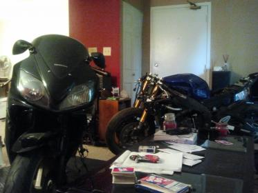

They all do my wife dealt with me not having a garage for a year and I finished my r6. Love her for it .

Old Jan 23, 2015 | 10:10 PM
  #335
Conrice's Avatar
Posts: 6,146
Likes: 37
I was able to build my motor imside with the AC this go-around, and I'm thankful for that.
But yeah, I get scolded like the dogs do when there's a handful of parts on the dining room table nowadays.
