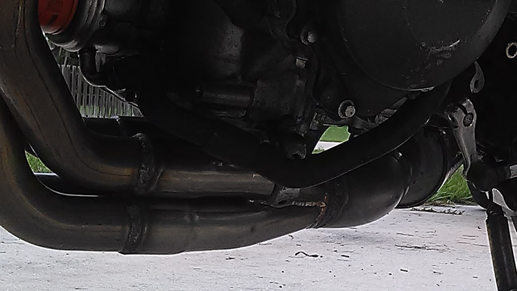

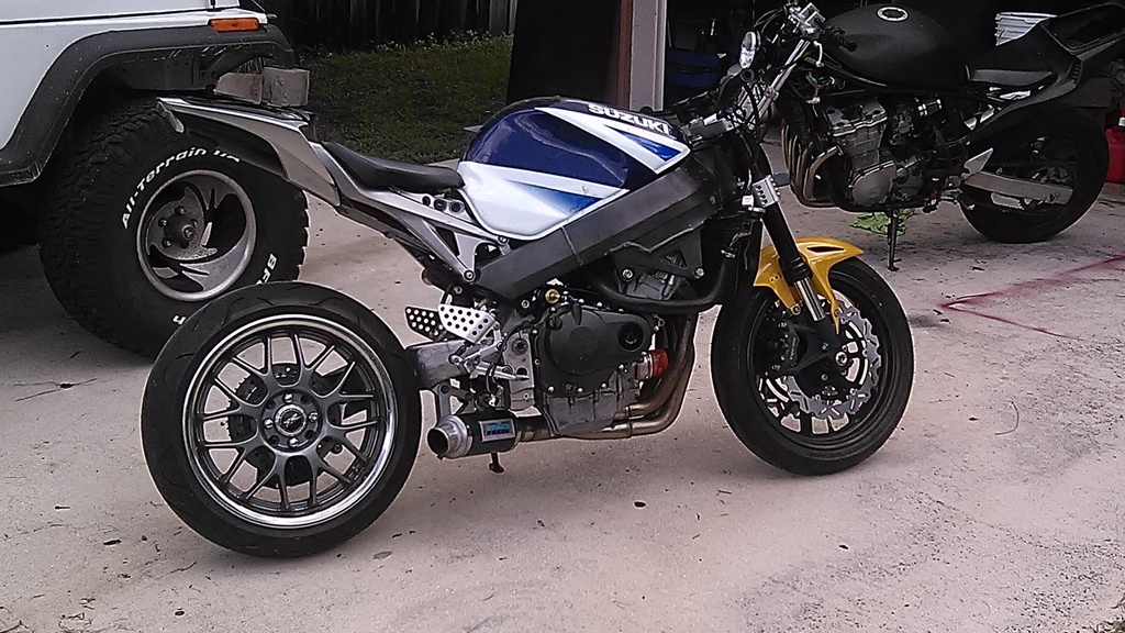

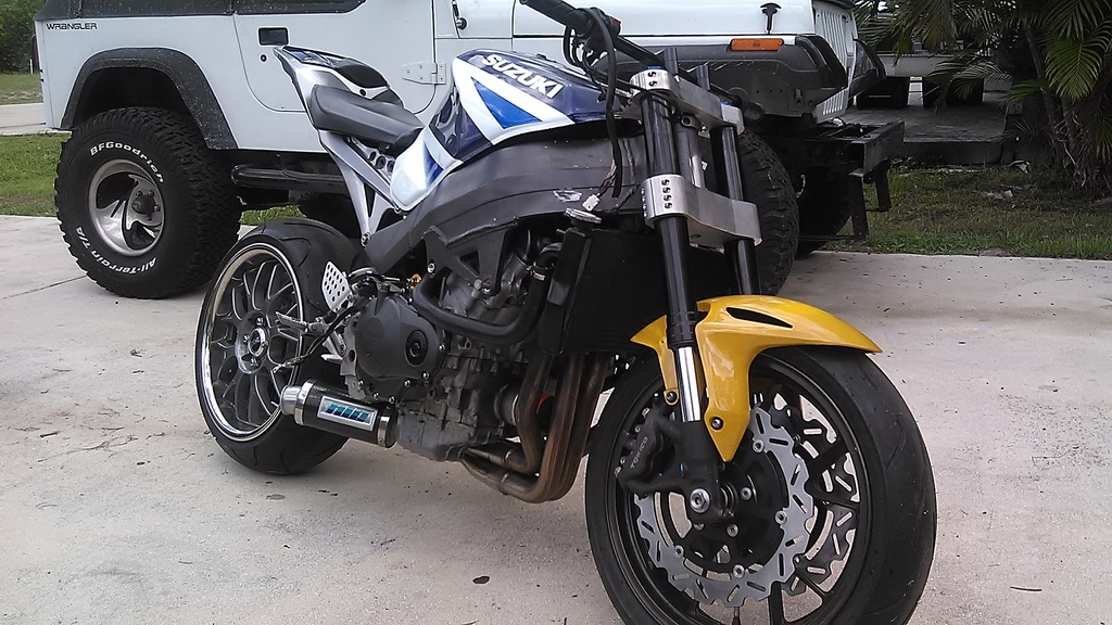

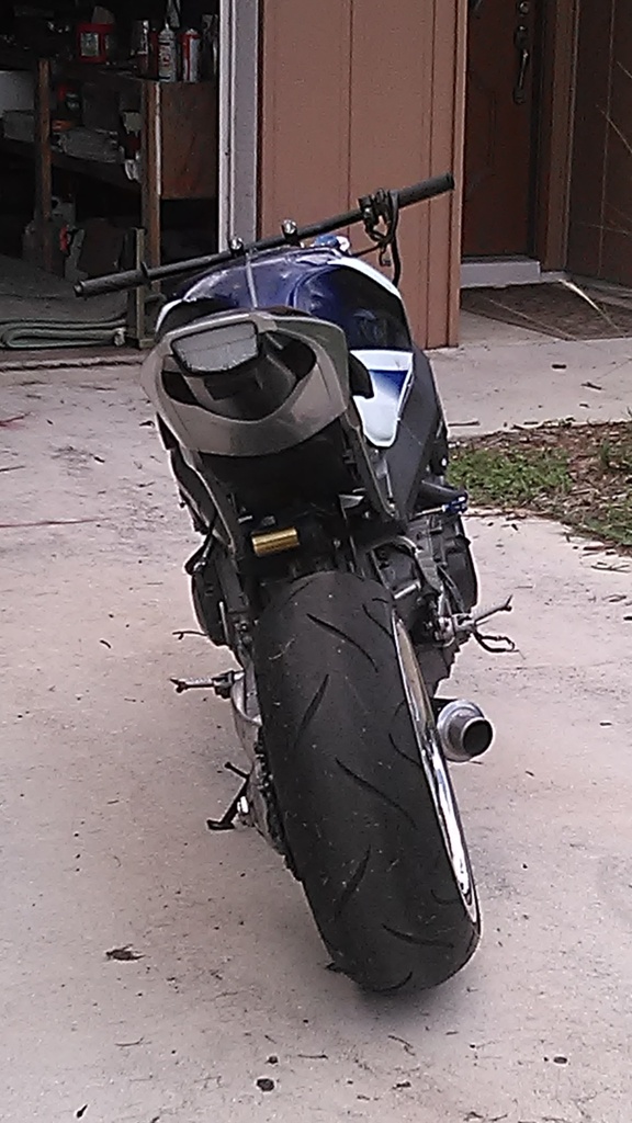

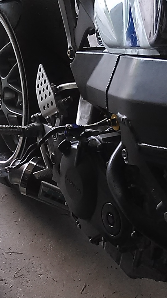

Alright, so I have the bike back.
And it looks great.
The rear wheel is about a half inch off center, but no worries as I am getting my wheel spacer made while I figure out the wiring.
Off center rear wheel
Custom collector.
Clutch arm for hydro-conversion

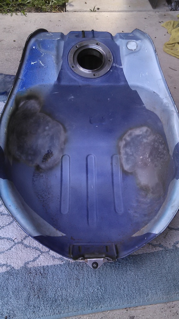

So, the tank still didn't fit perfectly, and I could feel by moving it around, that it was getting caught up on the edges of the air box/secondary fuel rail.
So, after some heat and pissing of the neighbors....
Now it fits perfect on there. I knew it wouldn't take much since it was close, but it was off by just enough that it would drive me nuts.
