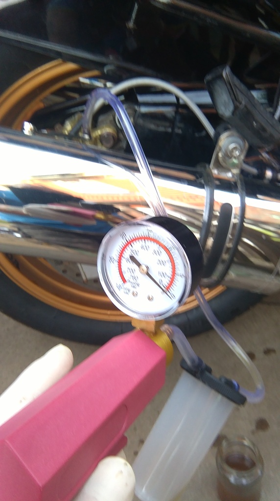

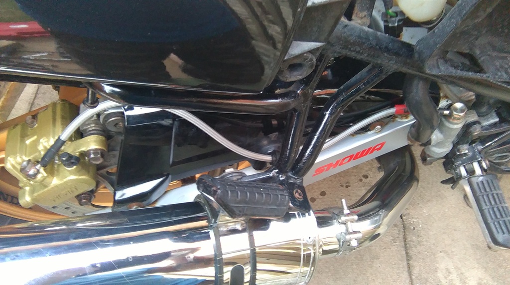

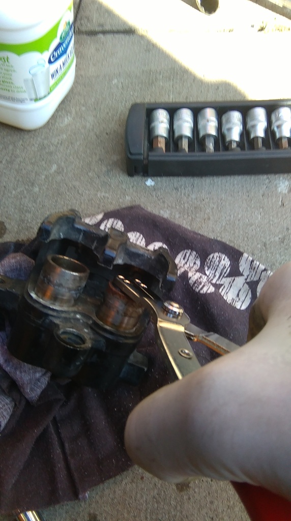

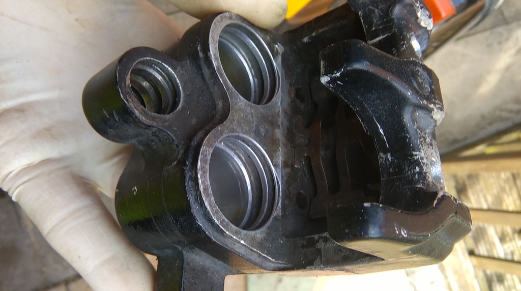

got out in the shed the weekend and fully rebuilt the calliper and added a new rear braided hose, and got a chance to use me new brake bleeder and piston pliers
