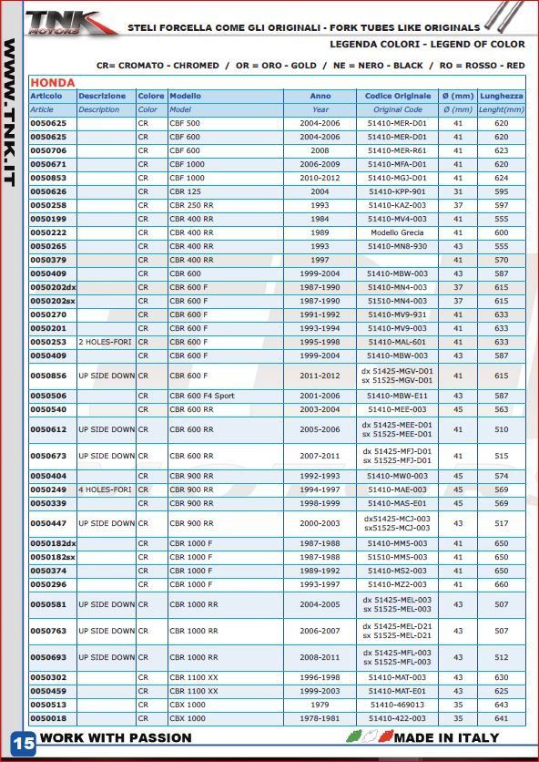

a question
I have a cbr1000fLfrom 90/91
the fork stanchion is scratched by grit and leaking
the official part nr is
51410MS2003
as from 2003 the part nr is
51410MZ2003
so the same part nr but the letters specifying the material are different
the question arises as there is the latter can be had on the bay as new old stock and may come in useful
visually on pics and the basic specs of dia 41x650 long are the same
my question is are they really plug and play interchangeable???
greetings paul

Dont know if this might help you, left the whole page up so you can see where I got it from, used it myself to search for substitute stanchions , there's 4 at 41mm but the last one is plus 10mm

thankyou for your list
it gives the same details as per my mail above with just the material suffix ms to mz changing
ill go to honda to a old mechanic to see if he has an idea
reg
paul
