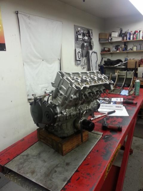

well the head is on the bike and everything is turning great with no problems. so far so good. Put the engine back in the frame before i drop the cams in. these intake port looks real nice. I was worried about the spark plugs hitting the heads because the head is milled but they cleared nicely. heres a nice before and after pic i mocked up

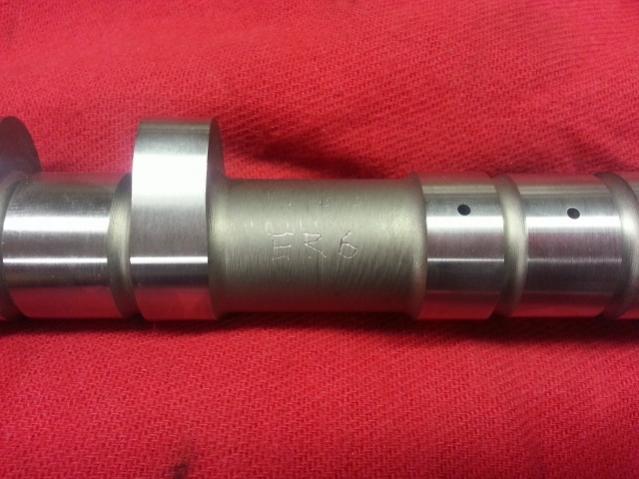

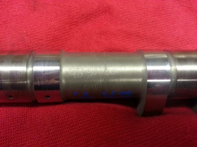

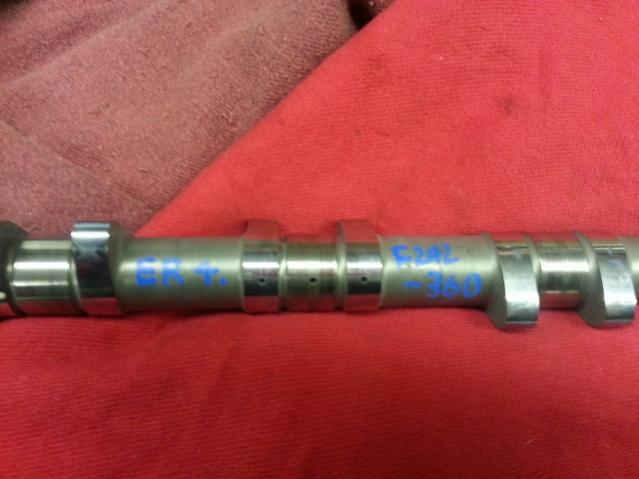

heres some pics i have of the cams i have. i contacted crane cams to try and find out the specs on them. just waiting to here back
