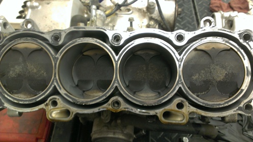

well to start the compression ratios in cyllinder 2 and 3 were under 100 and 1+4 under stock. Head gasket was shot. Well get to the knocking that was coming from it later

as you can see the biek was running extremly rich. i dont have a picture of the spark plug but the irridium was actually gone. As for the head it deffinatly needed to be bored with as much the pistons were groving the walls. gotta love the new 4 training wheels she has
