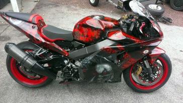

Default Long overdue updates
Hey everyone. Ok. I have alot of catching up to do but I wanted to post some pics of the way the bike looks now. Having some issues with the motor that I will explain and diag. Soon. Stay tuned haha.
Old Sep 16, 2014 | 08:33 AM
  #166
mrsmobbins101's Avatar
Posts: 192
Default Pics
Many new mods
Attached Thumbnails 2002 CBR 954 RR Rebuild-img_29509513364217.jpg   2002 CBR 954 RR Rebuild-img_29512193790518.jpg

I'm curious to see what the engine issues are, glad to see you back. The bike looks good. (and that's that GSXR scorpion system still, right?)
