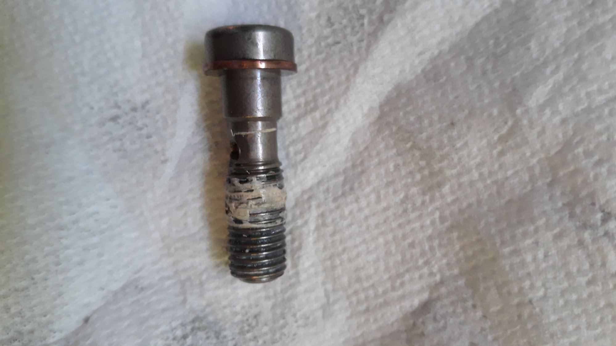

This is what one of the cartridge bolts looked like, no wonder it was a pain to remove. I don't know what the white stuff is but it was pretty hard. At first I thought it was "aged" loctite but now I'm not sure. I wouldn't think this is OEM so others will hopefully have an easier time of it.
Old Feb 1, 2022 | 02:30 PM
Well it doesn't look like it took any threads with it, so that's good.

Yes, both bolts cleaned up nicely and the threads in the cartridge look intact.
