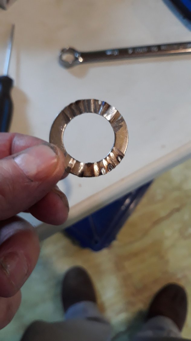

So it turns out the OTHER side was even more problematic to disassemble, heat alone on the fastening bolt didn't work.. I had to find an appropriately sized washer, scar it with radial cuts from a cutoff wheel (to make some sharp edges) then position it between the clean spring and lower seat. I used max preload and placed all my weight on the fork to get as much load on things as I could, then it finally loosened with an impact gun. There doesn't appear to be that much thread sealant on the fastening bolt, not sure why this task was so hard. Seals on hand but I decided to change bushes and those are on order. I'm also changing out fork springs, maybe those are a bit weakened.
