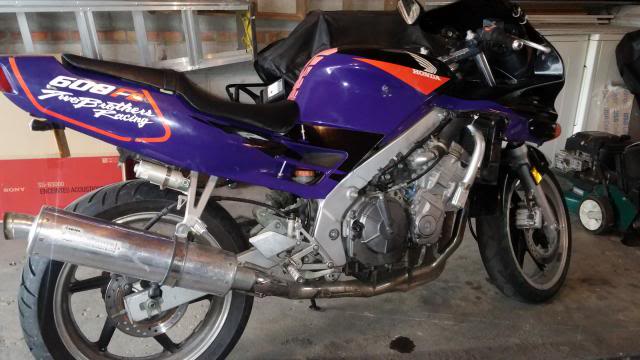

heres my project
needs new front tire also from dry rot. for some reason the brake lights dont work, will have to check all that out. it too has 36k miles. runs well, but not gonna push it as much as i did my other bikes lol. like i said good luck on your project, judging by the work you already put in it, itll look great
