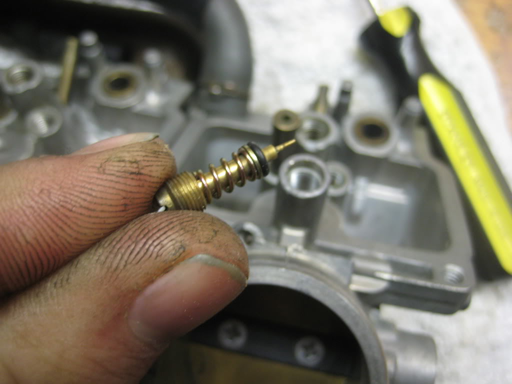

So i got busy putting the carbs back together
This is a SUPER TINY o ring on the needle.

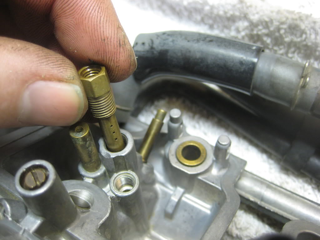

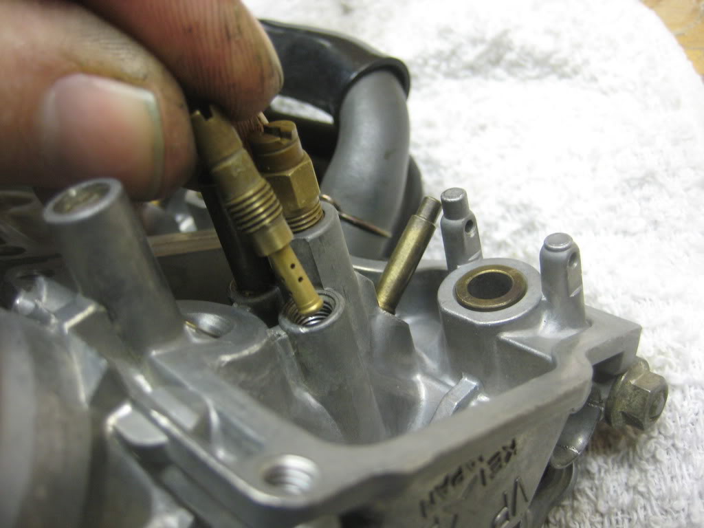

then the jets went back in

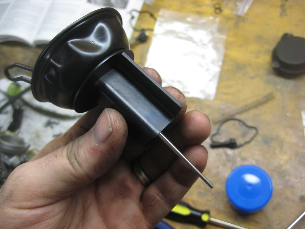

i used a piece of .005" music wire to make sure all the holes were open, but they were all pretty clean.
Then the floats went back in. you don't set the height on these! they haynes manual says "if they are out of spec, replace them" so i was very glad to find them in spec.

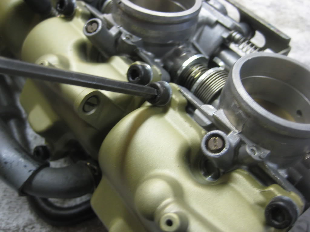

I also replaced the hardware on the carbs to get rid of the stripped out phillips heads.

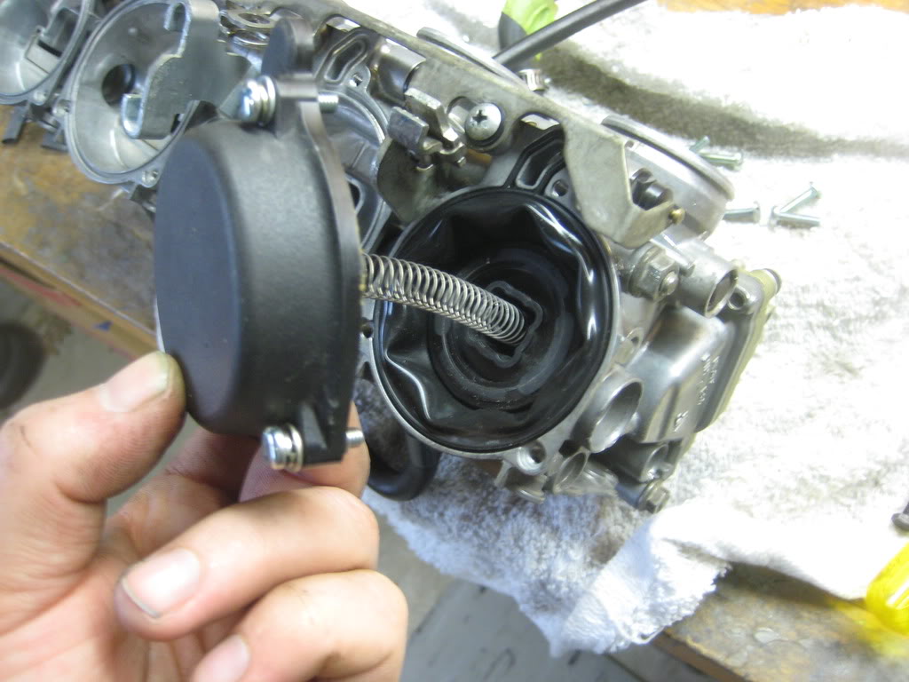

got the diaphragm and needle assembled...
and installed. (careful these springs will fly across the garage and roll under the tool cabinet)

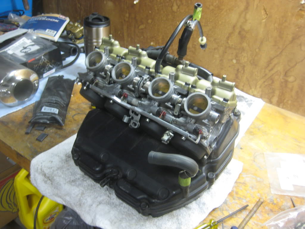

and got the modified air-box on. ready to go on the bike

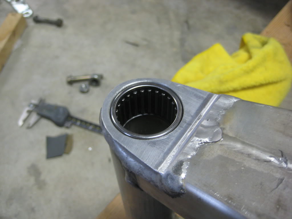

I also got the needle bearings in the mail then in the swinger

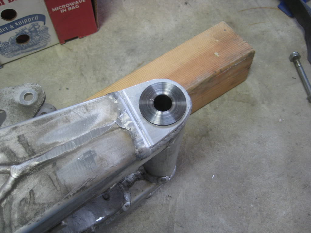

some custom oilite bushings...
and... not to brag.. but i think that is HOT! sorry for the blur.

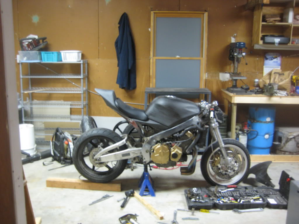

now i cant decide about the shock. i cant really mock anything up either because the stock systems interfere with each other. i am going to go with a progressive linkage system, but i cant decide if i should keep the f2 frame mount, or go with the swing-arm mounting point, though i am leaning towards the swinger so i can upgrade my shock, i just think it is less attractive.
thoughts?

since the F2 mono is non remote resivior, it might be cool to switch to one off a newer bike , it looks trick so far man. whatcher plans to relocate the F2's mount?

the 94 F2 had the remote res. shock that carried thru the F3 generation.

i have been playing around with several options.. however i will most likely keep the stock shock set-up but upgrade the shock and modify the swinger to work.

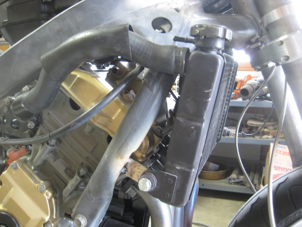

I got the tabs welded (at least tacked) for the radiator supports

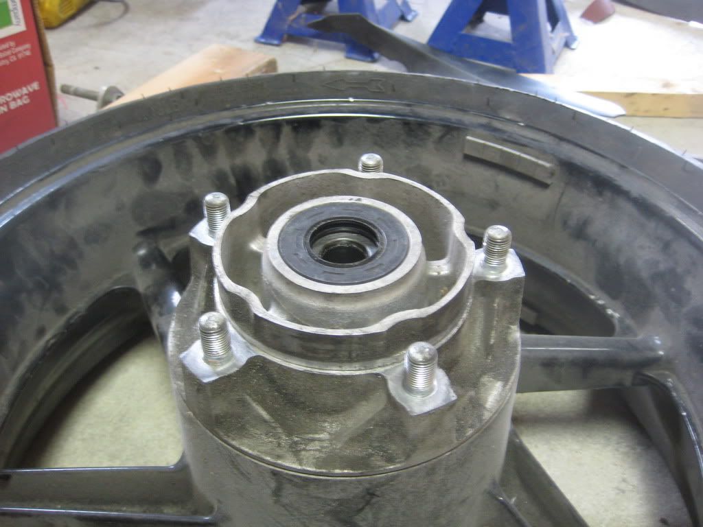

and now... how do i remove these studs?

I just pulled up the service manual for a 96-98 900rr and looked at the drivehub info there. The manual shows the back side of the drivehub to be hollow where those studs are. Are they just pressed in like wheel studs are in a car's brake rotor or drum?
I found an image of what I'm talking about - but it appears that the studs are inserted into the hollow sections on the backside, right?
Old Feb 10, 2011 | 09:53 AM
yeah.. i pulled the hub off and there is no way to get at the studs from the back-side. i talked to another honda guy and he said that they are threaded and i can weld a nut on them and spin them out. (i hope) gonna try that. i will keep you posted.

yeah - I just found that - they're just threaded studs. looks like 12x25 threads - good news, replacements are cheap if you wanted to put studs back in after you machine the flange.
