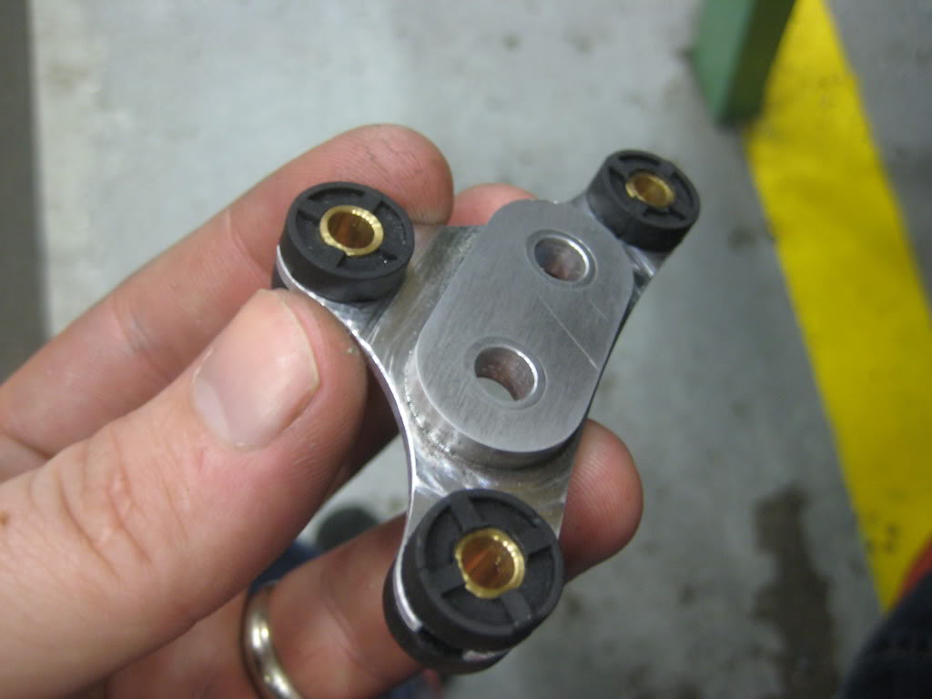

I have been planning my chain slider..

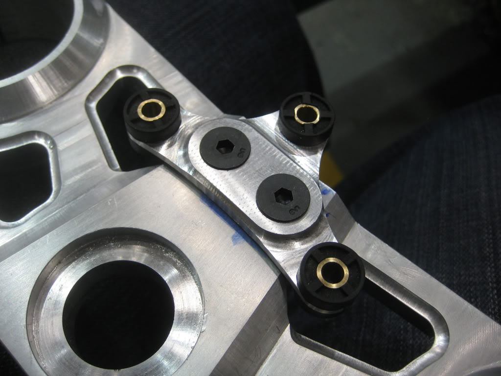

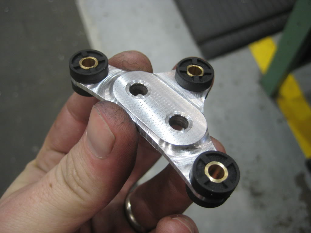

and got a prototype of the speedo mount
then finalized the design.
and mounted it to the triple
it is a pain to get the speedometer on there, but it is rock solid once you do.

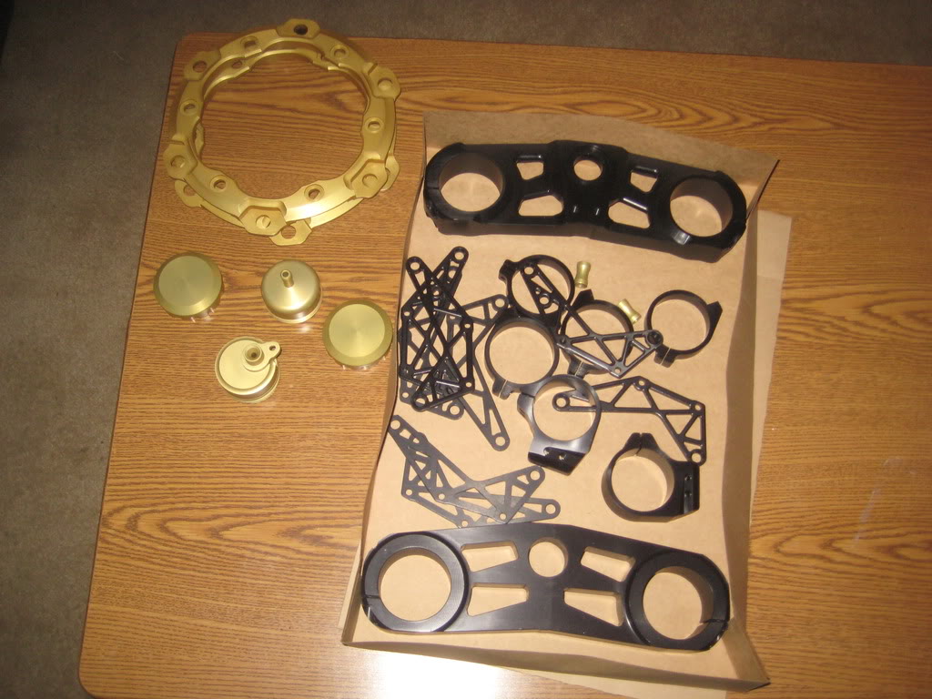

got all my parts back from anodizing...

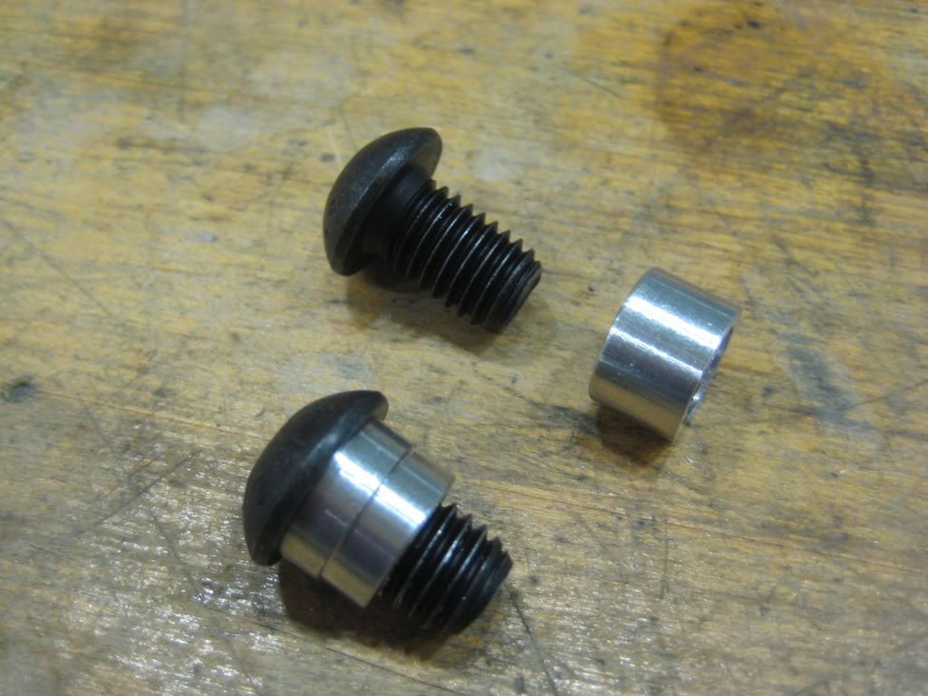

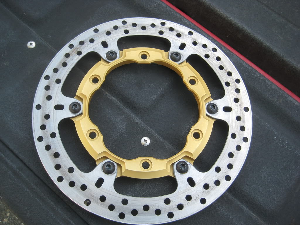

what happens when you are a cheap-skate and wont buy 12 $4 a-piece sholder bolts?
you make them yourself!
the hardware is 18-8 stainless with a pressed on alloy shoulder, and the nut tightens up 0.03" from the shoulder.
the shoulder is a 0.005" slip fit for the holes in the adapter and the rotors for zero shift or rattle. even without the nuts it wont rattle or shift. very happy with it.
