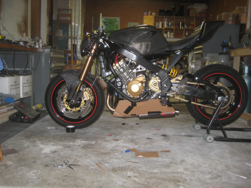

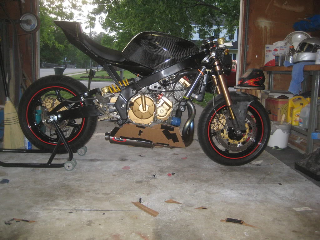

okay... got the shrouds fixed. (i think)
gonna make a couple sets. i have thin alloy sheet, alloy honeycomb and carbon fiber honeycomb. i know it is still right next to the can, but i need it like that to line it up for the brackets (which will be Titanium) then it will get cut out.
