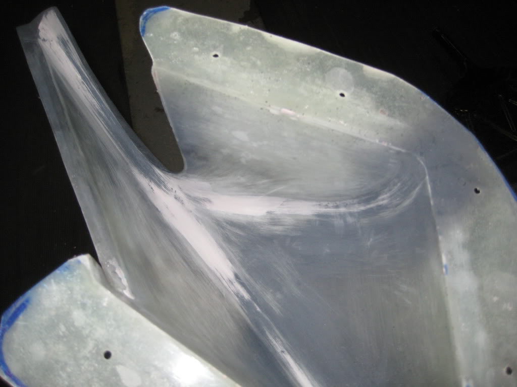

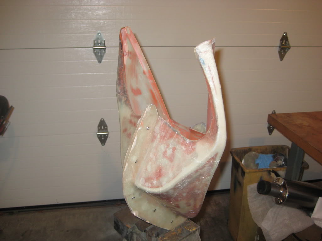

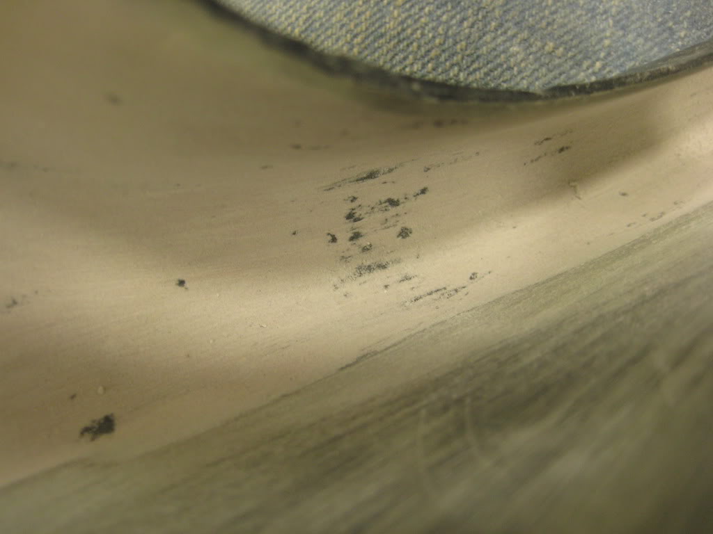

I got the mold sanded, and bondo'ed then i sprayed a little primer in there to help me see what i was doing.
The primer goes into all the dips and mistakes...
so then i sanded it smooth (this goes for both sides)
a little bit more primer, and sanded to 1200 grit, then 4-5 coats of wax, bolted together then PVA. in other words, ready to lay up the carbon.

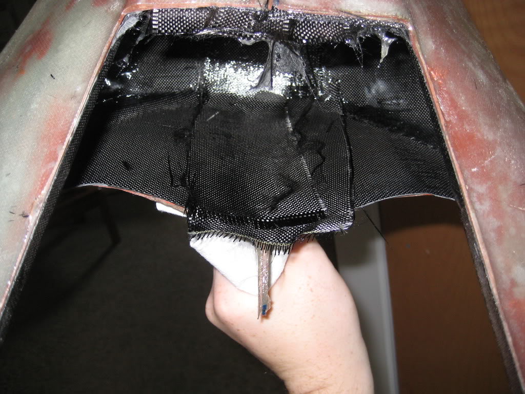

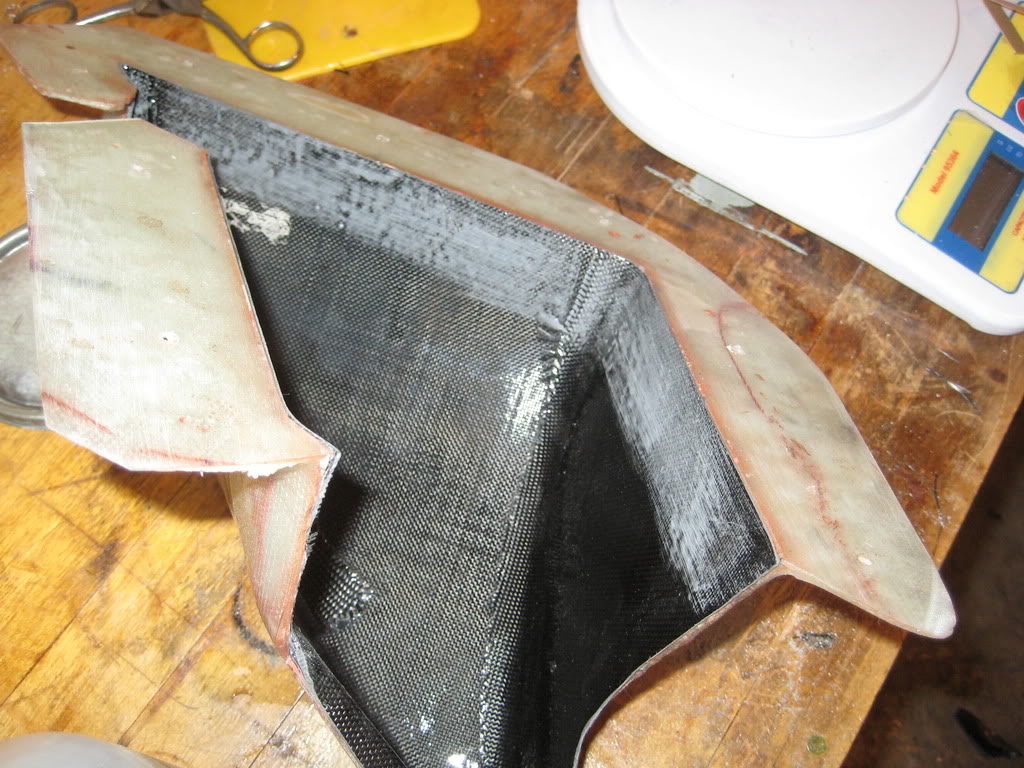

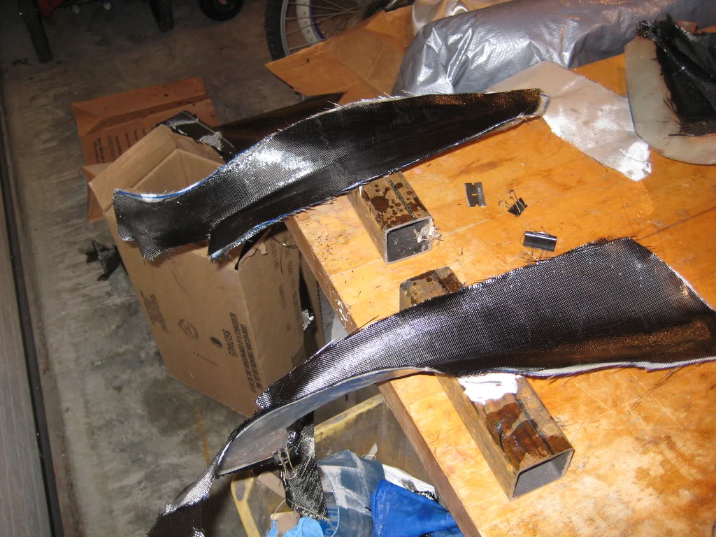

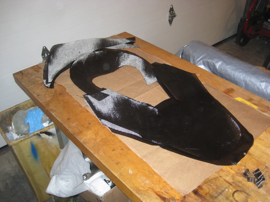

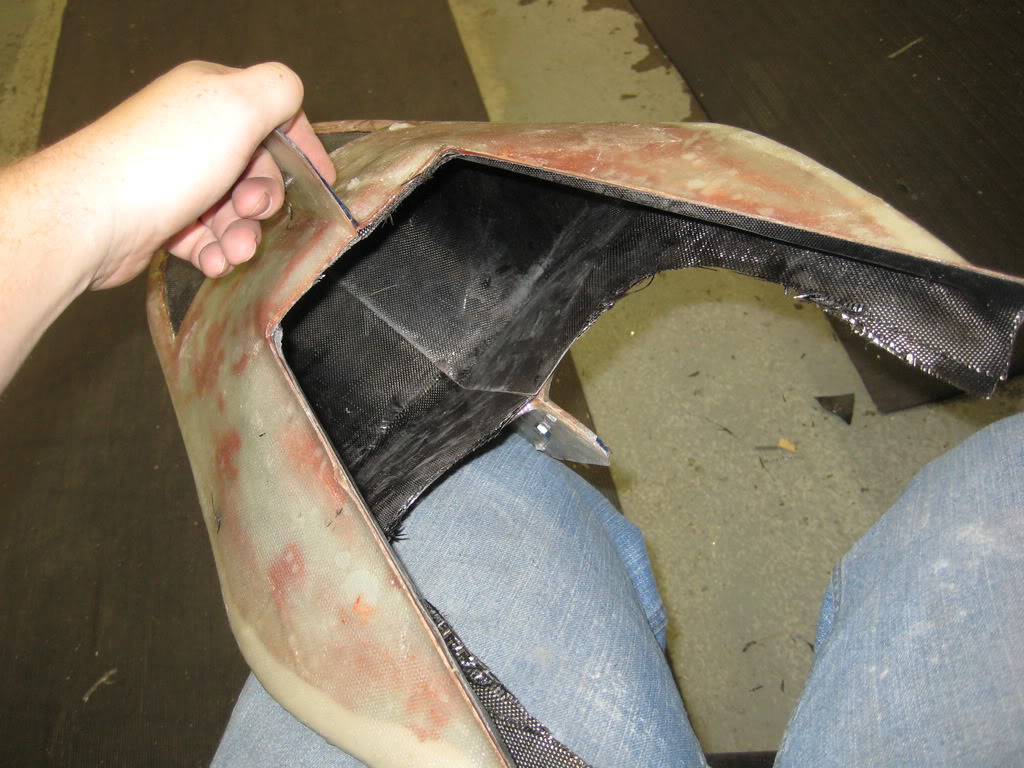

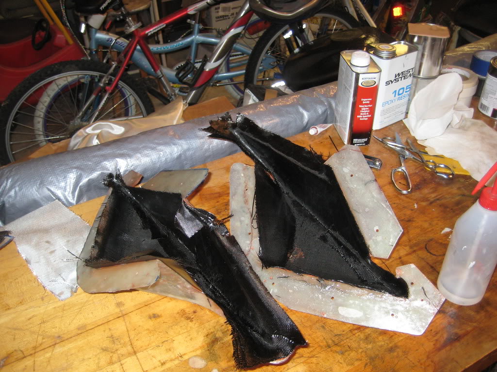

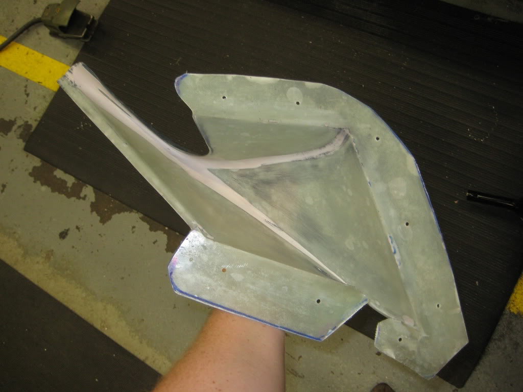

And then.. disaster struck. I had already practiced laying up the carbon inside the mold with the brown paper templates, but with the resin, the cloth was unmanageable.... so i ended up cutting the peices in half and laying the parts up sperately.
This will add a step, but the parts will be better.

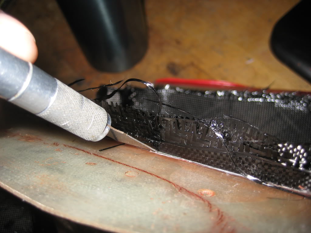

so... they cured, and before removing them, i used a razor to mark the exact edge of the mold on the part.
then i popped them both out

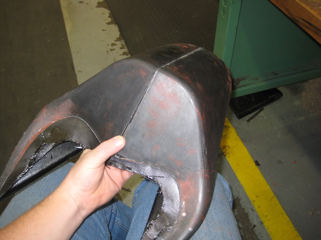

I trimmed them to the line, and viola! here is the tail. (it is going to need some sanding.. dont worry, the red will come off)
so then, i will bolt the parts back together and run carbon down the seam.
The benifit with this is that i will do twill for the next tail, and it will look even better with a seam down the middle. i can get the pattern to mirror itself.

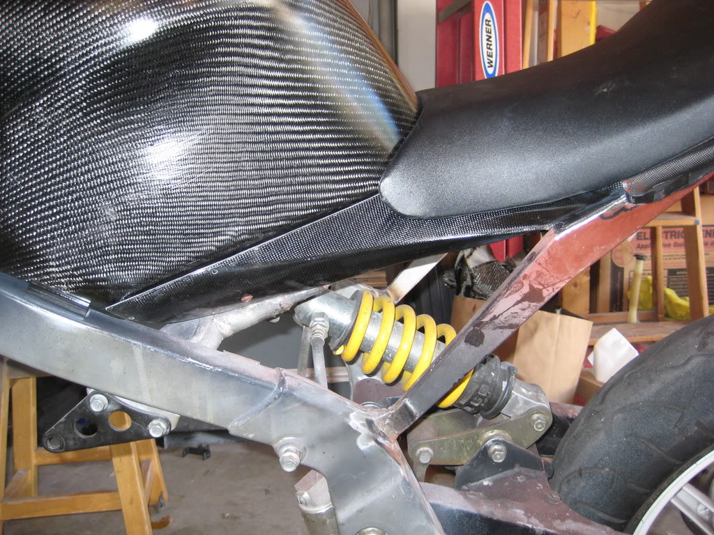

I also put another layer of Carbon on the side covers to make them a little siffer.

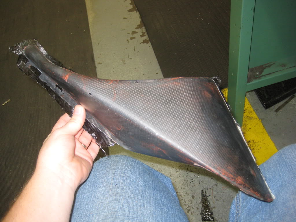

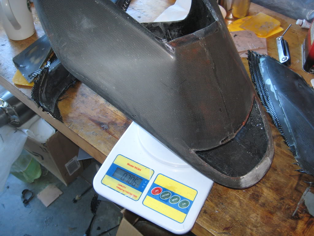

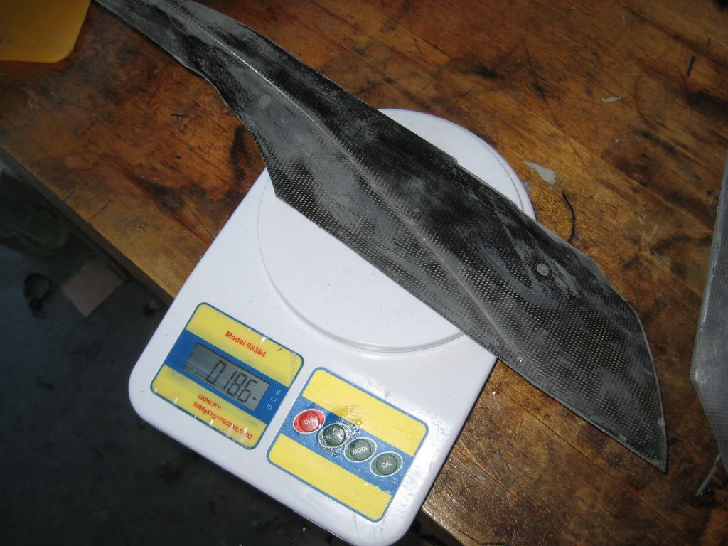

So then, the next day i took it out of the mold and cleaned up the join line. The pat is extremely rigid... and light. 0.7 lbs to be exact.

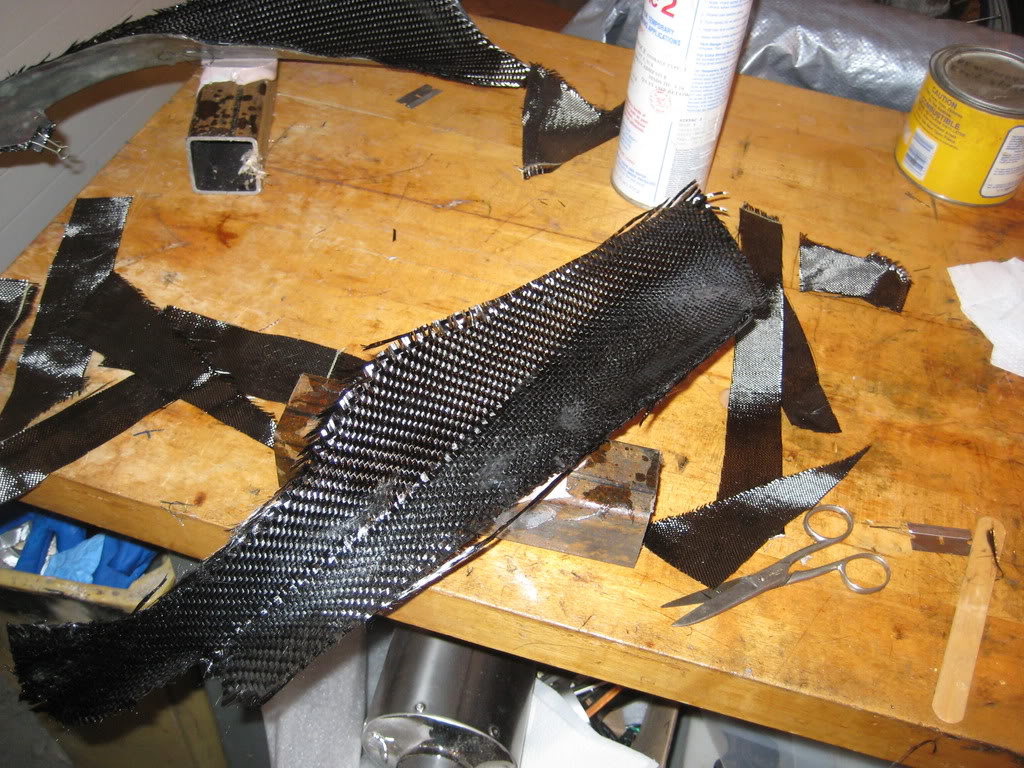

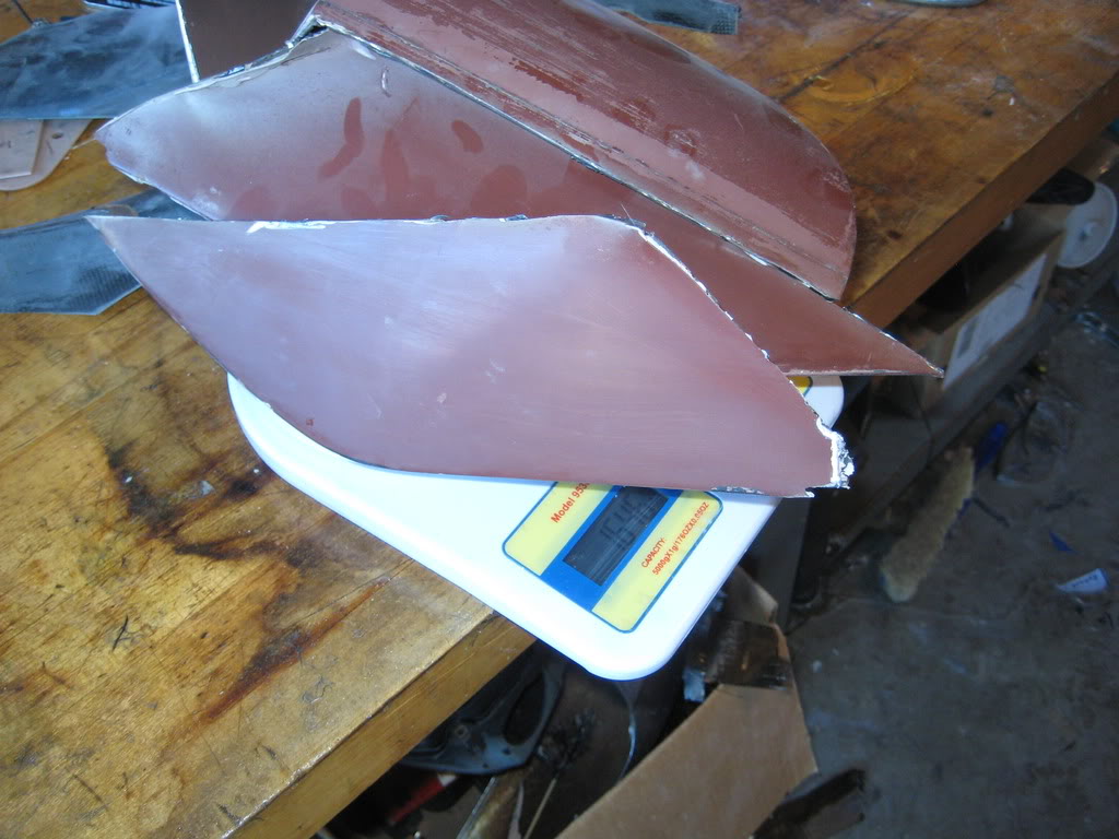

and compared to some of the stuff that i cut off the tail...

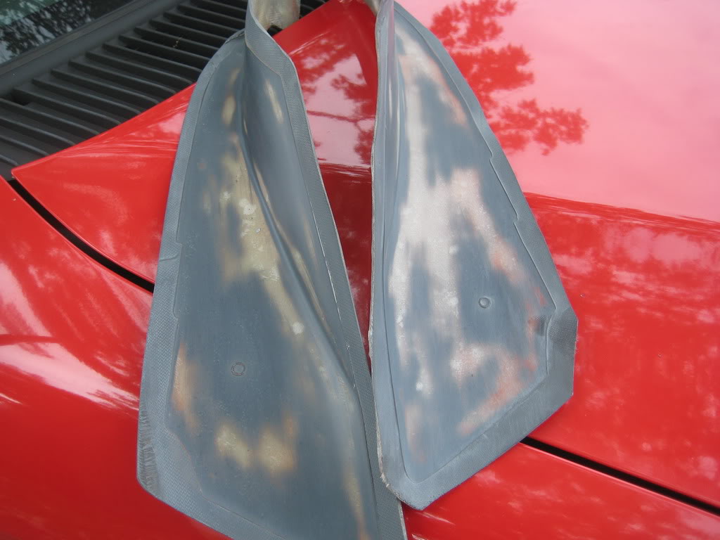

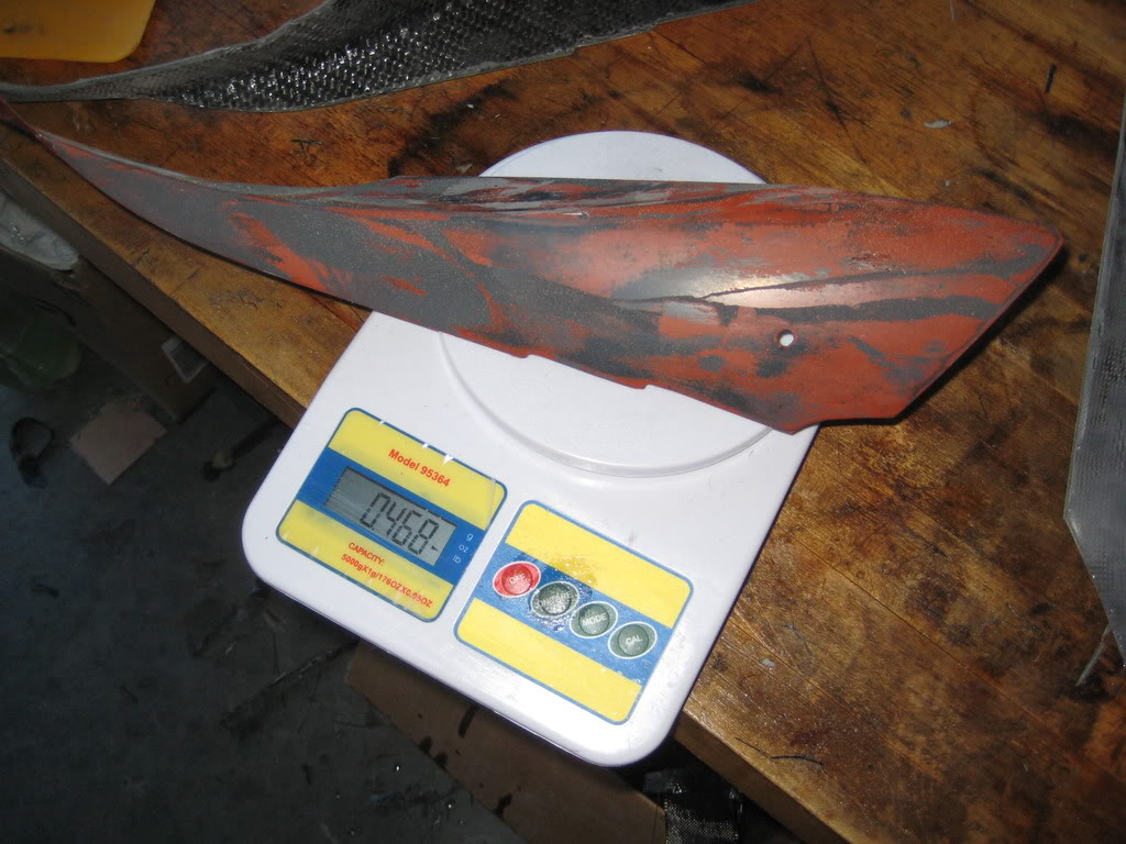

And the flimsy steel counterpart...
so... i guess you want to see it all together. (i know i did)
Side covers need some tweaking.

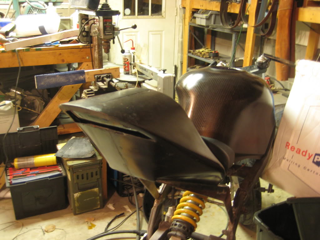

anyway... this tail will be a pilot then a back-up. I will fit it to the subframe, weld on the mounting tabs, and then transfer the final shape back to the mold, so i will have a clean part what is ready to bolt on. I have also learned alot of things that i can apply to the final tail. And i will still have a back-up should something happen to final part. (plus i will still have the molds)

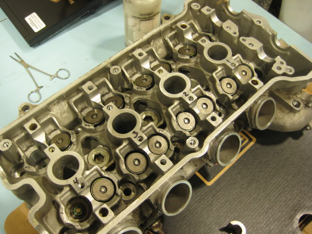

Okay to jump right in.

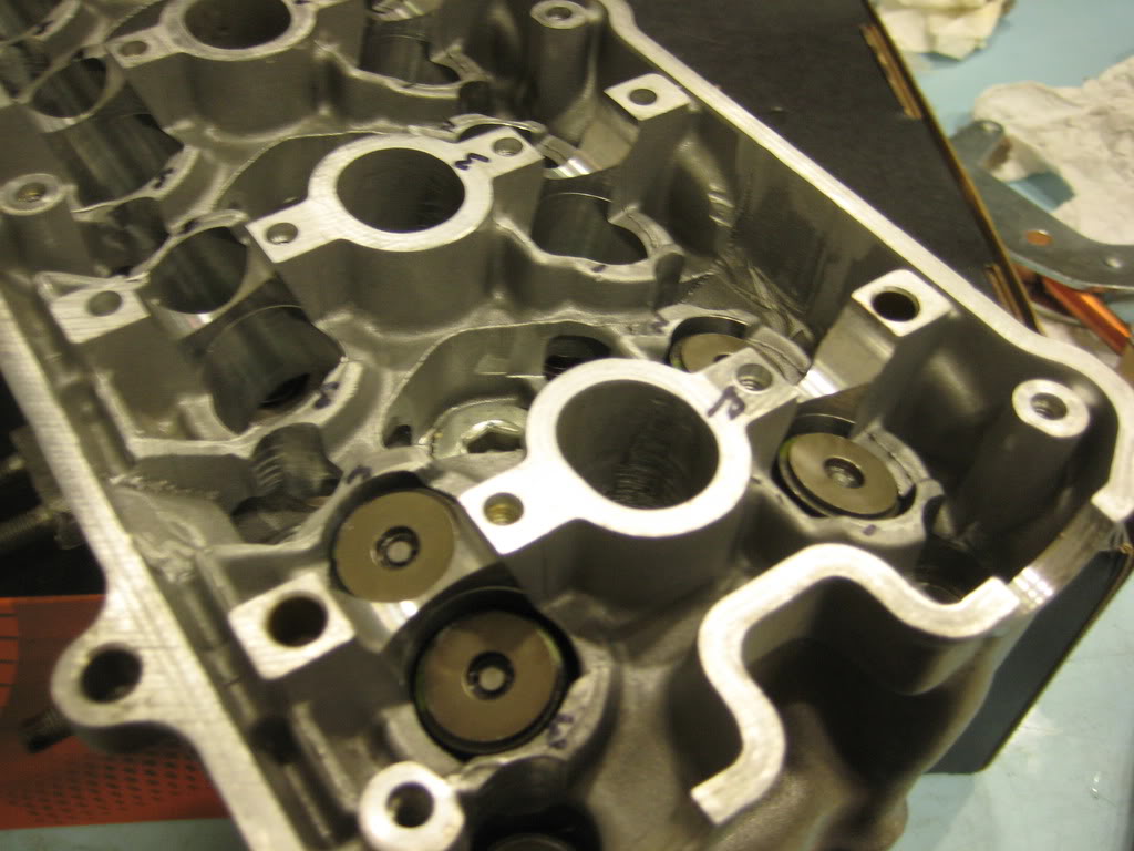

here is the head with the valves in (i took two out before realizing i needed this picture)

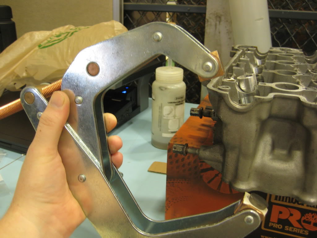

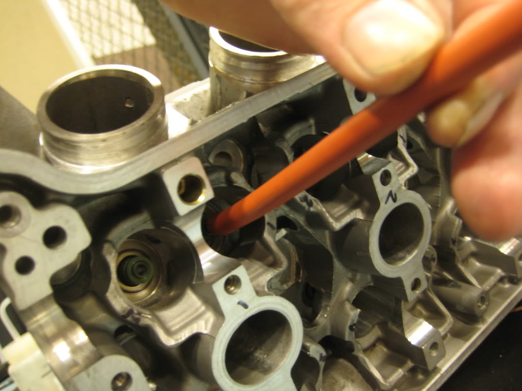

Then i rigged up my handy dandy very expensive special tooling

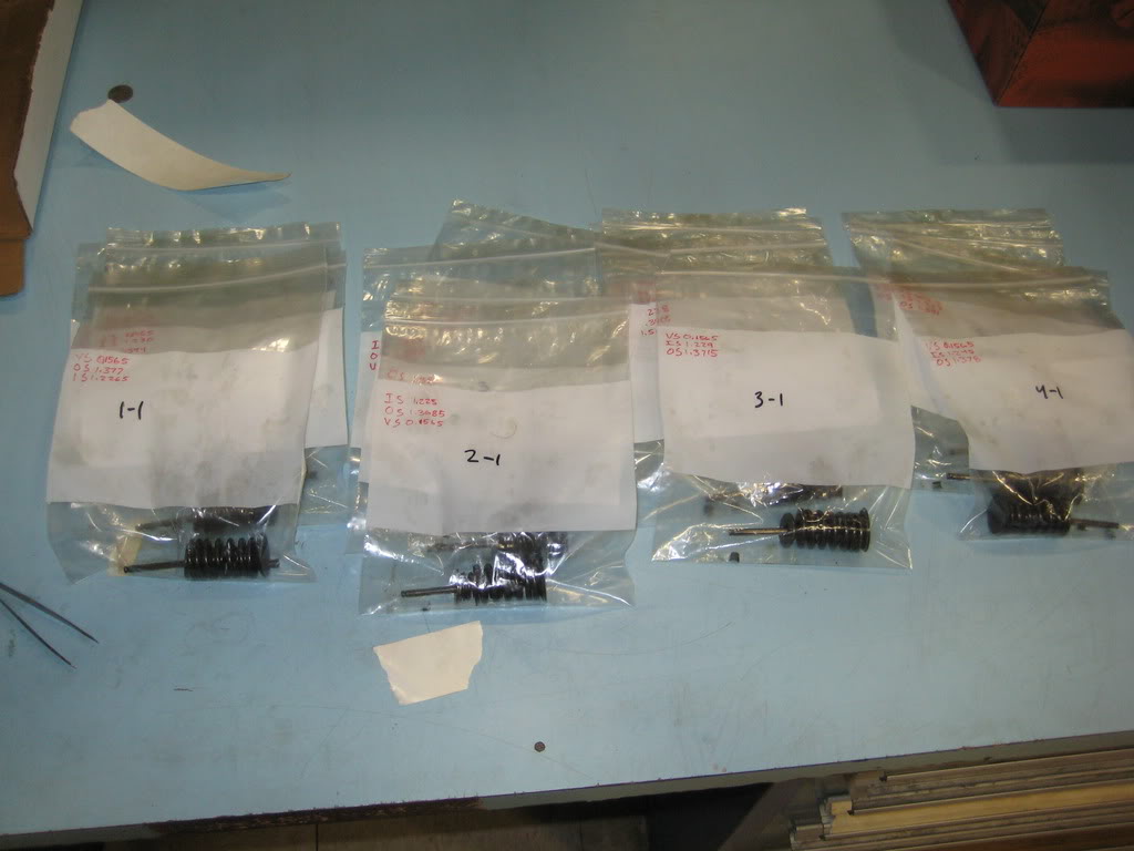

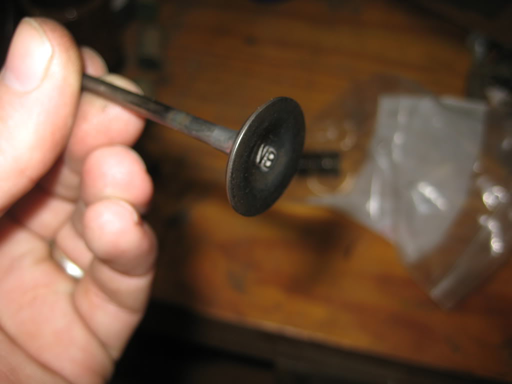

the clamp has a round piece of soft metal on the bottom to contact the face of the valve, and then uses the piece of pipe to compress the spring retainer but not the followers so i can use a pair of tweezers and get them out, freeing the valve.
As you remove the valves, make sure you keep them not only separate but labeled so that you can put them back in the correct spot. I used bags. it also allowed me to record the valves stem diameter as well as the inner and outer spring free length to see if they were in tolerance.
Then i cleaned up the valves (making sure to keep them in separate)
before:
after about 1 min on the wire wheel:

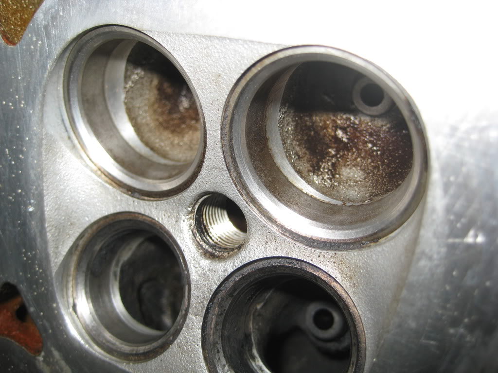

I did finish the valve job, and have some pictures.

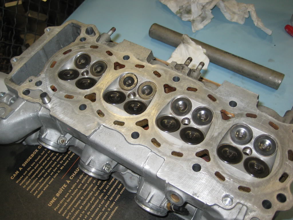

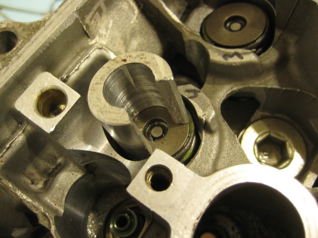

these are the surfaces that the valves seal against, and what will be lapped mostly.

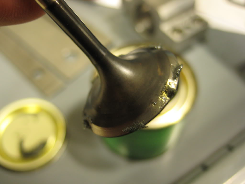

So you use some coarse lapping compound and apply it to the valve like so:
and, being very careful to not get any compound on the valve step, install the valve in the head. I used a peice of rubber hose to rotate the valve while pulling it against the face.

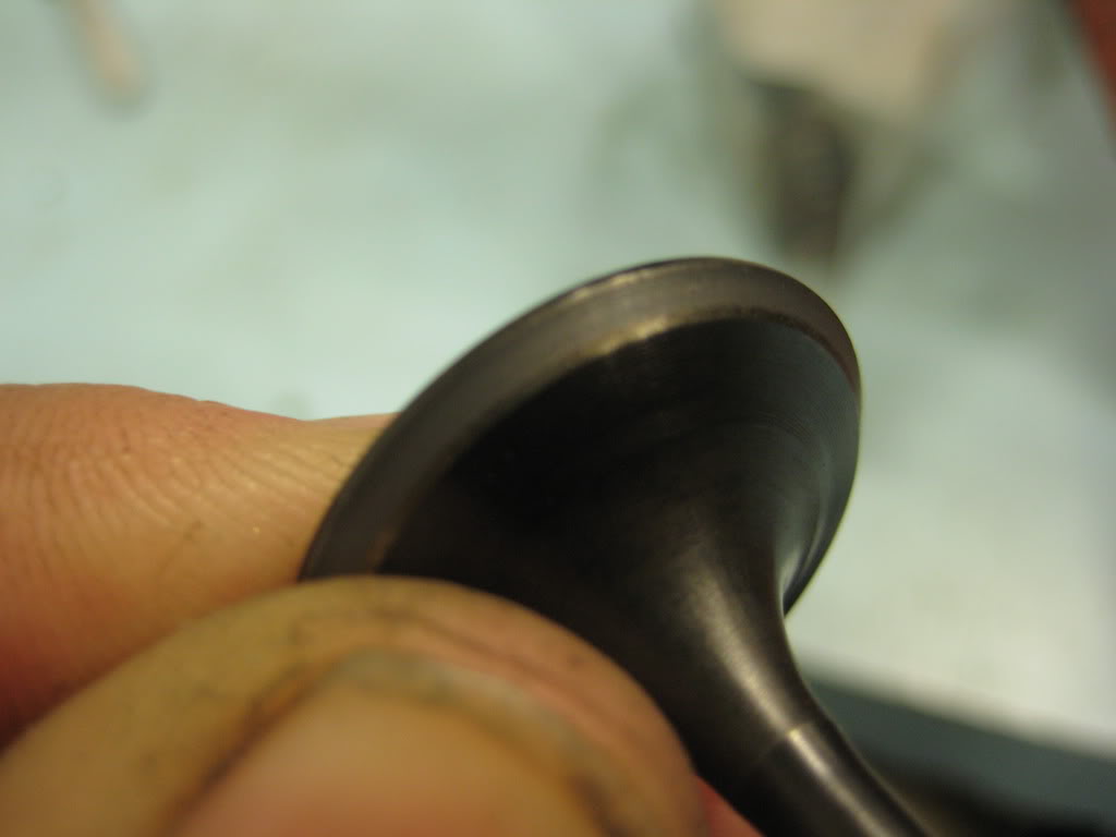

this is a valve that had been lapped.
installing them back in...
all cleaned up and put back together. i cleaned out the ports as well.. just wasnt able to get a good picture.

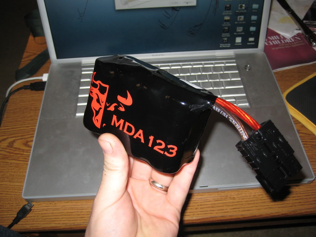

I got a new power source

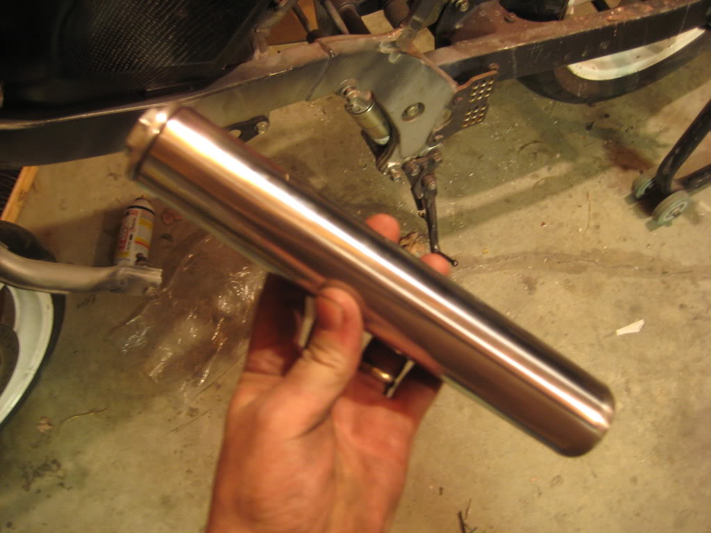

started a radiator overflow reservoir out of a past bike... I snapped this off on a gaurdrail. sheared clean at the lower triple, and it has been floating around. it means i dont have to cut threads for a cap.

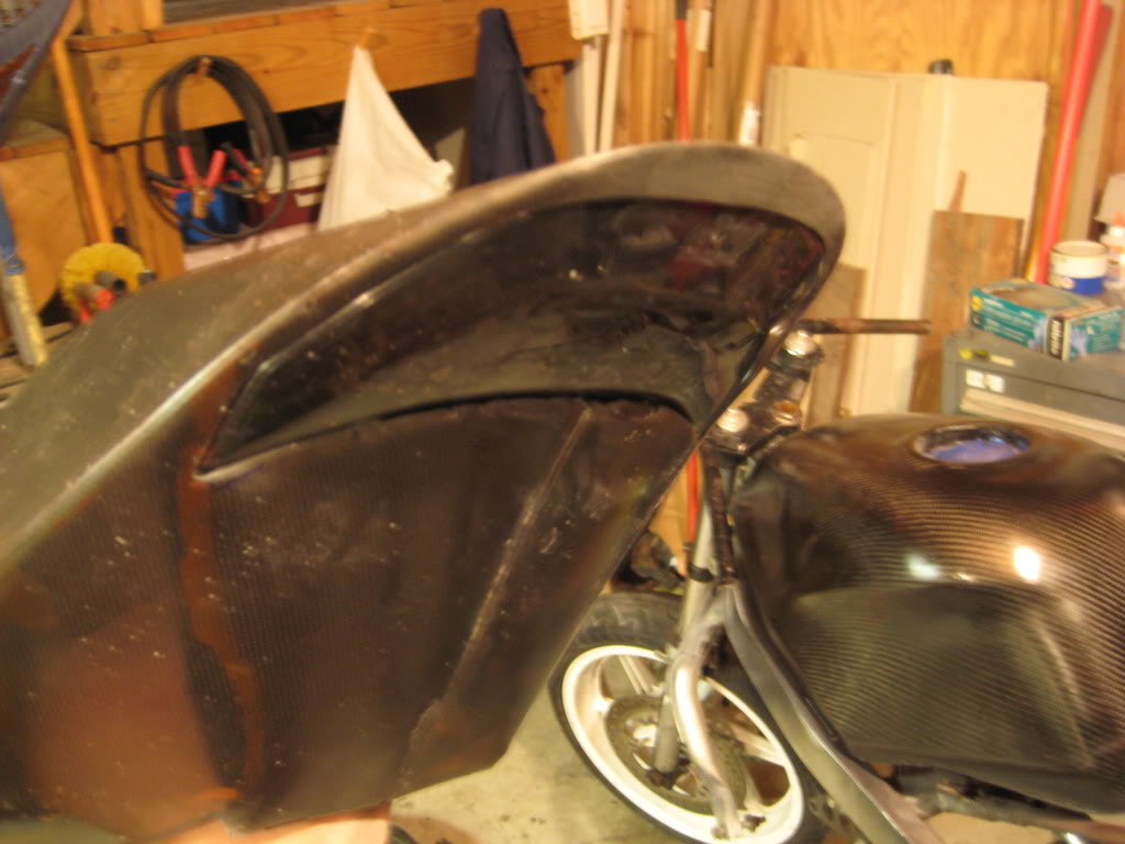

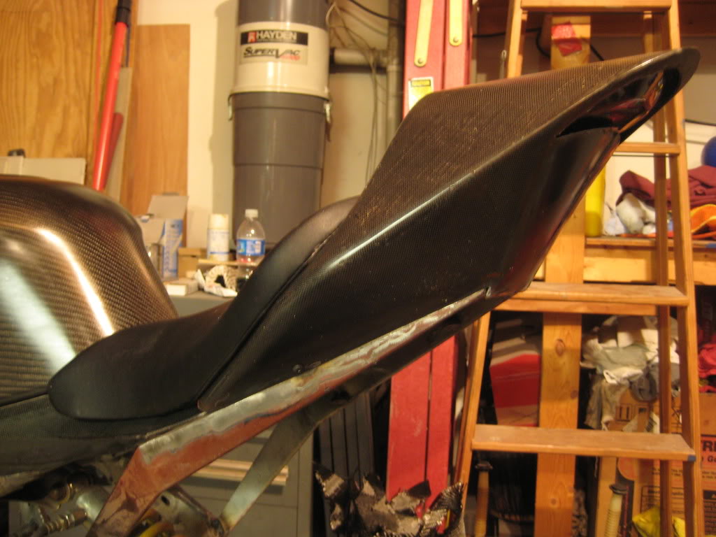

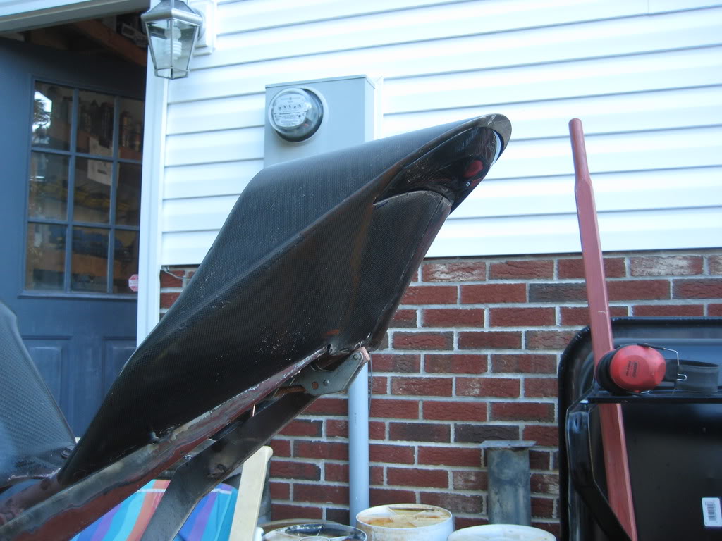

I also got the tail trimmed and fitted. unfortunately the placement of the tail-light changed a little bit, so i have to figure out how to re-weld the bracket inside while completely blind.
I cant decide, i can make the tail-light flush; like this:
or, i can make it protrude slightly. it kinda breaks up the flow a little bit, but also looks cool. sorry, no picture i will update with pictures tonight.

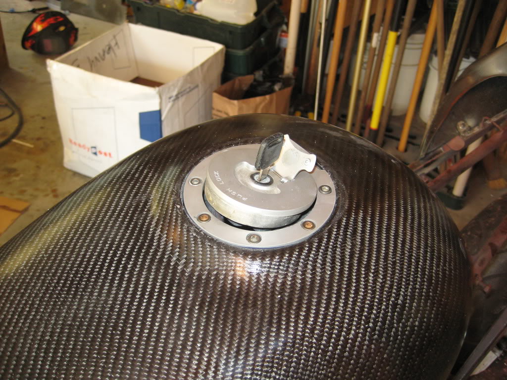

Gas-cap fitted

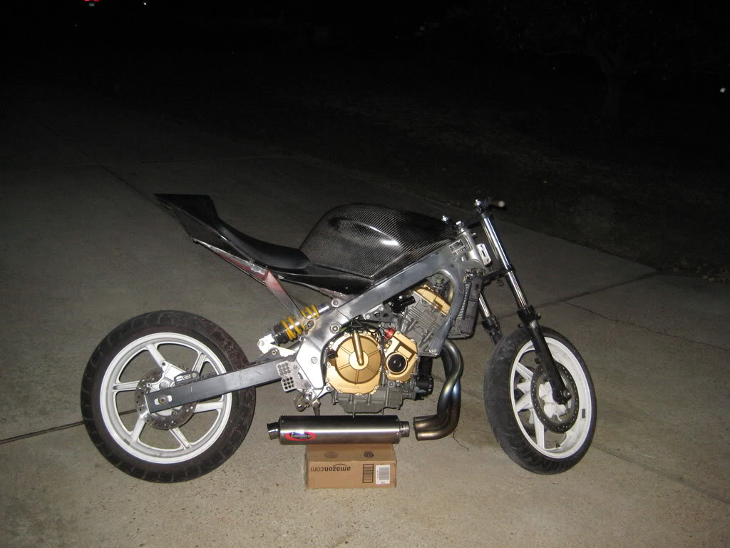

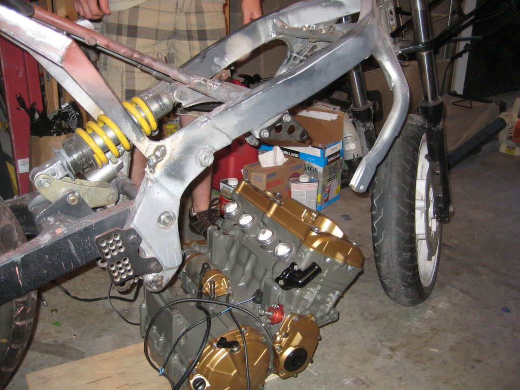

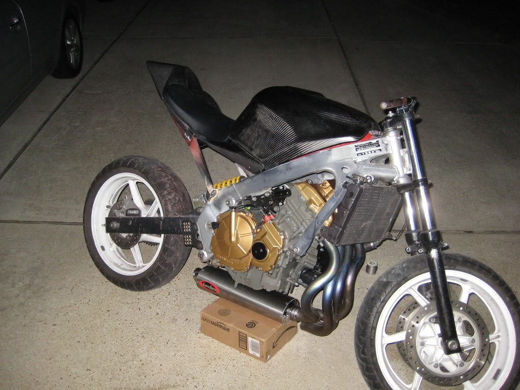

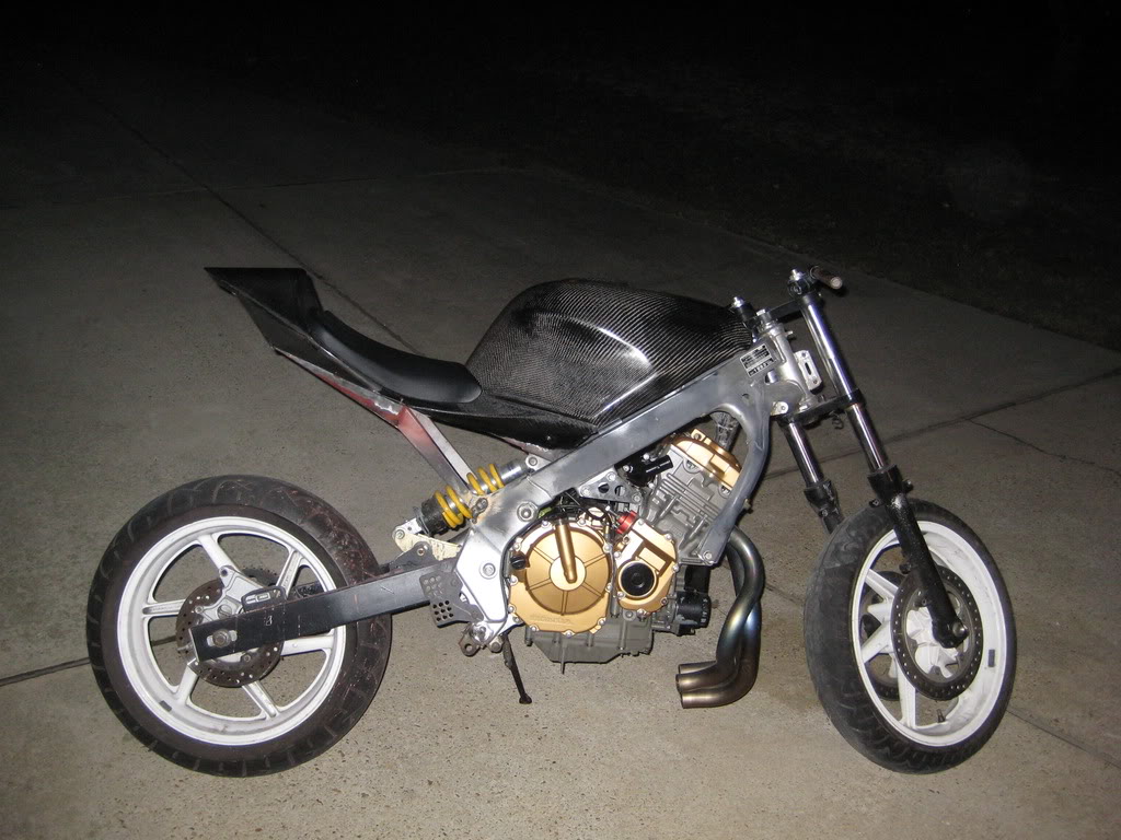

and put the engine in:

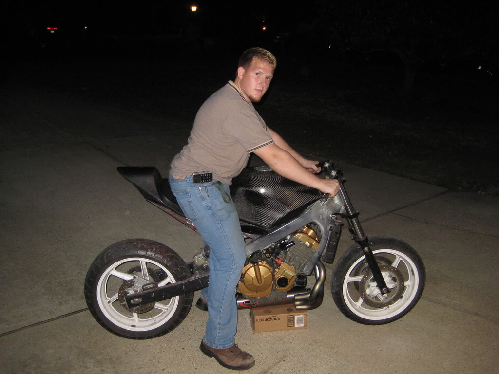

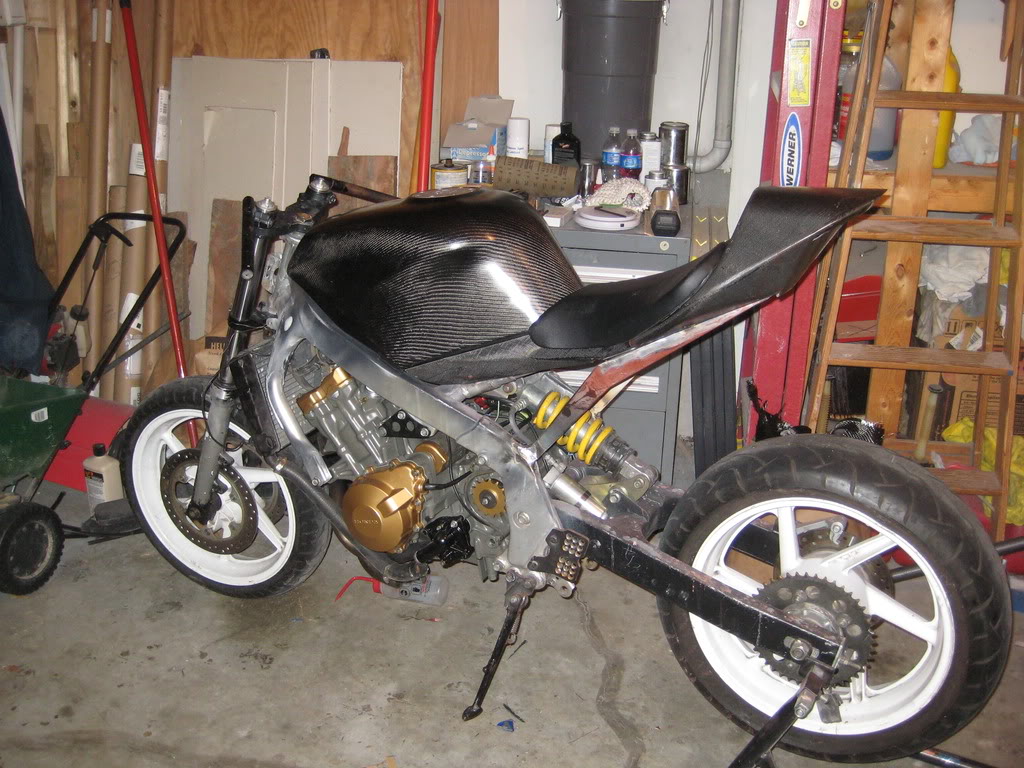

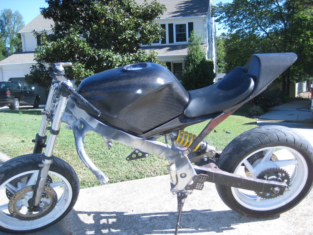

Well... it was so nice to see everything together.. that i just had to throw on all i could. that and i really wanted to see what kind of angle i am going to need to cut the Ti headers to..

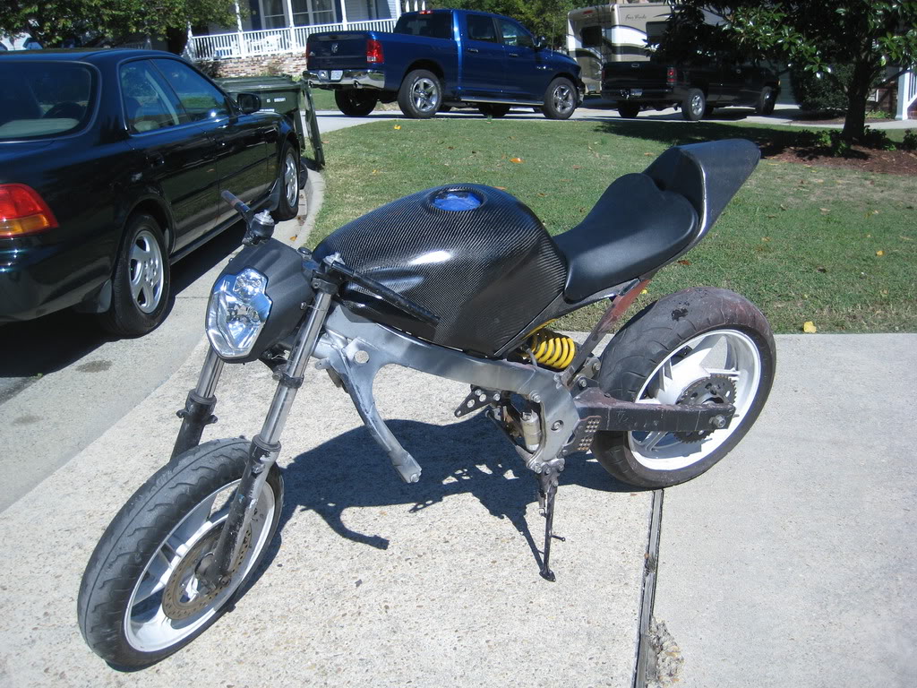

I put on my F2 radiator... as i dont know that my r6 radiator is going to work.. but the F2 radiator is pretty rusty and i dont want to contaminate the new engine. ideas?
Its a tall ride right now, but i am going to change that some with the new swinger.

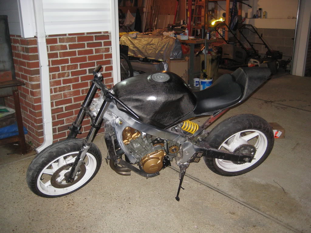

it is the first time it has actually looked like a motorcycle.. so.. a few more pics
thanks for lookin!
