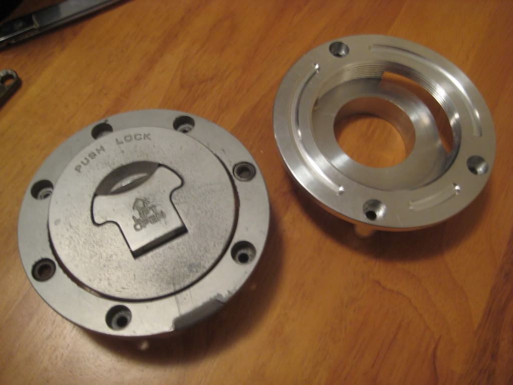

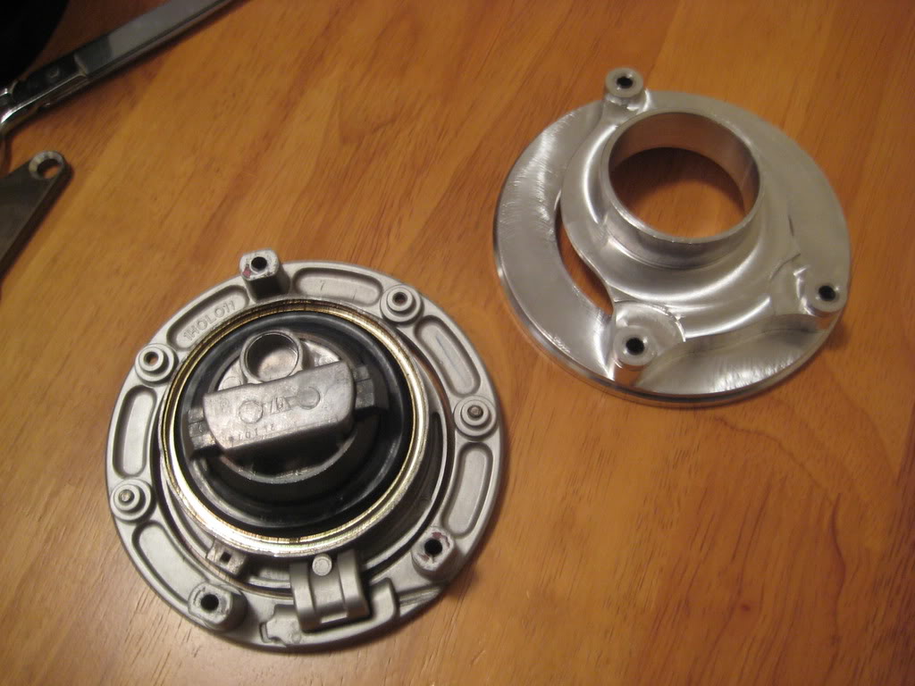

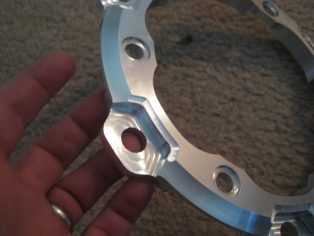

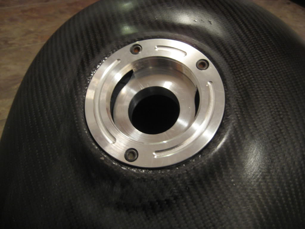

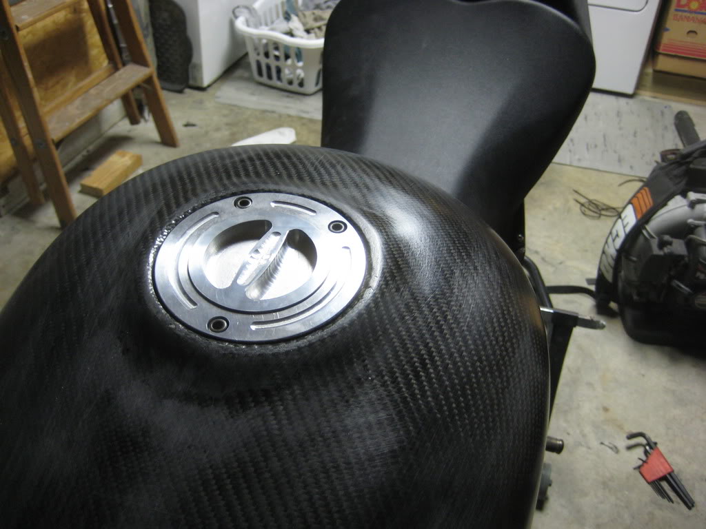

New Gas cap!
and... in the bike
and... with the lid
i am hoping to have more time to work on the bike soon

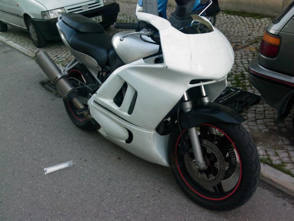

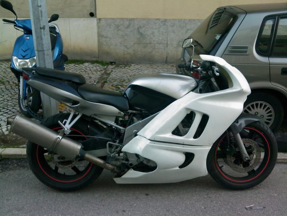

Chris, that's one fine build brother! Props to you.
I'm sure going to ask you a few questions (if that's ok ) when my brothers F2 arrives at my garage cuz she's in a bad shape and there's alot of modifications the previous owner did, so if anything is needed I'm going to call you out. I think he wants to follow the same route as you.
She's one ugly F2/gixxer hybrid, but she'll see the glory!

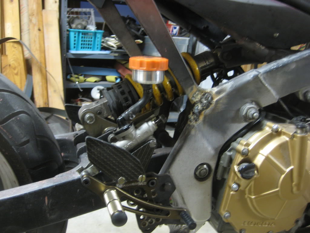

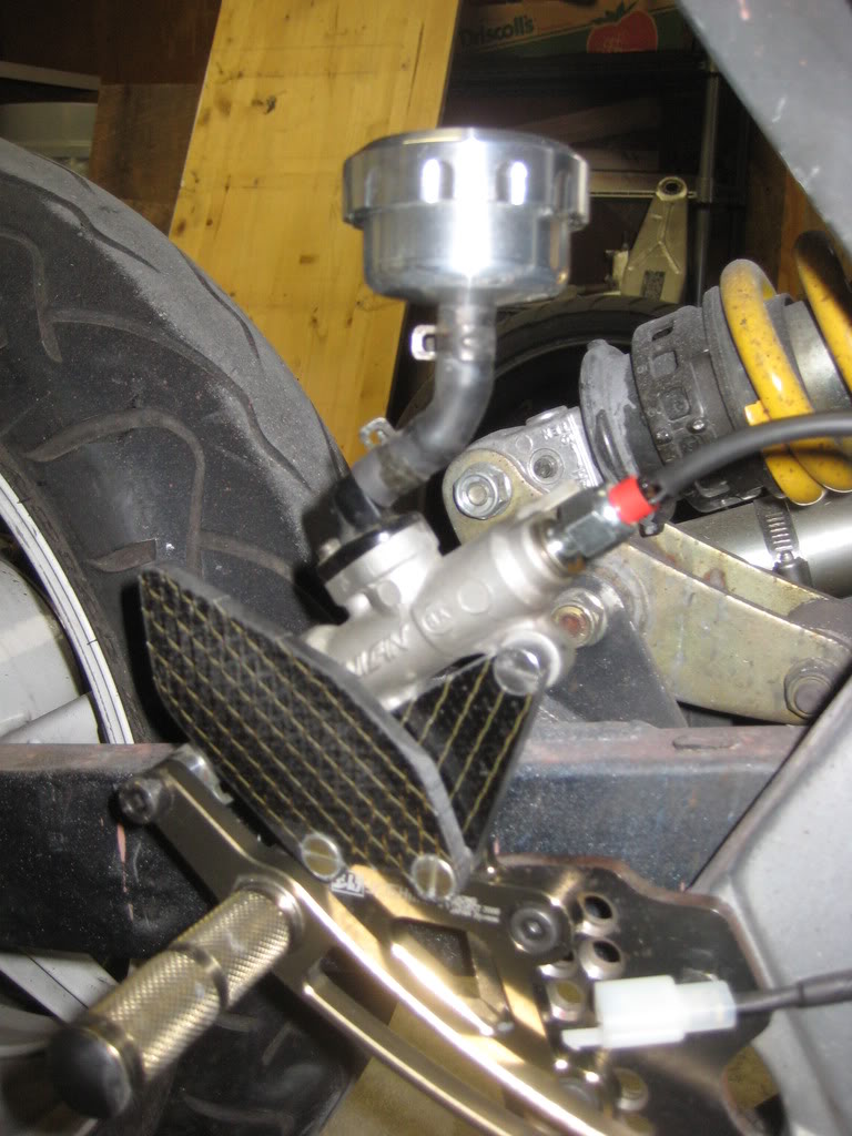

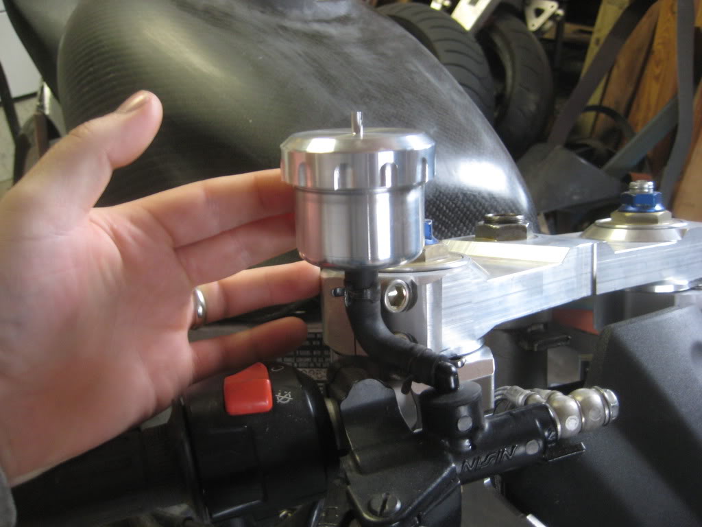

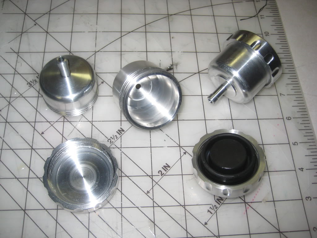

I also needed some new brake fluid reservoirs, so i used the stock dimensions (beefed it up a little..) so i could keep the stock diaphrams. here it is before i finished the cap..
i made the front reservoir a little larger since i not only have an upgraded master cylinder i am also running bigger calipers.
I have an extra one... you could use your 600 or 900 diaphragm, or buy one (new they are $10 and used they are about $5 for the whole reservoir) if anyone is interested.
I also got a woodcraft inline brake switch so i didnt have to modify the rear sets any more. it is pretty trick, and only $20 shipped.

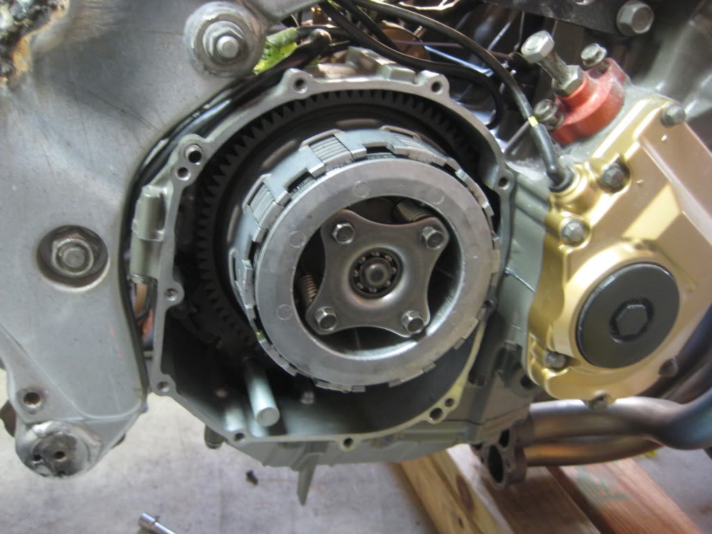

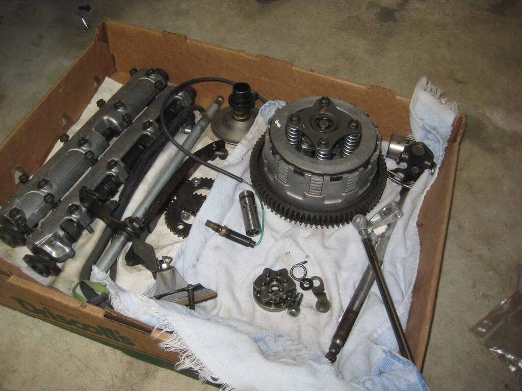

Now.. i still havent put the shifter or clutch in, so, i guess i should do that.

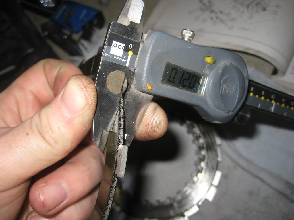

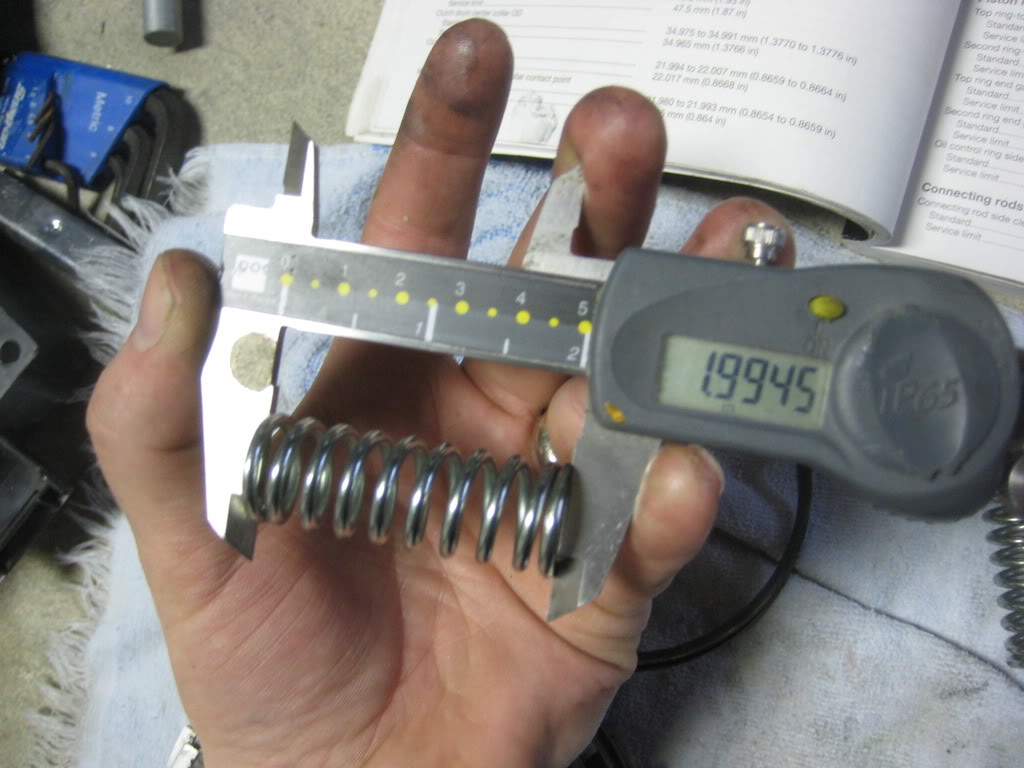

So first thing i did was check to make sure everything was still within spec.
Friction plates: almost no wear at all. (i think it was replaced)
Spring free length

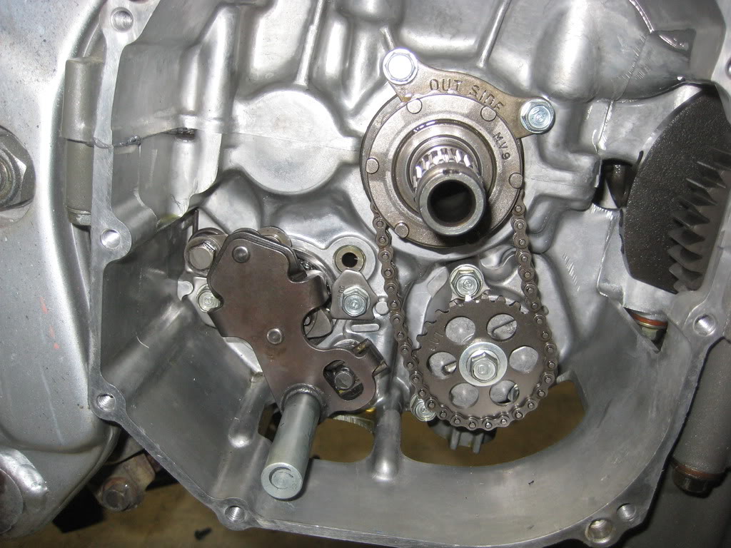

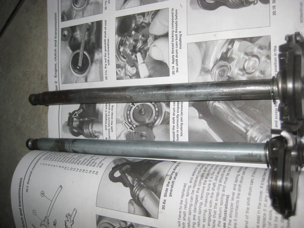

and some other visual inspection. Part of that was replacing my bent and damaged shifter shaft. got a mint condition on for $7 (not bad considering Honda wanted $90)
Shifter installed, and all gears engage. very exciting clicking through all the gears. glad to see i put the transmission in correctly.

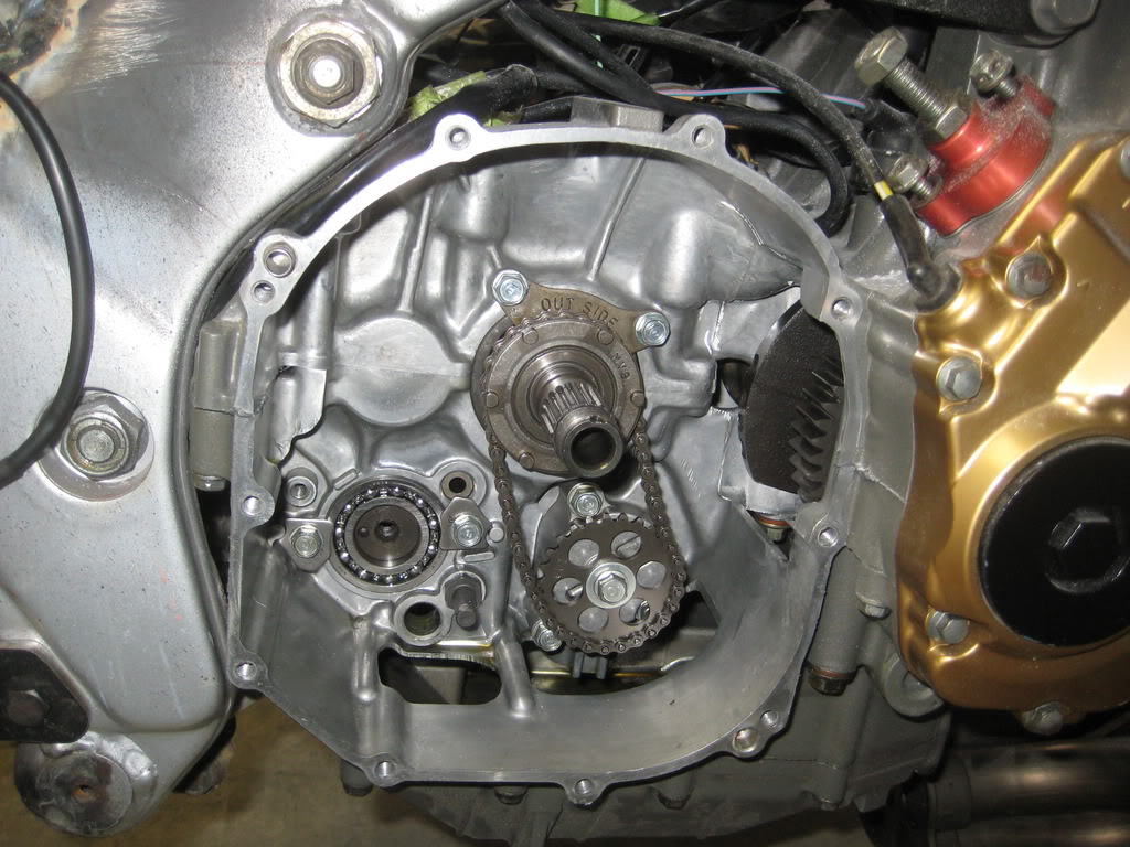

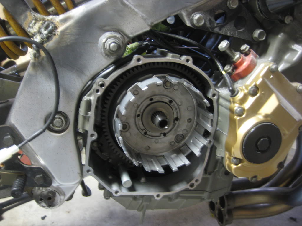

Got the clutch basket in

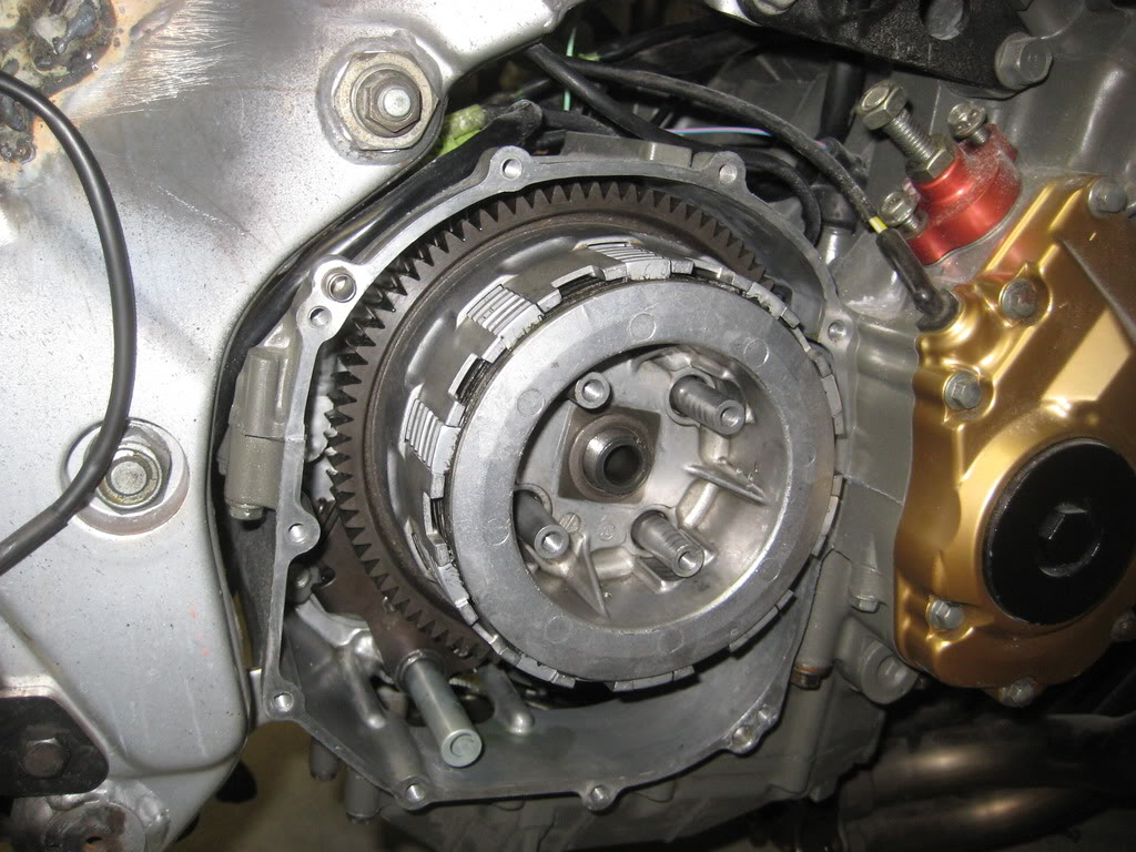

and all the plates
then i had to stop because we had a dinner date, and because i need a strap wrench to tighten the nut holding the clutch in.
more soon!
~Chris

I finished the clutch. and just have to wire wheel the bolts before torquing them down

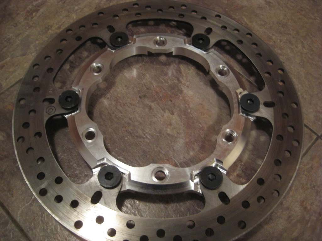

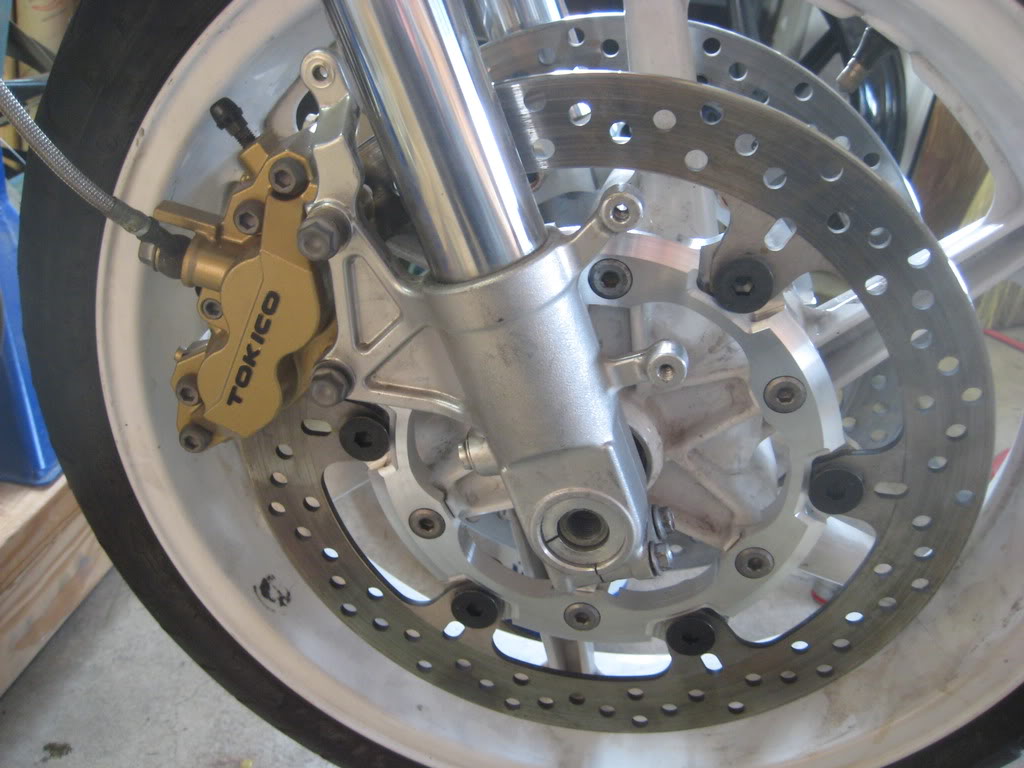

and now... what i have been keeping secret...
billet Rotor adapters to go from a f2 wheel to 08 Ducati Multistrada 320mm rotors
they still need a little work, with some chamfering and getting the offset right for the calipers, but they will work.

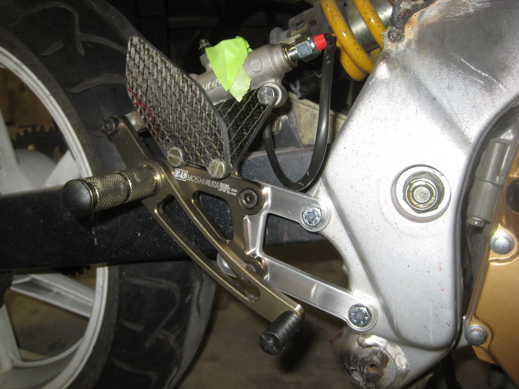

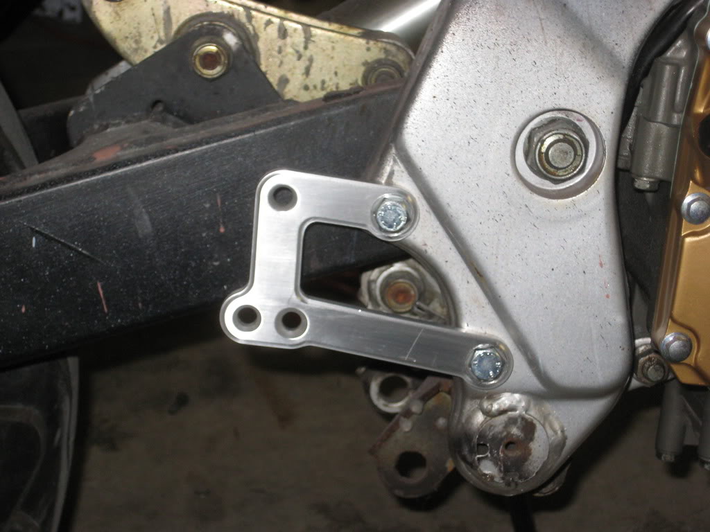

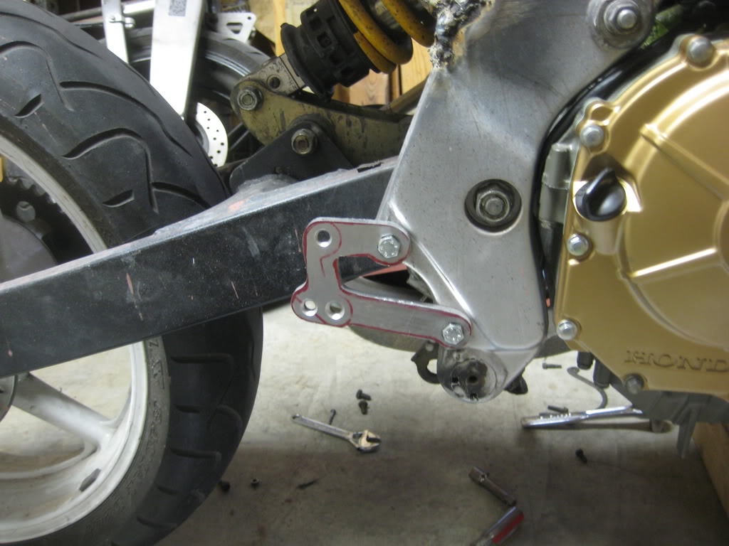

So... i decided that they steel riser plates had to go. for a couple reasons. first off, they didnt allow me the angle i needed for the rearsets (bad engineering on my part) and they just didnt got with the look of the bike.
so.. i made a prototype..
the two holes on the bottom allow me as much adjust ability as i need. So... i made the real one. came out real pretty. i also realize4d i always take pictures of the brake... it is easier i guess.. but i will get some of the shifter too.

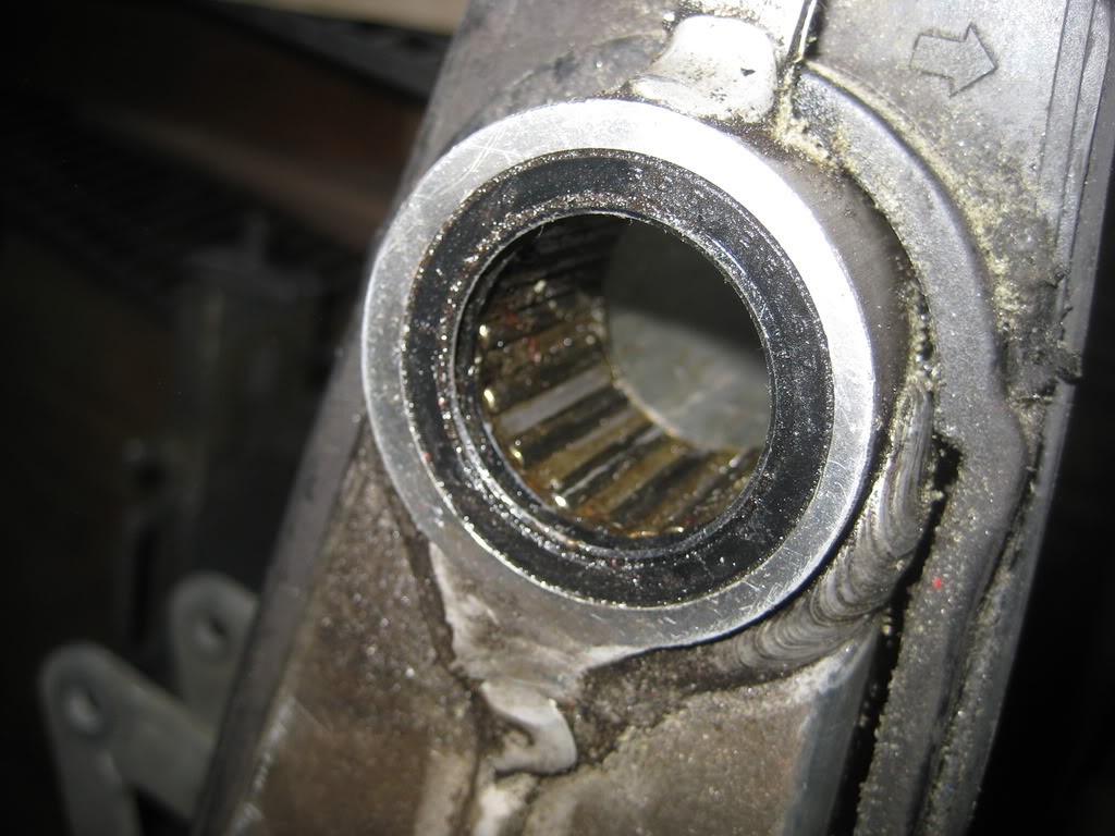

now... as i love completly changing tracks mid project.. i have decided it is time to address the swinger. so i pulled all the normal bearings out.. but am having trouble with the needle bearing. any tips?
i did figure out a way to cut it down to the exact size of the stock swinger and keep it centered... so i thought i would use this down time to do something about it.
gratuitous needle bearing pic
thanks yall!
