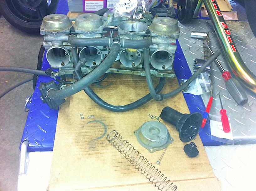

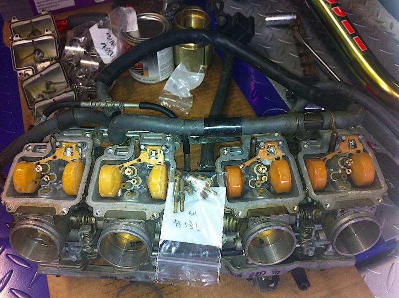

You and me both TBT
It's exactly what I have been doing too
same here with 2 new shims per needle
and cleaned carbon off the slides with
CRC MAF cleaner
I should mention these are Mark 2 Carbs
for a 1990
Pics coming up
Putting the shims in and cleaning carbon off the slides with MAF cleaner
New jets & pilots in - old brass in the bag
