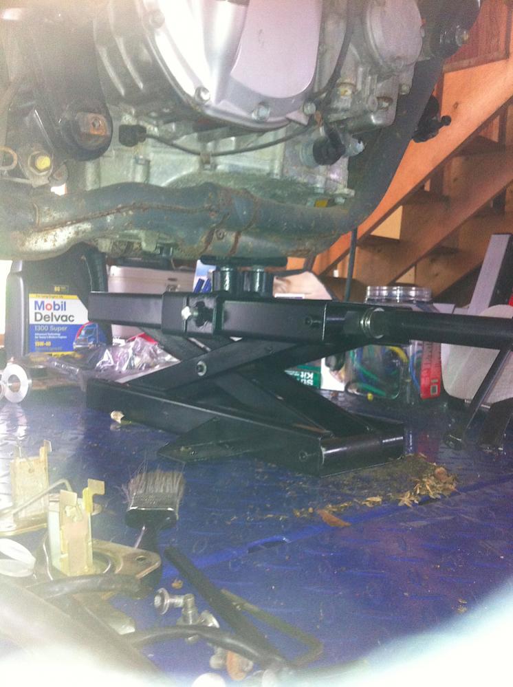

So - new jack pic coming up - $69 shipped ebay - summit racing
(hah all of a sudden I see 5 more have sold just today - says it all right there -lol)
Been threatening to get one for ages, but flat jack K&L etc were all 200
The Hand of God strap stays - because - you just never know !

Sprock is that a jack on a bike lift ? If so was just wondering why the jack on the lift ? Cheers.
forks were off ! Geoff, does not balance well on one wheel

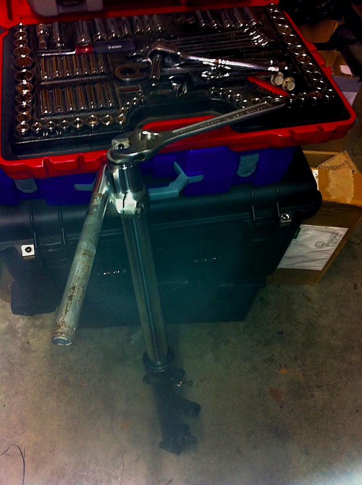

Installed Tires - Sprockets & Chain - 1987 Hurricane today 5/24/12
Oh yeah and reading back up a few threads - Hawk was looking
for the easy way to reinstall fork springs and cap's etc. - my way
Attach a spare handle bar to grip it and stop the tube from turning !
Adjustable wrench a great way to control downward pressure
while screwing the cap in - have to be careful there not to cross
thread the cap !
Not bad for my first ever seal job eh ?(well 1000F seal job that is) - See anyone could do this really !
