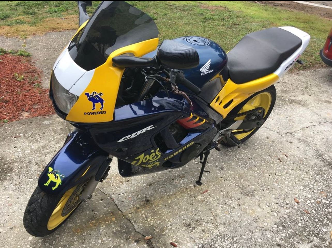

Hey y’all, just picked up this project 95’ 600F3 for a steal.
now I may know why
First off, 15 years of motorcycle building in my blood. I’m not scared of anything on these things but wiring isn’t my forte.
I went to crank the ride for the first time and it cranks, but it just keeps cranking. Kickstand safety, kill switch, even turning off the ignition didn’t get it to stop cranking. Just kept going non stop until I disconnected the battery.
obviously the harness has been f’ed with. I’m going to start tearing down the harness tomorrow but has anyone run into this? I’ve never had a bike continue to crank even after the starter has been released and the kill switches/ignition turned off. Doesn’t make sense.
