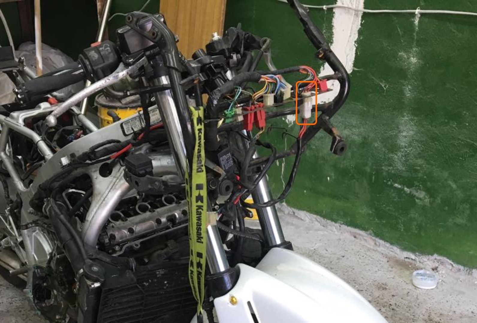

So I have had a very dodgy fitted hawk alarm removed from my bike, however afterwards the guy has left it is apparent the ignition switch is not plugged in (it's a long story...)
I cannot for the life of me find where to plug the thing in!
It has a 3 pin push connect block on the end of it... but nowhere for it to go please help

Ignition wires run along the left side of the steering head.
Then do a 180 and follow the main harness under the fairing up behind the headlight.
It's the white plug on the left side of the fairing stay connector holes.
