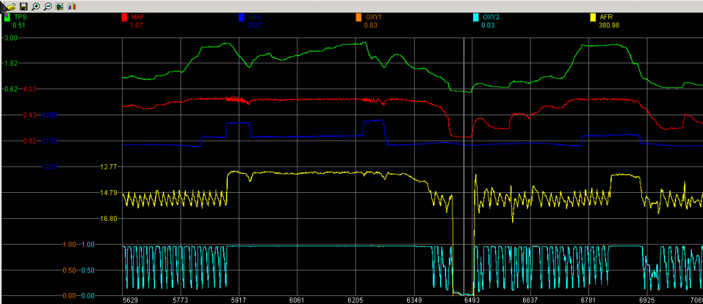

Exact data-cells to adjust and amount will depend on actual readings you get. Easiest DIY method is with datalogging wideband-O2. Then you just do couple of runs and record data on road. Then download data when back home, draw pretty graphs and make adjustments as needed. I've used wideband-O2 from TechEdge.au and they work awesome. Completely transparent with their circuitry and how it works along with excellent instructions and customer support. Here's their current DIY kit: https://www.wbo2.com/2j/2j9.htm . Standalone wideband-O2 better (and cheaper) than DynoJet's AutoTune module because you can carry over to other bikes, even tune carbs, and re-use with aftermarket EFI systems at later time.
sample datalog graphed
time 5629-5900 normal cruising with O2-sensor feedback, I've targeted 15.5:1 AFR for better fuel-economy
5917-6394 going up hill, downshifted 2-gears and goes into open-loop mode, more power @ 13.5:1 AFR
6400-6493 going downhill, let off throttle coast, then get back on throttle. Fuel gets cut off and zero exhaust to analyse. It thinks AFR is 380.98:1 due to all air no fuel. This is where stumble/surge occurs
