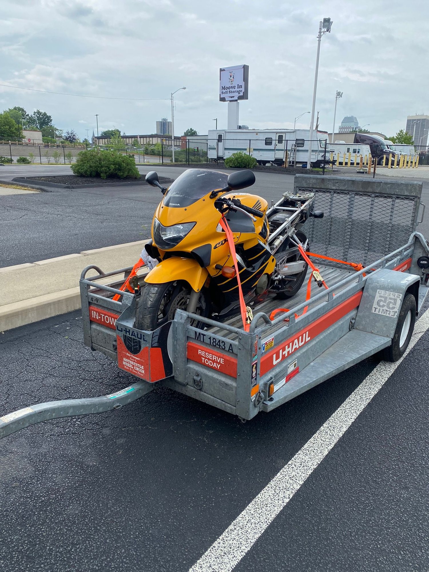

So I re-synced the carbs, now using #3 as the baseline and it was much easier. Bike was running great. After replacing the stator I had equal volts across the 3 leads as opposed to almost 2 volts difference with the old one. Replaced rectifier again and went over the carbs once more for good luck. We’ll I’m an idiot and put the 140 jet on #1 instead of #2. Rode the bike to work and it was a blast. I ended up selling the bike and made a nice profit. So I used the profit and bought a 2000 600 F4 that ran last year and is a no start. On to the next project!! Just removed seat and rear fairing due to missing screws. Thanks for the help again guys! You’ll probably see me in the F4 section next 😅
