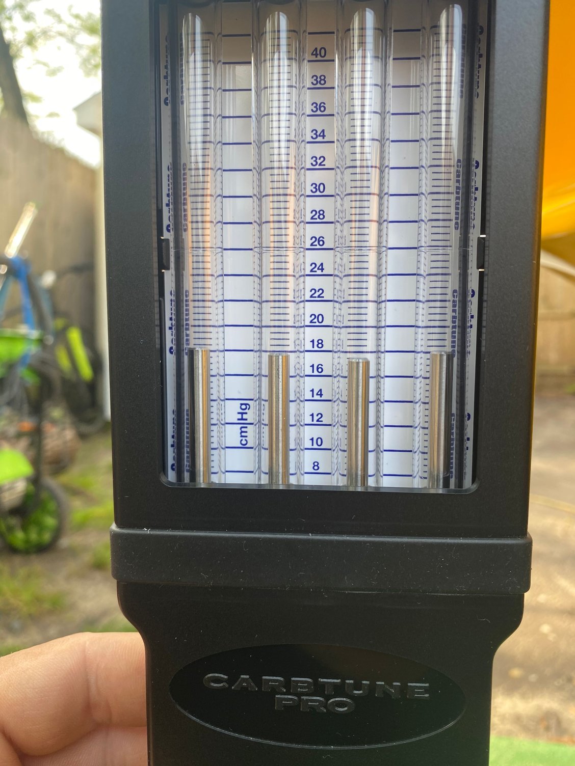

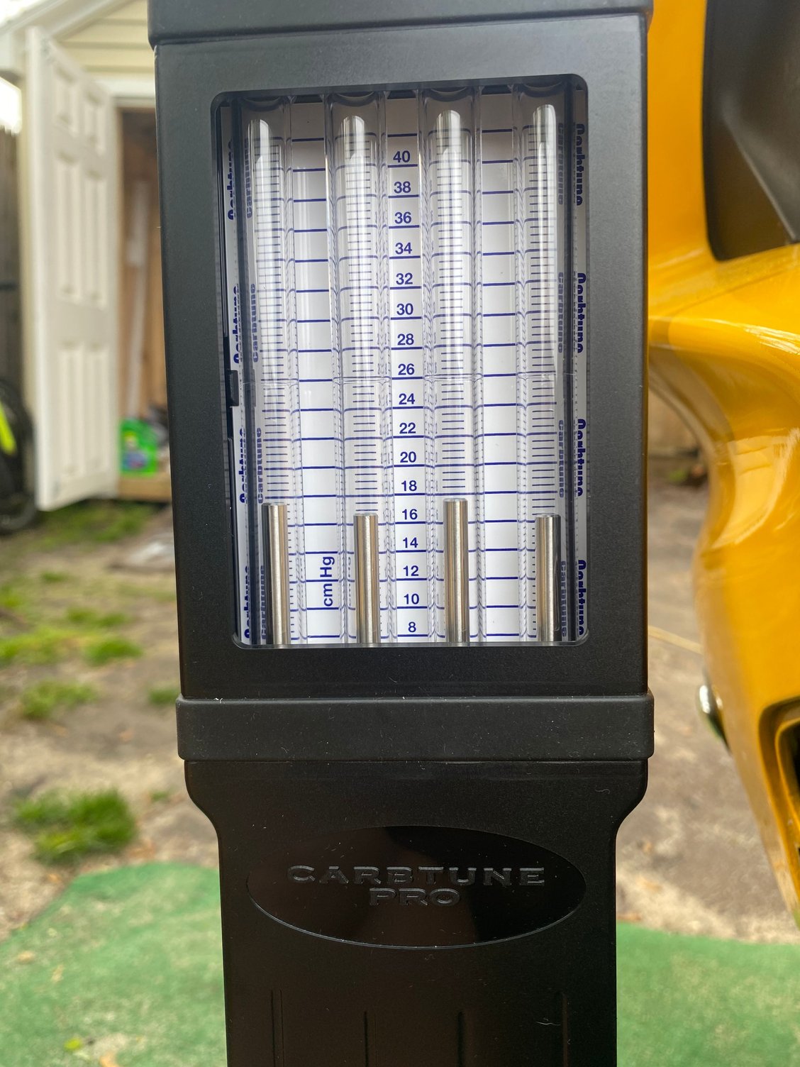

This is how it is now. Went 2 turns out on each and it doesn’t sound as broken up as it was and full open seems better, still waiting on carb sync tool.

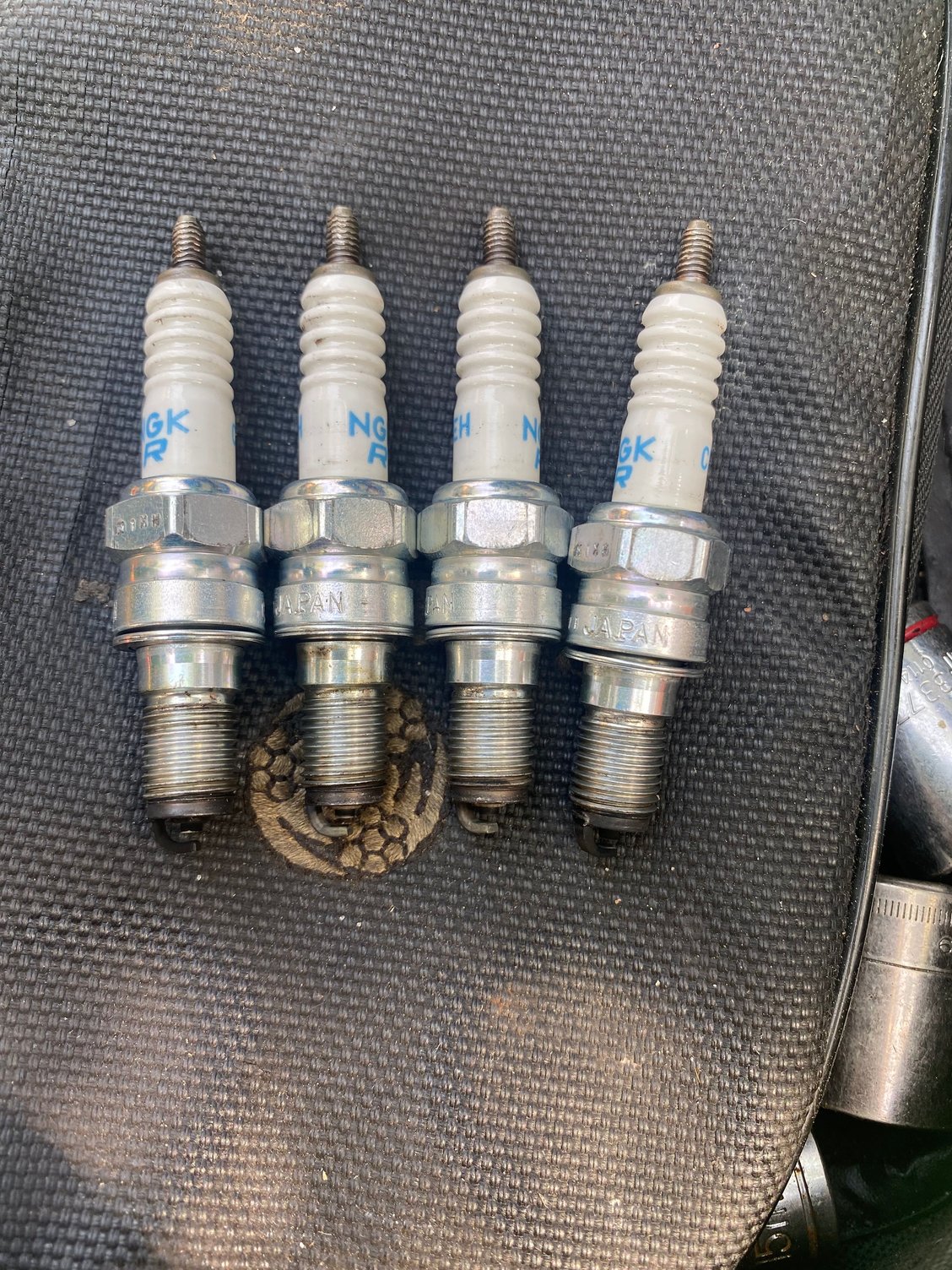

1 and 4 on the outside. 2 and 3 actually didn’t look bad at all. This is after spending about 15 mins to do the sync, cleaned and put back.
1st picture is before the sync, really not that bad! But man idk why it sounds so broken up, gonna go for a ride now after the battery’s done charging and see if the sync and cleaning plugs helped.

I actually tested each once on each number on the sync tool and they were all dead nuts on. Even though it was pricey I’m happy with the Morgan carb tune pro!
