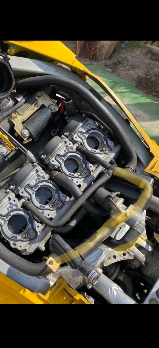

So when you say you did the Evap delete, what exactly did you do? What did you block off and how did you route things?

So the yellow line represents the new tube which eliminated everything else that was connected. And for the right side, that actually stayed the same. I had to clean and use that black filter box that’s tucked under as a tube joint. Currently at work but I can take a picture when I get home tomorrow. I’m hoping this isn’t causing any issues but I do still have all the parts, and one of the front deer whistle looking vents wasn’t even connected to the fairing so I figured wasn’t doing me good anyway!

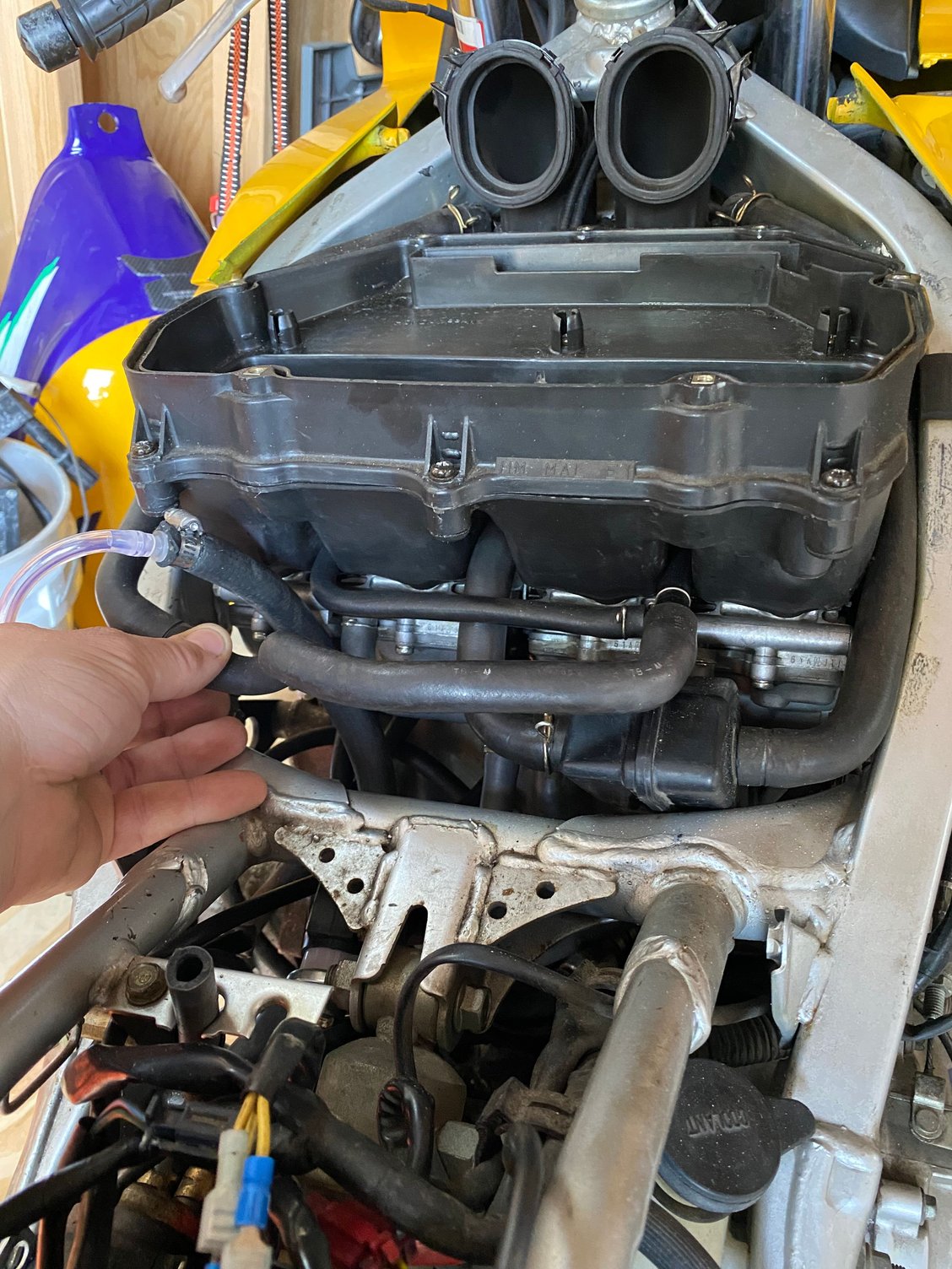

just started up today full choke cold, no problem at all! I know the tubing looks alittle funky but I didn’t want to cut anything just yet if this is screwing with the bike.
i just noticed also the fuel pump is clicking crazy fast, sounds like a lawn sprinkler 😅 it’s staying on and once I put the filter box on I have to increase the idle to keep it running under 2k rpms. When disconnecting the pump while running im getting 10vdc. Not sure if it should be clicking that fast. I’m using a small auxiliary bottle and it’s sipping the gas pretty slow
