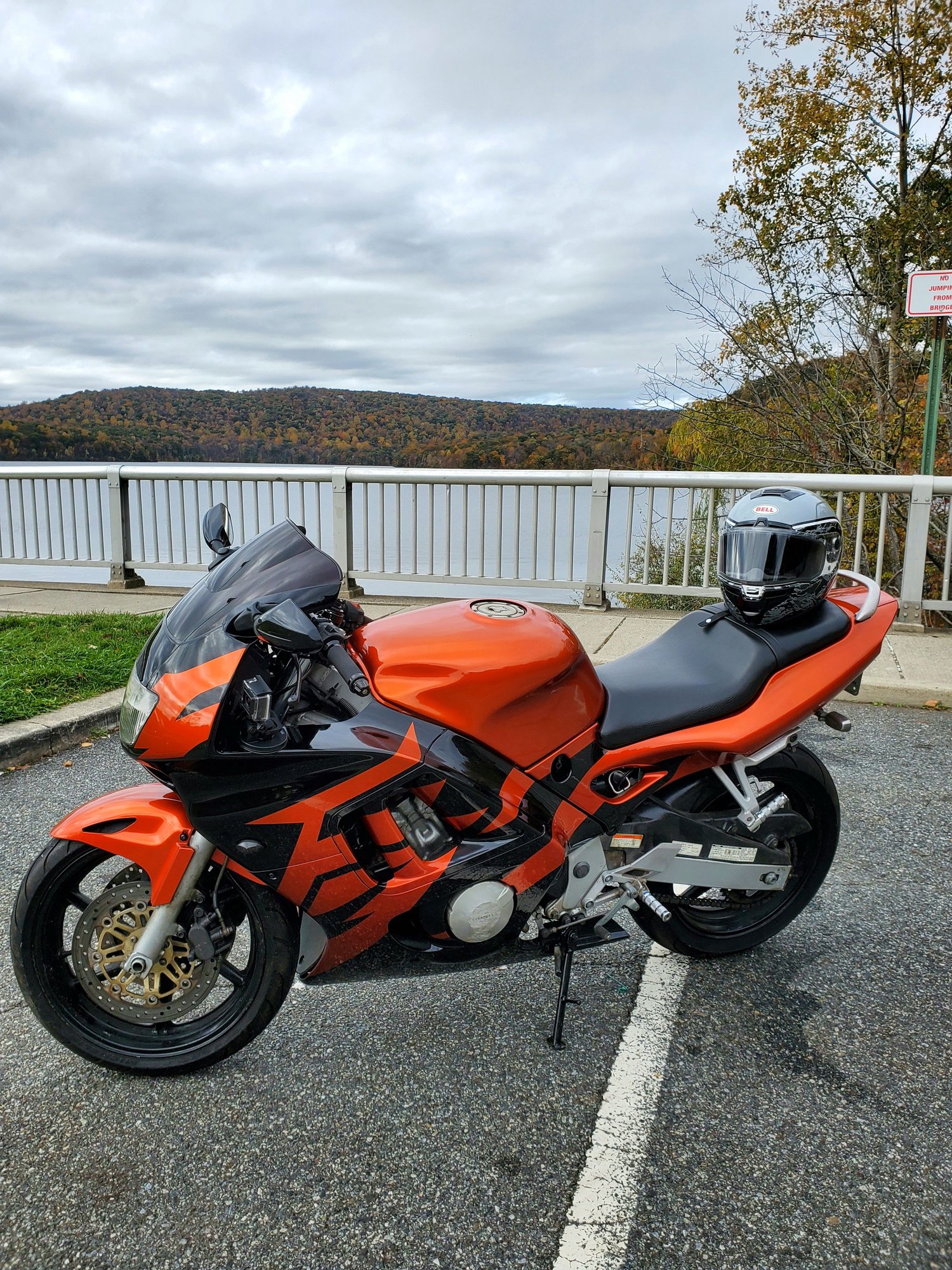

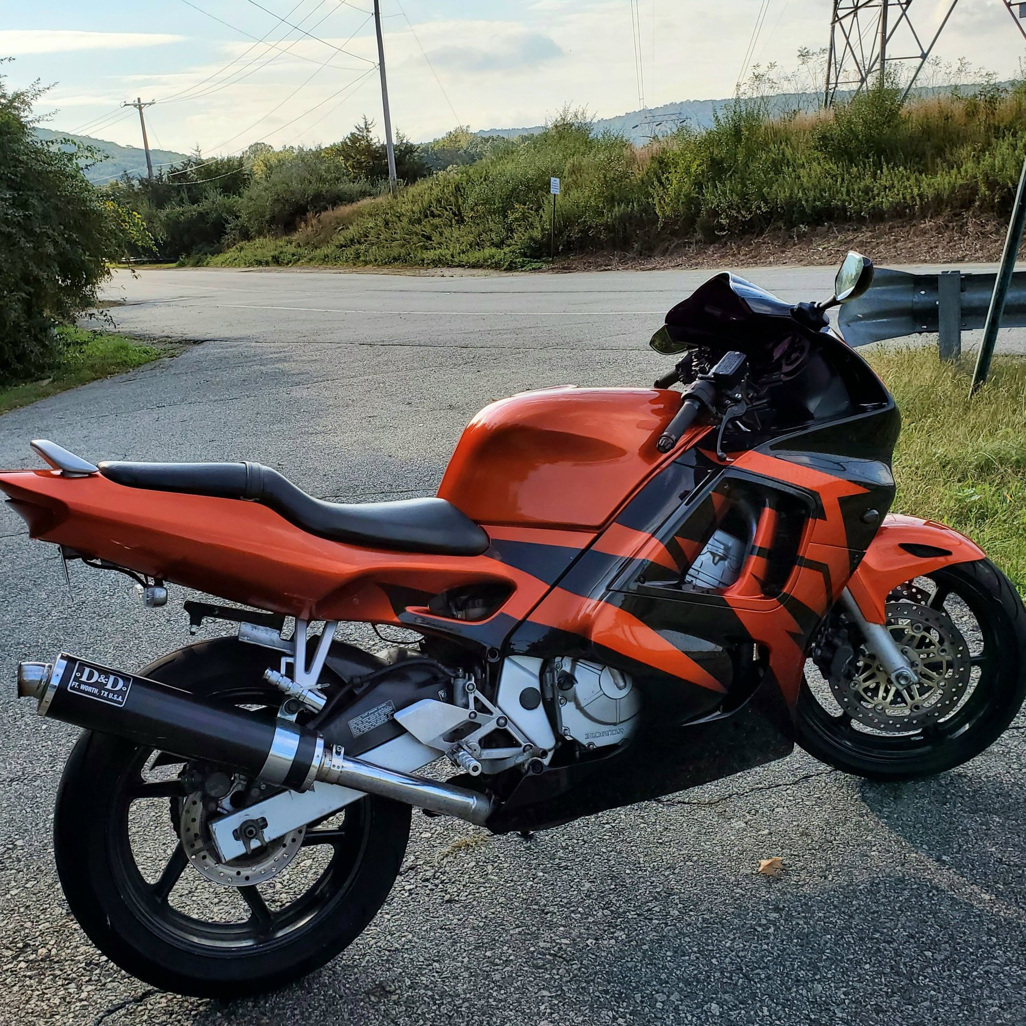

I wrote this out before but it didn't post..
I bought the bike around 2012ish, my friends had bikes and we all rode a lot. It ran great but it wasn't pretty. It had mismatched fairings and the tail section was from an F2. I found an F3 tail and rode it half naked for a while.(the bike haha)
I bought a China fairing kit on eBay already painted and it actually went together quite well, I was impressed. The fairings are thicker than OEM and I had to dremel out some holes, but overall happy with it. When I ordered I didn't realize the piece above the taillight was for the Euro models. The holes bothered me so I tracked down a handle in Sweden. After a few years my friends sold their bikes and I didn't ride as much. I'd take it out every so often but it spent a lot of time sitting. I started riding it again more often, more so last year which is when I noticed the rougher starting and running a bit rich. I also had a fork seal leaking and actually just picked them up from the shop ready to put back in. I've put tires on it, new brake pads, regular oil/fluid changes since I've owned it. It has 38k on it now.
This last pic is from this past November, right before I put it away for the winter. We were having very mild weather here in Northern NJ.
and I definitely need to get the Honda wings at the very least back on the gas tank!
