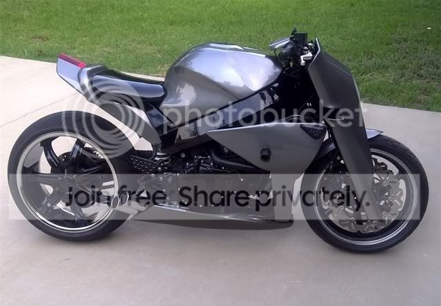

before i tore her down, she was riding, and she rode real well
that guy has some serious bodywork skills - and he's pretty damn good with a welder too.
he's got another 954 that he's working on right now, and it as well is pretty mean looking as well.
